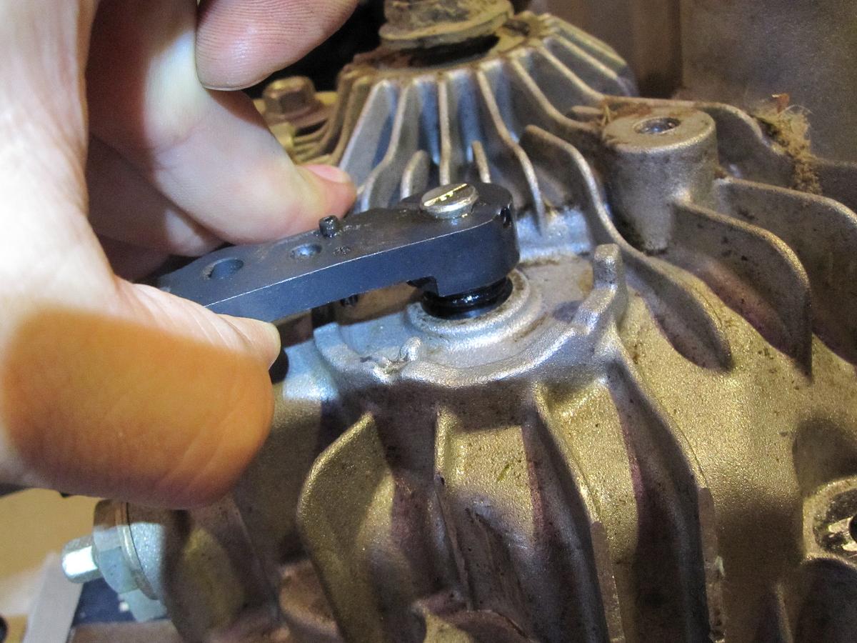

Got the K46 pulled from the mower and checked for where my leak is coming from. It is coming solely from the bypass shaft. The shaft no longer has any force pushing against it when trying to engage or disengage (rotate with no resistance). The shaft also appears to not be seated properly thus causing oil to spill out from the top and run down. I've included a picture as well as a youtube link to a video that I made. It appears the camera wasn't in focus but you'll be able to clearly see what I'm referring to. Will I need to open the case to repair this shaft, I'm assuming so.
I can push the mower but it is harder than when the bypass actually worked.

After further troubleshooting I was able to seat the shaft seals down into the case and then noticed that the 2 bolts that hold the axle to the frame in the front were missing. One had sheared off and the other was gone. I fixed this and now everything is aligned as it should be ... no jerking, the belt isn't slipping out of the pulley and no leaks ... Hopefully it stays that way.
