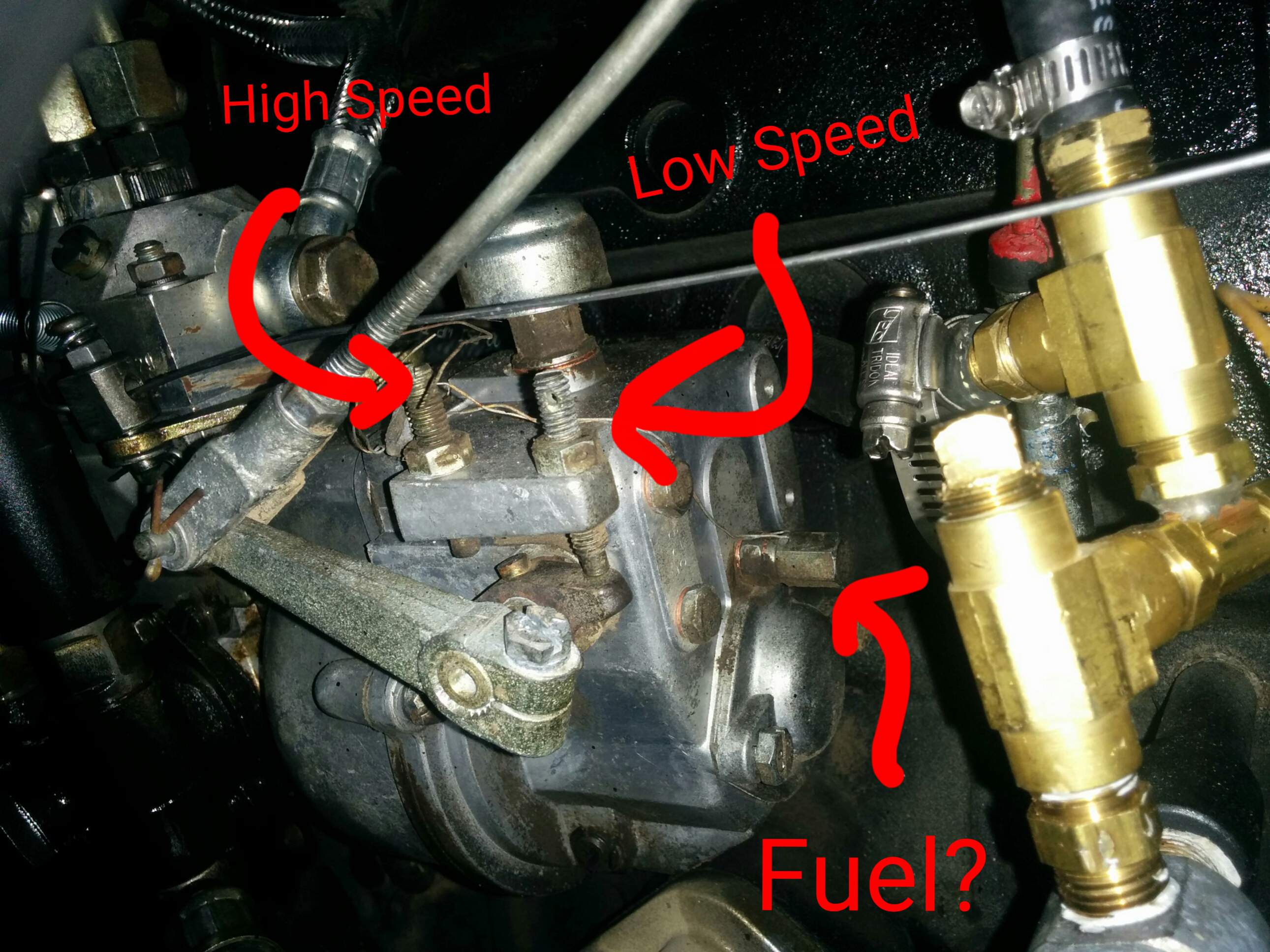

Here is a picture of the back of the injection pump. I have marked out on the picture the high and low speed adjustment for RPM and the third adjustment is on the back of the pump is fuel? The manual said there are three adjustments that are wired together so deductive reasoning would suggest that it is the max fuel screw on the back (it should increase the max travel of the rack).
That matches up with the info I have read on a few other threads; that it is the fuel screw.

When I bought my tractor I talk to a mechanic who repairs farm equipment at the farm. He said that there are simple machine but some had their fuel pump not set to achieve the engine the horse-power it should. He told me that it is mostly true for the FT404 ( tractor won't hold speed in 8th gear ) and the dealer near by (close now ) ask him to put the tractor they sell on his dynamometer.
So, one morning I go to his home and he put my tractor on his dynamometer. At that time the engine show around 22HP at the PTO that is not too bad for a 25HP tractor. He said that he could adjust it a little bit more but not to a point there is black smoke. Now the engine have around 32HP with the exhaust nearly clear.
The adjustment are the one you point in the pic. As I remember the max fuel have two screws. One outer bigger for the rack travel ( HP ) and middle one for fine tuning or a buffer screw ( not sure ) that he just slightly adjust.
The maximum RPM should not be over 2500.

Seems that these engines may have been restricted to meet emission regulations and that possible HP gains could be possible by adjusting the fuel screw. Jacques or Electro Technics could you elaborate a little more about this fuel screw and possibly how to adjust it.

Hello DC,
The adjustment is the one ( FUEL ?) in Elec. Tec.'s you atach in the reply above. It have a lead seal on the end cap that should be remove to take off that cap. The adjustment limit the travel of the rack of the plungers that push the fuel. Backing it off add more fuel to the injectors. But if you don't have a dynamometer you don't know what you are doing . If you go too far you will emit too much black smoke and not gaining much HP. If you keep the engine in full load for too long it maybe melt a piston. Do I care too much, I don't know, but maybe.
Regard
Jacques :)

The fuel screw with the lead seal, do I unscrew (screw out) to increase fuel
   / Turbocharging a Jinma 254 Build (Y385) #67
What I had wrote in the 63 reply above,
Yes, backing it out let the rack going further and increase fuel delevry.
I think if you did Ski-Doo racing you know how to play with fuel output. Worth a try and let me know what is the results.
Jacques :)
