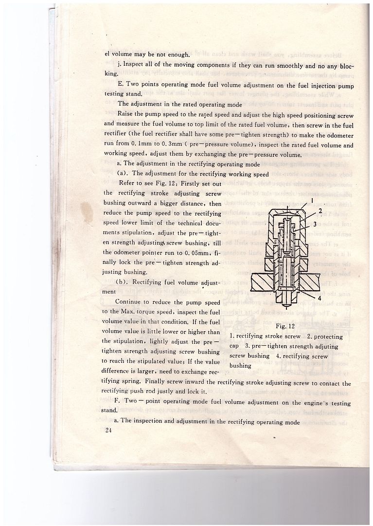

I just scan these pages from the engine manual of my KM385 engine.
Beyong that I will not go further as I never did adjust a pump myself. For me, I am not willing to gues work but if someone is willing to try I will not stop him.
Jacques :)
   / Turbocharging a Jinma 254 Build (Y385) #73
I wish the manual were in english LOL thanks Jacques I'm defintely going to give it a try if I can decipher de language :) Merci

I am not sure on these Chinese fuel pump but what I understand about "smoke screw" for me it mean a kind of "throttle delay" that let the rack in the fuel pump to move at full fuel gradually.
