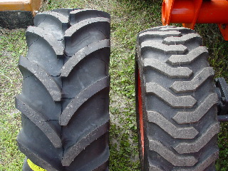

The biggest challenge was finding the proper front tires. Several radial rears are available that will work. The front tires are the ones that bury first in mud and are the ones that also scuff and imprint lawns. Therefore, I wanted a front tire that had a deep agressive R1W tread but which was also as big and wide as possible to get maximum flotation and minimum footprint pressure. But I also had to live within the constraints of the 4WD ratio calculations, available Kubota rim sizes, and physical interference problems with the Kubota FEL supports.
I finally found that the smallest Michelin XM108 made was being imported into the US this August. It was ideal except for some solvable loader interference that I have documented with pictures.
Attached is a closeup of the XM108 next to the Titan R4 on a Kubota L3830. You can see how much taller and wider the Michelin is, and how much deeper and more aggressive the lugs are. Yet, because of its size and because it is a radial ply that will squat flat, manufacturer specs and calculations show that it will have a much bigger, flatter and shallower footprint than the R4 and hence will transmit less pressure per square inch onto the ground. Preliminary tests at Woodbury Tractor confirm this.
The real world test happens Sunday upon delivery. After a few glamour shots, I will drive it straight into the Oozama to where I have completely buried my 2910 many times. If Bob Wolff brings a winch and allows it, maybe I will drive in my departing 2910 right next to it and have a head-to-head mud pulling contest.

Wow Glen, that tire is considerable looking. The tire must work, but man on my L3830, there is a whisker of room between the loader and the R4 I have. Now you have me really curious how this was accomplished. I did not realize you got the new tractor until this thread. The last I saw you were trying to get the ROPS/Folding ROPS figured out. I want to check your profile now to check into the hoe and other things you have. Thanks for the update. Rat. /forums/images/graemlins/wink.gif

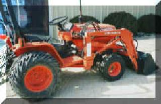

Glennmac,
I found this picture on the Carver Equipment website (see attachment). It was in their implement index (4th row, 4th column) and was labeled "Bar Turf" tires for the B series.
Is this tire the same, similar or completely different from the R1Ws you have? It looks similar.
   / Turf vs R1 vs R4? #59
I doubt very much that it is an R1W. The definitional difference between an R1 and an R1W is that the R1W tread lugs are 30% to 50% deeper than R1 lugs. Hence, an R1W is just an R1 with deeper tread to get extra bite in wet soil. (The "W" stand for "wet soil application".) An R2 is defined as a tire with even deeper lugs than an R1W.
What Michelin (and a few others) has done with some of their radial R1W tires, such as the XM108 and the XM27 hybrid tire, is to make them much wider than standard R1 and R1W tires to increase flotation. The theory is that the high flotation big footprint will keep you on top of the surface with low pressure on the soil, but if you break through the surface to underlying wet soil the deep lugs will give huge traction.
I think the so-called bar turf is just a shallow lug R3 with bar-shaped lugs spaced farther apart than the typical close tread pattern on an R3. I had them on my BX and wouldnt repeat that decision. They imprinted ground more than the normal turfs, and the lugs were too shallow to provide any significant difference from turfs in wetness.
