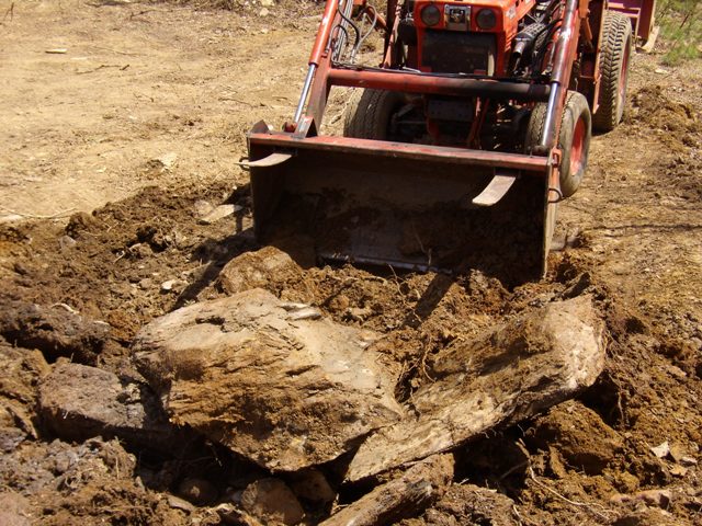

Here you are Thomas. Truck springs with a hole drilled through them to keep logs out of my lap.:D
