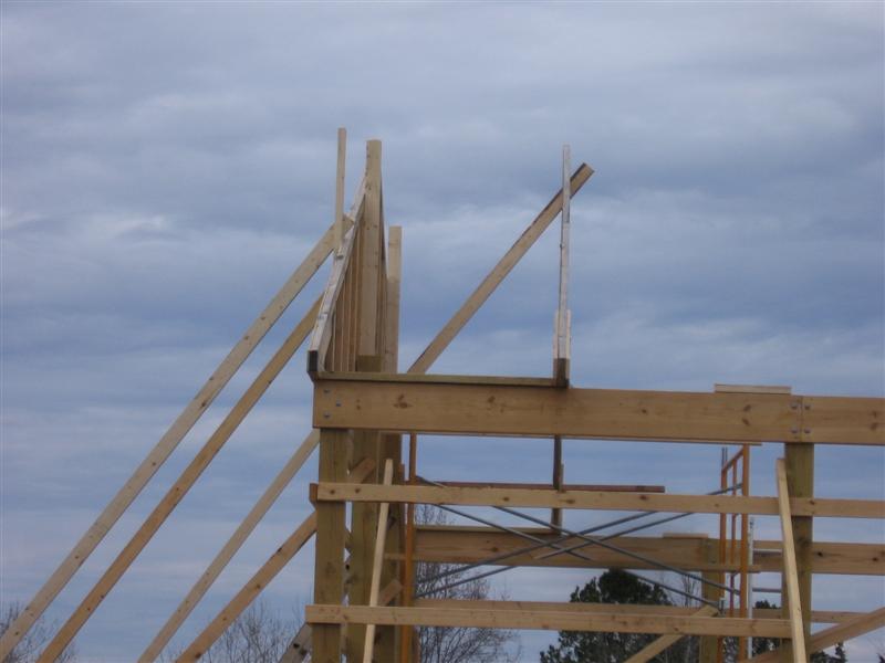

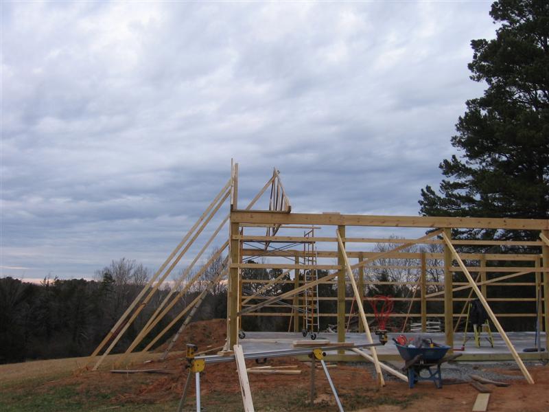

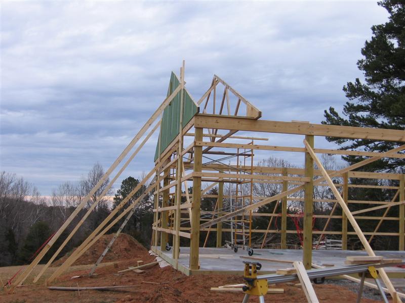

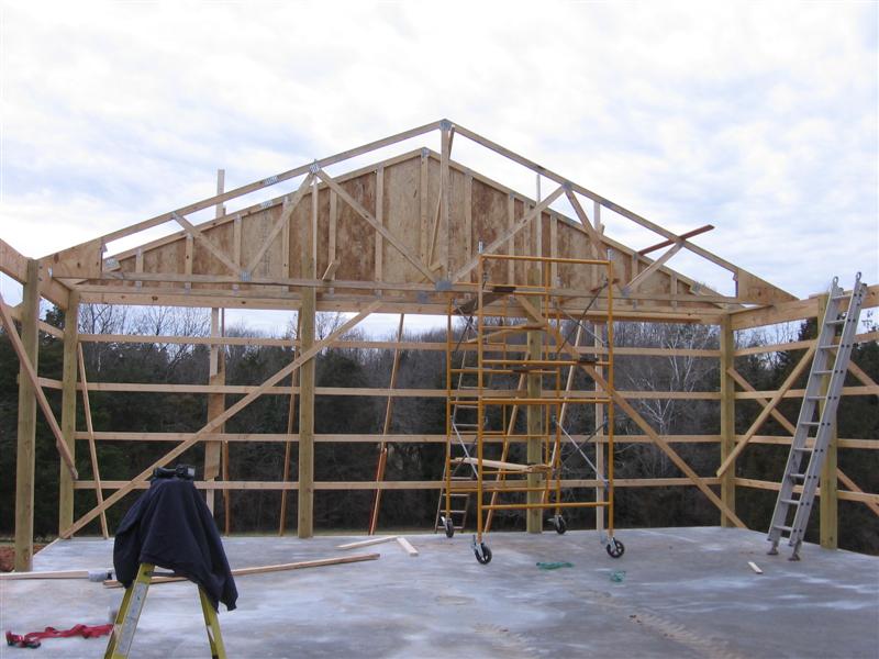

First thing today I worked on getting the gable truss completely straight and vertical. I added more braces to the ground and pushed and pulled most of the waves out of the top chord. I got the second truss up and started bracing it when I realized that something was not right. My braces on the bottom chord were putting a big curve in the truss. I had laid out the placement of the truss on the wall and not taken into account the 3/4" plywood gusset that I had to put on each end of the truss. The truss ends were 3/4 inch further down the wall then the middle. I went back and adjusted the middle of the truss to match the ends. I will put the next truss where it should go. I also forgot to lay out where the purlins are supposed to go. I should have marked them on the ground. It is much more difficult when they are on the walls. I am still trying to figure out the best method of getting these trusses up braced and ready to go.

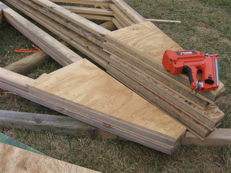

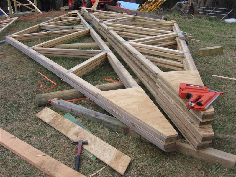

The gussets were a lot more work then I anticipated. Cutting the wood was easy enough. Nailing them together was a pain. Each side had to be nailed on 4" centers on each side. So after nailing one side I had to flip the truss over and nail the other side. Each truss used about 100 nails.

When I was building mine, a contractor friend came over and helped me set the trusses. Once the gable truss was straight and plumb, all the next trusses were referenced back to it. We had horizontal 2x4's nailed to the gable truss, then to the next truss, and so on. At about the 5th truss, we set a diagonal brace from the middle of the floor at the gable wall to near the peak of that truss. Your trusses are 4' OC not 16" OC like mine, so you wouldn't wait 5 trusses before adding a diagonal back to the floor. All the measurements were made from the 1st truss, not truss-to-truss, if that makes sense, so you don't compound any measuring errors.
I also found that the trusses warped a lot just being out in the weather before I could get plywood sheathing up. That made it more difficult for the roofing guys.
Are you putting anything between the metal roof and the purlins? Plywood with roofing felt adds a little to the cost, but it sure does eliminate drips from condensation. I look up at my dad's barn 25 years later and see lots of stains on the wood where the roof condensation has dripped. It can't be good for the wood (or the hay underneath, or the equipment....)

My gable truss has a little warp up near the peak that I could not get out today. I was able to get most of the other waves out with lots of braces.
I came across this sheathing on the Lowes website 1/4-in x 4-ft x 50-ft Extruded Polystyrene Insulated Sheathing. I was thinking this might be enough to keep frost from forming on the underside of the metal. If I tape the seams it would be a vapor barrier. I do not know if it would work or not. Any thoughts? Moisture on the underside of the metal is a concern of mine. There are several threads where people have moisture under the metal. I could spray foam the roof which would solve that problem but I was thinking that it might be cheaper to put in a ceiling and put in cellulose. Eventually I want to insulate the building well so that I could use it year around but I was going to put it off for the time being. Rick
