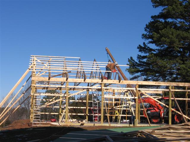

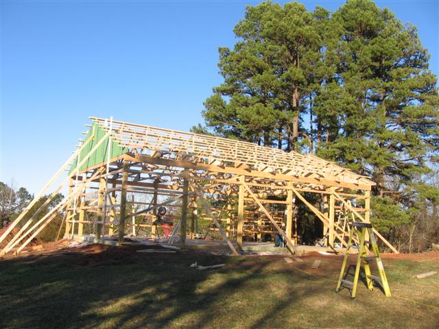

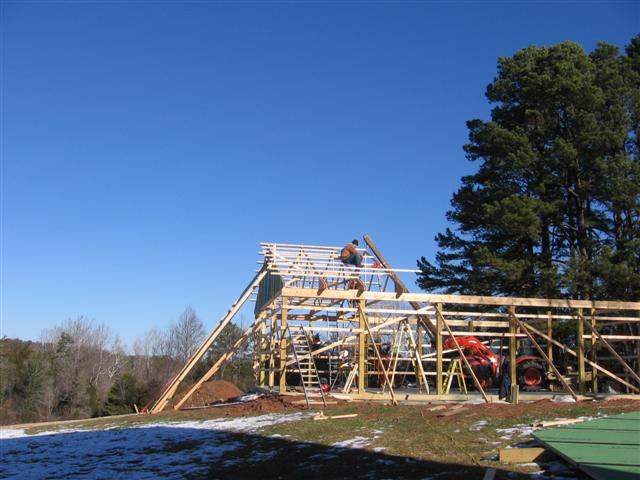

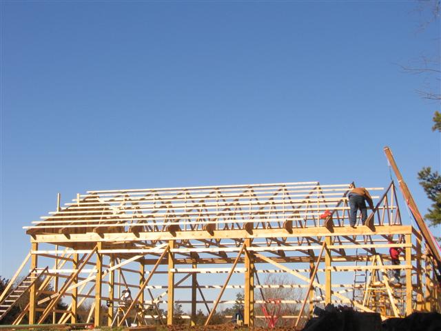

At last all of the trusses are up. After spending a good part of the day yesterday shoveling snow and ice off the building floor I got some help today putting up the trusses. The boom on the tractor worked well and all eleven trusses are up. I have to put in some more of the permanent bracing and plumb up the second gable end but most of the heavy lifting is done.

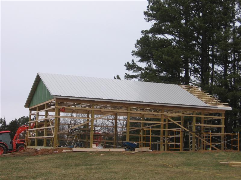

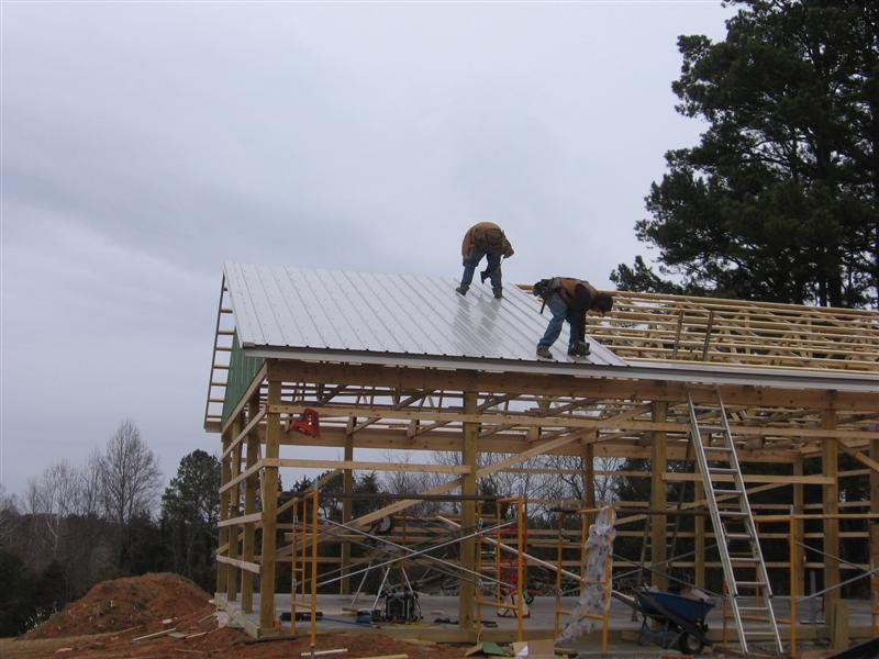

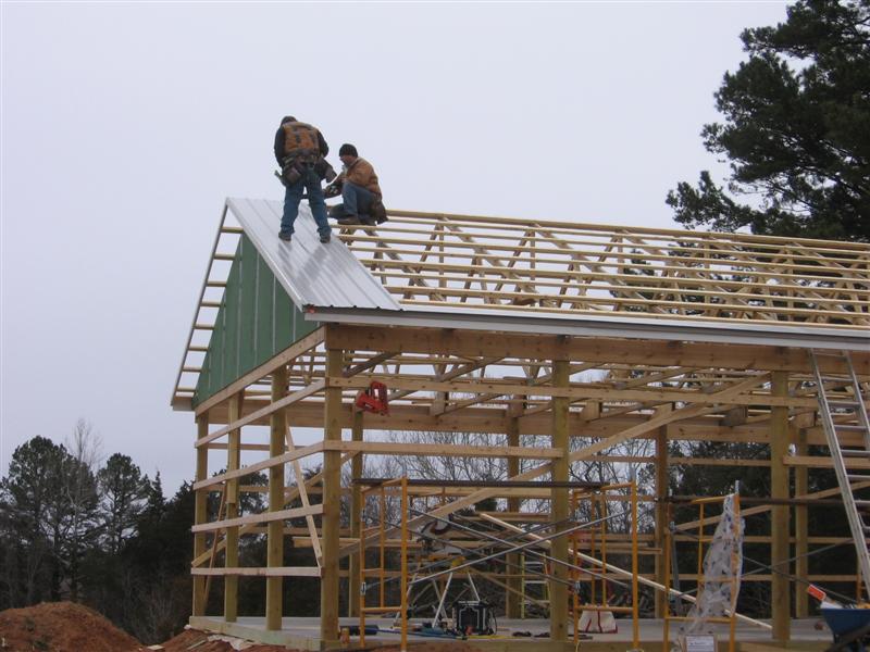

The winds and bad weather gods cooperated with me for a while today. I got my scaffold set up along the side of the building. Got the fascia boards and drip edge on and started putting on the metal roof. I would stand on the scaffold and pull a sheet of tin off of the pallet of tin that the tractor was holding 7 feet up. One of the guys on the roof would grab the end and help pull the tin up on the roof. Thanks CR about the sticky tape. We had one of the guys hold up that edge as I alined the bottom edge and then he would lay it down and then the two of them would screw it all down. As we moved down the building on the one side I moved the scaffold to the other side of the building. They kept me hopping.
I decided that I would not try to put on any type of foam when I was putting the metal on. When I am done with the shell I will get spray foam installed.

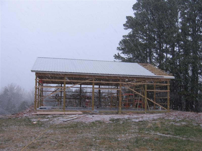

Light snow this afternoon and the guys on the roof decided that they did not want to try slip and slide. We got to within 6 feet of the end when the snow began. Next weekend we will trim the purlins to fit the remaining panels. It was a productive day. Rick

Nice job. It is great how fast metal roofing goes once you get the first couple pieces on. It is also amazing how a very light dusting of snow make that metal roof worse than ice.
   / Two Pole Barns, one new and one to renovate #59
A coating of dust from a road will make a 5/12 roof impossible to stay on without laying a ladder down to crawl up!!! Also watch out for the shady side of the roof when there is still dew on.
Ranger Rick--- Just another suggestion form my bag of tricks... Tie a rope to a pair of vice grips. we welded a chain link to the adjusting bolt on a "real" p[air ov Vice Grips and then tie a rope in that. Your roof guys can help you guide the panel up without having to walk up and down the roof. It saves tracking the panels. You are doing what I was suggesting, foam insulate after getting the metal on. I loved erecting metal buildings. If my legs had held out I was going to do that after I retired from state gov't service. The last real roofing job I had was my Dad's Double wide. It had a 2 yr old asphalt shingle roof that the wind took off and laid it on the back side. It was 1600 sq ft with 4 gables and 11 stacks piercing the roof. I cut all the panels on the ground with my plasma cutter while a couple of guys who thought they were metal roofing installers screwed the metal on. They were astounded when I could cut the angles for the valley intersection with only a measurement of the longest sheet!! I couldn't stay on the roof due to an injury to the ligaments in my ankle. It was in July here in OK when the temp was between 110 & 115 !!! I have a quonset type with straight walls to put up as soon as I can get a crew together. It is one of those with the 18 in ribs.... Never put one up before, but have a neighbor who helped with one.

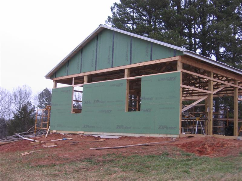

Yesterday I started roughing in the window openings and then putting sheathing on the wall. I got most of the sheathing up on the gable wall. I still have a piece to put up over the windows. Tomorrow I will have help and I hope to finish the last of the roof. The big nor'easter that is hitting New England is giving me some pretty good winds tonight. Hopefully it will die down early Saturday as I do not want to see anyone para-sailing off the roof with a piece of tin. Rick
