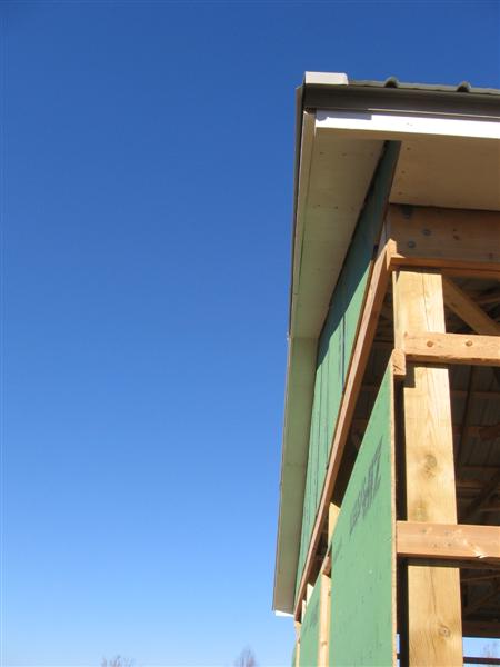

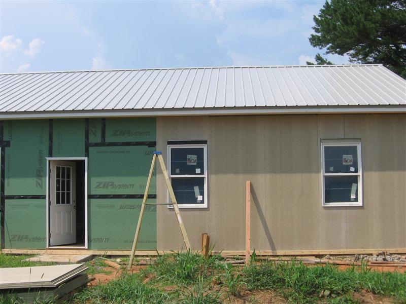

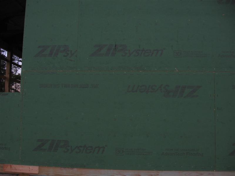

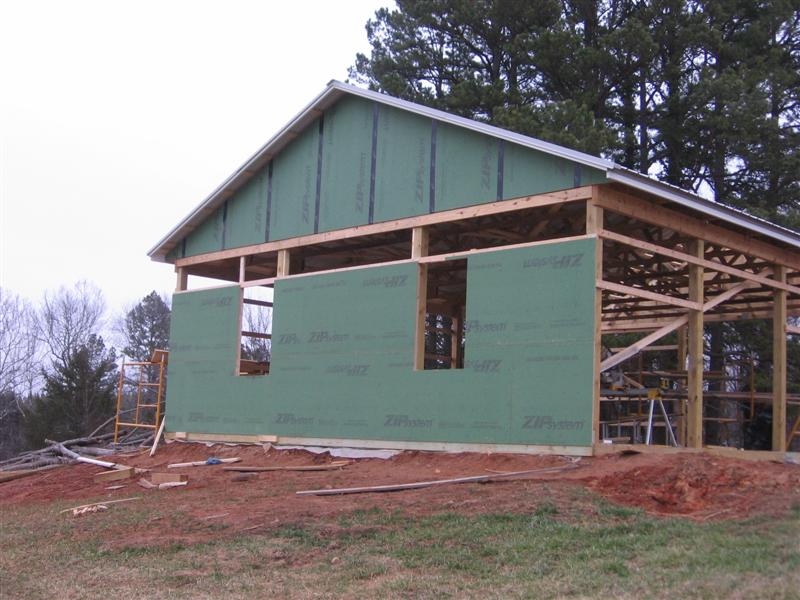

Very nice building, looks very good so far. What kind of sheathing is that, I've never seen that before?
   / Two Pole Barns, one new and one to renovate
#62
The sheathing is called Zip System. It is an OSB board with a water resistive barrier permanently attached to the OSB. All you have to do is tape the seams with their tape. I decided to use it because I new whatever I put up would be exposed to the elements for awhile before I got my siding put on. I was worried about using just OSB because it would get wet and plywood has gotten expensive. The cost of the Zip panel was reasonable compared to OSB and Tyvek plus button cap nails. Putting Tyvek up by myself is a challenge having done it before. Hope this helps. In the picture I have not put the tape on the seams on the lower portion of the wall. Rick

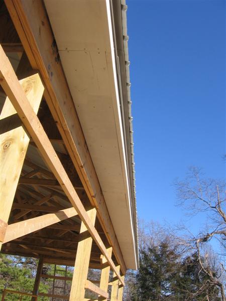

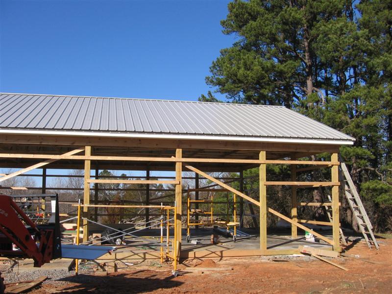

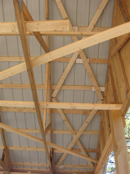

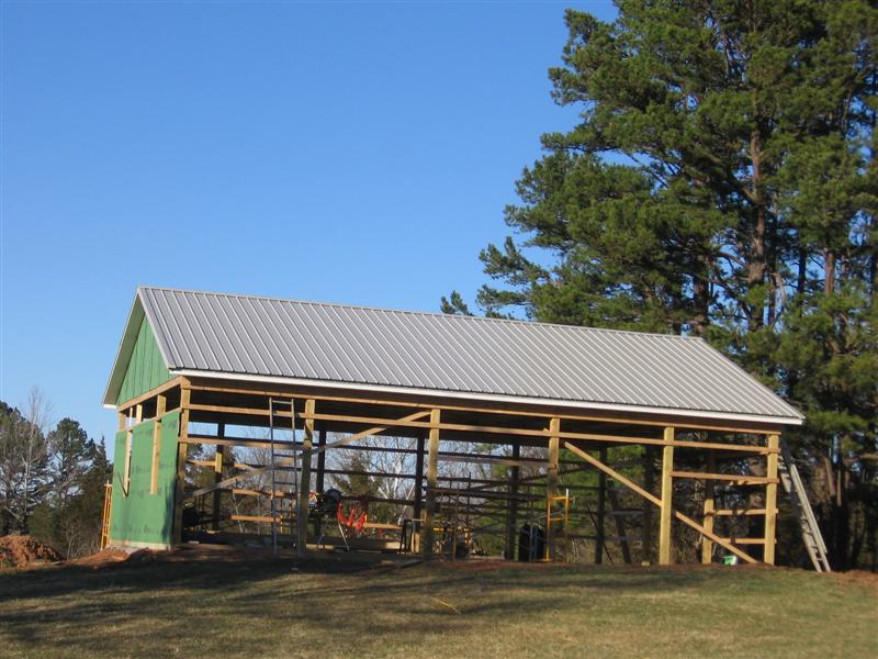

Today was a productive day. I had two people helping me today. We finished putting the rest of the roof metal up. The building inspector when he was out to inspect before my concrete floor was poured told me about what permanent bracing was needed on the trusses. He made a point that many contractors that do not use sheathing on the roof forget to put bracing on the roof plane. Today we put in the X bracing on the purlins. We also got all of the soffits closed in. Everything from the eaves up on the pole barn is done. I just have to work on the wall sheathing and siding from here on. Plenty to do but it is a big step for me to have the roof structure done. Rick

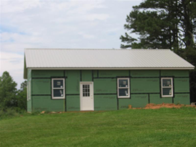

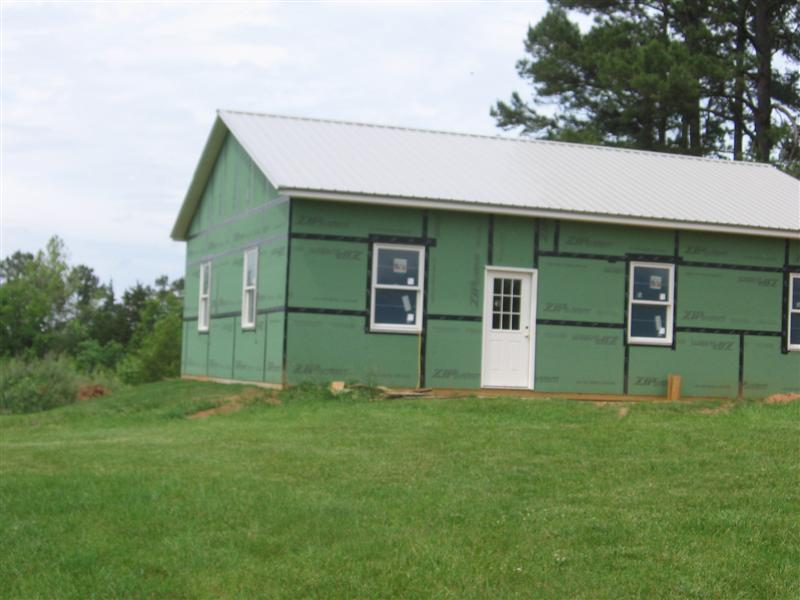

I have not posted for a while now. I got side tracked on to a fence project that was a hundred plus feet of new board fence and a thousand feet of new wire fence. Along the line I had put my camera in a jacket and could not find it until recently. I got all the sheathing on and last month got the windows put in. So things are moving again.

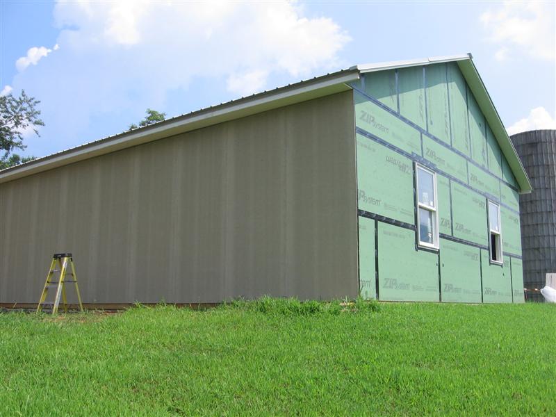

Yesterday and and today I had some help from my neighbors son to help put up the some of the Hardie panels. We worked only a few hours each day because the heat and humidity have been awfull lately. The heat index has been over 107 each day. We made quite a bit of progress in spite of the weather.

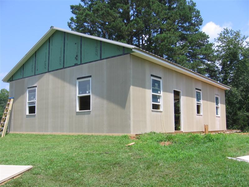

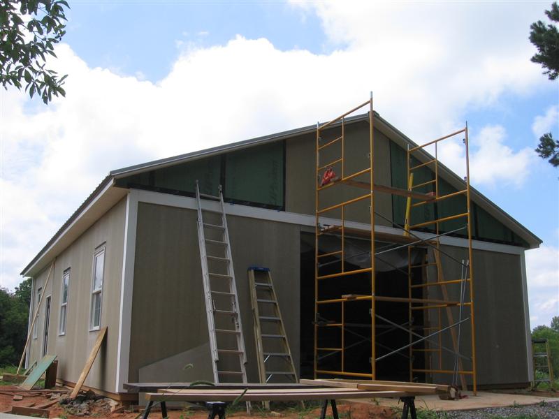

Made some more progress on siding the building. I have siding on the lower 10 feet of all of the building now and have started working on the gable ends of the barn. I still have battens and trim to put on the walls but we have made some good progress. Rick

The siding is looking really good. Does it have a texture on it, I can't tell from the pictures? The only hardi plank I ever worked with was smooth but would last forever, very durable stuff.
