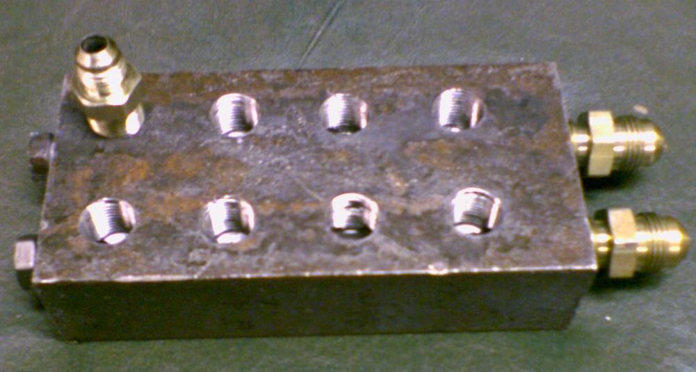

My plan is to only have 2 outlets from the pump. One for the upper port and another for the lower. Then install a block where there is more room. This is as far as I have come along. Seems like lots of work ahead for this one. I hope not as much as the side mower though!!! Just so you all will know I didn't desert this project here is a pic of the block. It took a few hours just to make it!!

You are right about the way the motors are routed. Good observation! Don’t worry about the path of least resistance so much. I believe the problem of one wheel spinning too much will be taken care of by the size of hose used in the route of the low speed high torque mode. The larger hose will still be used inline for the standed mode. I want to keep this project as simple and cost effective as practical. Too me this is kinda what it is all about. That is the challenge. At least for me.
Another thing I want to look into is maybe having a block built or finding one that will have all the ports like the one I made as well as 2 solenoid valves for the switching of modes. This would keep the project even more compact and a few more less hoses. Either way will work. As I said, cost effectiveness as well as simplicity is what I’m after. I’ll say again this project will take awhile. And then it may take a little longer to better it. Please ever one, Keep the information coming.
