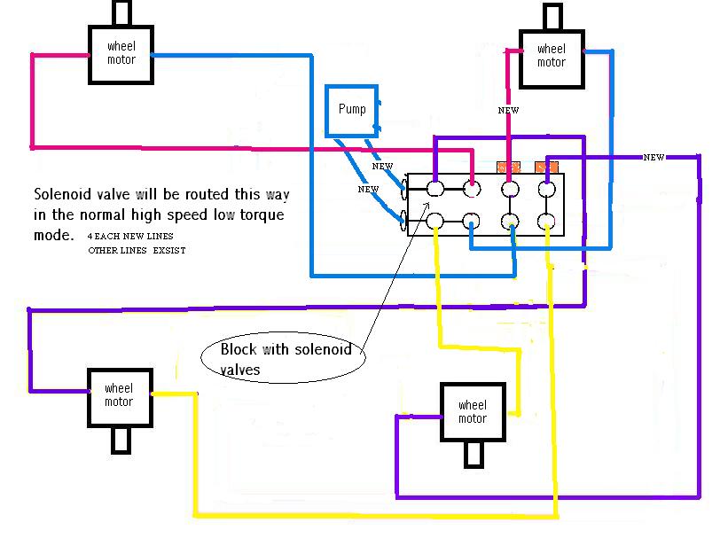

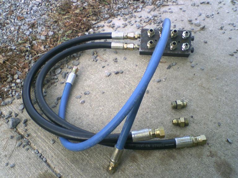

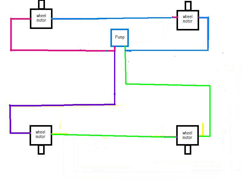

Sorry Guys I dropped out on this one after exploring how many hoses and valves it would take to be able to switch the modifications back and forth. All my land is mostly flat anyway. A block with the valves and ports built in would do the same but this was going to be a task as well.
I do have the block and hoses that would change it permanently to the low speed. If any one is interested in doing this and reporting to tractorbynet I would donate.

Just wanted to "close the loop" on this topic. In researching this whole need for more torque to climb the Tennessee hillsides, I found out that I have White RS model, 12.5ci wheel motors on my PT-425 purchased in Dec 2000. They are rated at 1500 PSI continuous and 1750 PSI maximum. I had earlier, mistakenly thought that they were White CE model motors rated at 3000 PSI.
Consequently, they will not handle the pressure that would result from this mod. They would need to be capable of handling up to 3000 PSI, which they are not.
I'm now looking at replacing the wheel motors to address this need....
/ Two speed modification for PT 422/425
#52
I finally had the opportunity and reason to try out this wheel motor configuration. I am sad to say that although it slowed the PT down by half it did not double its climbing and push power. I believe because of bypass seepage in the wheel motors the supply of oil to the motors was not enough to overcome the seepage enough to take advantage of this configuration. All said and done in this configuration and my motors (over 1000 hrs) my PT 422 did not climb any better that the original configuration.
