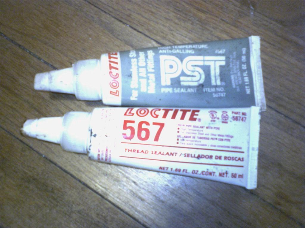

Guys I don’t know what else to tell you. Here is what I use professionally on Hydraulics at work as well as at home. That said, in a pinch I have used Teflon tape but I was asking for trouble, it tends to squirt out the end of the treads when tightened. I definitely agree, you do need to use some kind of sealant.
Loctite 567 item no. 56747
PST PIPE SEALANT WITH PTFE
High temperature For Stainless Steel and Other Metal Fittings
The two tubes pictured are the same thing.
   / Two speed modification for PT 422/425 #38
I didn't know you could use Loctite for this application.

</font><font color="blueclass=small">( I didn't know you could use Loctite for this application.
)</font>
Just so there is no misunderstanding this is a Loctite BRAND tread sealant. Not the Loctite brand loctite that locks threads in place. At one time this confused me too. /forums/images/graemlins/confused.gif
