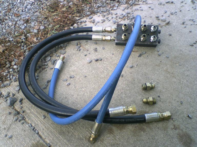

Sorry Guys I dropped out on this one after exploring how many hoses and valves it would take to be able to switch the modifications back and forth. All my land is mostly flat anyway. A block with the valves and ports built in would do the same but this was going to be a task as well.
I do have the block and hoses that would change it permanently to the low speed. If any one is interested in doing this and reporting to tractorbynet I would donate.

Stray, is this offer still "available" --
I'm getting ready to modify my 425, at least to the point of your "test mode" (without solenoids). Are you still willing to donate what you've done to this point? If not donate, are you interested in selling those parts?
I think I'd be quite satisfied with the permanent high-torque/low-speed mode...
