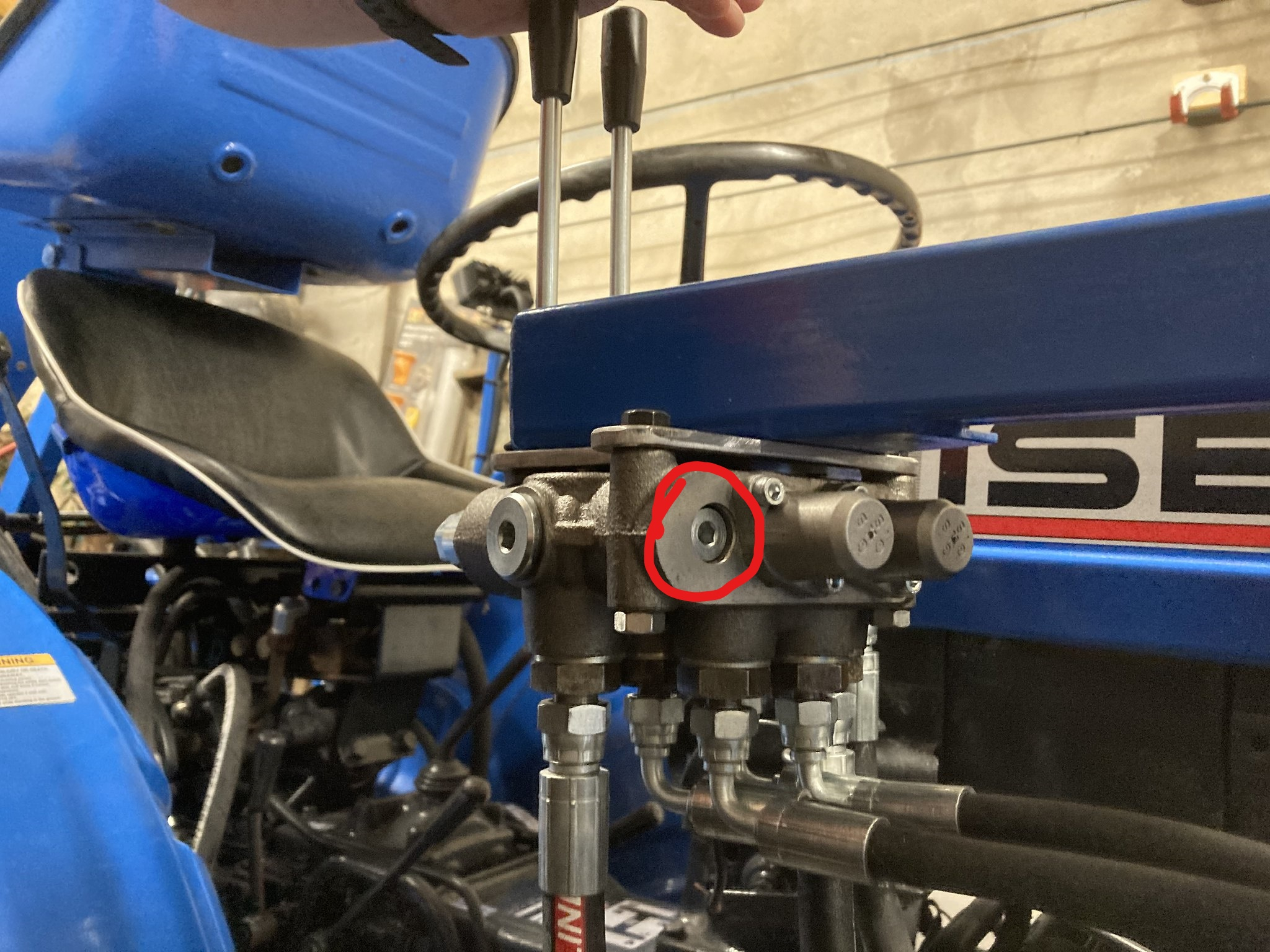

I wouldn't lose the faith on that new valve just yet. It's just not function quite right. It does look like it has a check valve, and it may be stuck open causing that effect you're experiencing. You may want to pull the check valve and see if it's moving freely, or something is preventing it from closing all the way.
Does it happen on the curl/dump circuit as well? I imagine it would be hard to tell and it may not have enough weight to recreate the same effect.
This should be it. I marked the location on the picture.

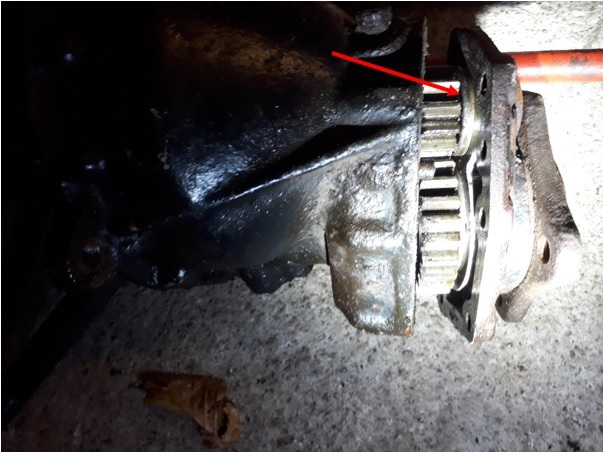

Third question: Did you open the final gear case at all? I'm having a bit of an issue with a bearing inside that case.

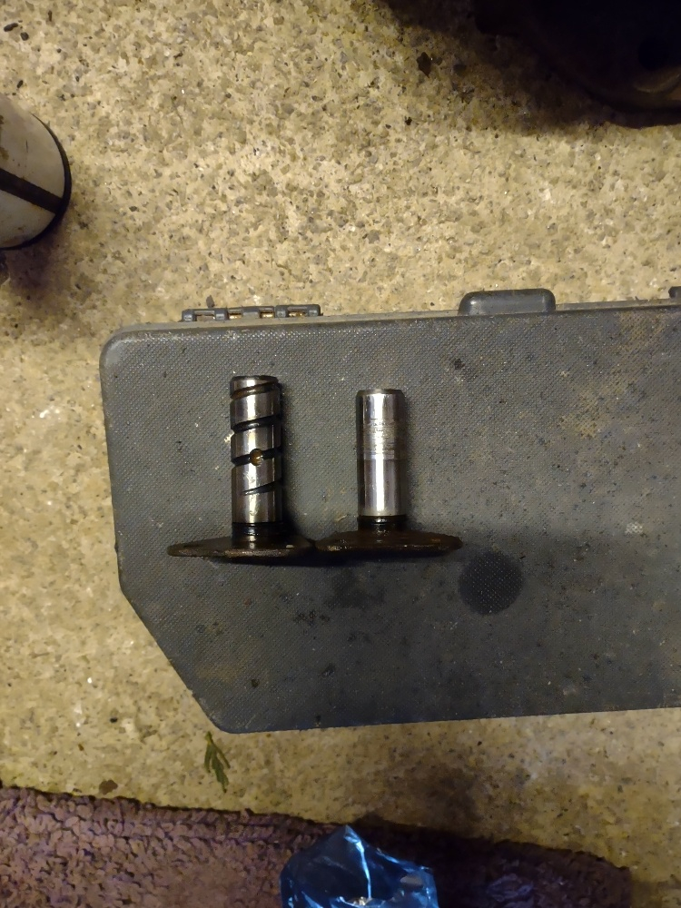

The lower pinion on mine had a straight groove and was a bit worn:

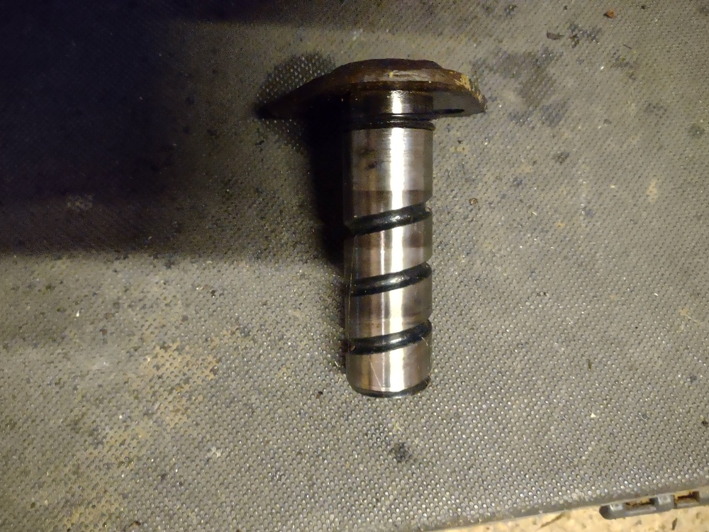

Both pinions on your axle had spiral grooves and grease nipples:
So I opted to use yours but it was a bit longer and I was concerned it might foul the UJ. I cut it down by a few mils.
This picture is of the original sizes.
The end result seems great - and with trees coming down right, left and centre and wood chip to haul as well - so she's going to be well tested very soon.:) We're still struggling with a couple of awkward trees from storm Arwen. Dudley has passed .. just waiting to see what Eunice brings. :(
Below is the gear case mentioned above. It's the other half of your axle.
With extreme violence I think the bearing has moved out by a mil or two. Not easy to pull.
Any idea how to get it out? Is heat the main approach?
How will I ever get it back in again? Thanks.

That is about the only part of my tractor I have not taken apart, but what I have done if its of any use is copy a couple of pictures of the parts manual to help you along hopefully, it does look like it just slides out though as you say.
Untitled by chrismac2012, on Flickr

Thanks again for front axle pages. I need to rig up a puller somehow.

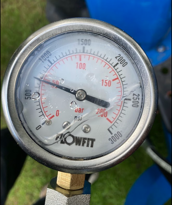

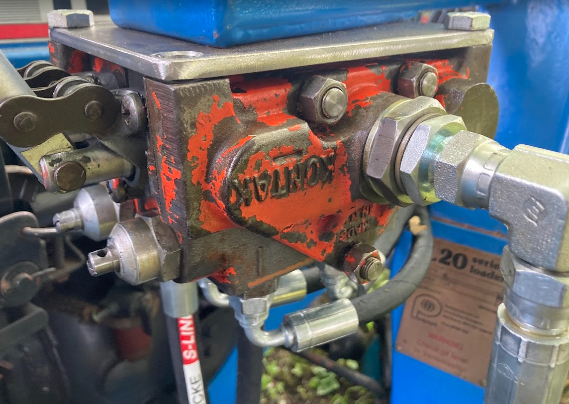

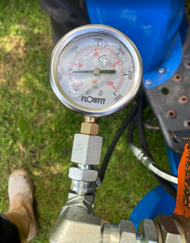

The leaking loader spool valves have been fitted now for some time, I went back and fitted the replacement set bought and after receiving replacement spools for the internals they still would not work as they should,
So I bought a Kontak 3 slice 2nd hand, removed one slice replaced the O-rings between the slices, drilled and tapped the end cover as there was no power beyond (HPCO) port on this spool block, but now I dont have full pressure to the rear arms lift, I first noticed this when I went to lift the finishing mower and it would not raise as far a usual.
I bought a pressure gauge and fitted it to the supply to the spools and then on the HPCO there is a significant drop in pressure between the two. would anyone have any ideas where to look, I would like to think I dont have a lek on the HPCO adaptor as it was actually machined to make it a tighter fit as I never had a reamer the perfect size and ended up taking a very small skim of the O-ring shoulder OD making the O-ring actually tighter.
tilt rams held back, full pressure

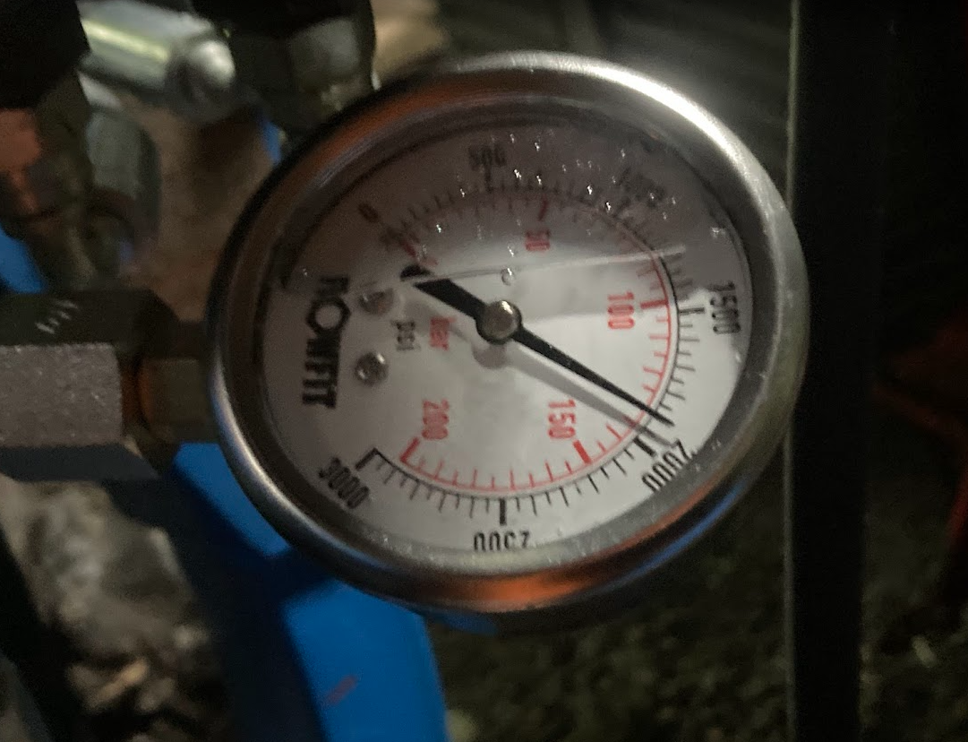

HPCO pressure with lift arms up, mower on, significant pressure loss
This is now with some revs on the engine, there is now enough to lift the mower, but its not right,
This is the spool I bought
Would anyone have any ideas why I now have this issue, on the previous 2 spool valves they worked the rear arms fine, now I finally get a spool valve to operate and not leak I have issues down stream.
Chris

I did the same thing on my Rexroth valve for my loader valve. While it was drilled and tapped for the Carry over or Power beyond port and had just a plug blocking the port, I still had to block the internal passage to the tank port.
You may want to check that out on that valve to see if that's your issue.

Thanks I will do and report back, if I block the out port, I gather I am then forcing oil down the HPCO as thats the only route out, will that affect anything else.

Your correct, when I disconnect the return line to the tank, the 3 pt linkage works as it should, strangely the loader also seems to work fine..... cant make any sense of that as I thought the return line would have been for the oil being discharged in the opposite direction of the ram movement, mind you I can leave it plumbed in and just disconnect when I am using the 3pt linkage as its on a quick release coupling.
   / TX 2160F, with front loader and backhoe, long term project
#153
Got this issue fixed tonight the o-ring on the HPCO adaptor had been nipped during assembly and that was the leak path to the return side. New o-ring fitted and my 3 pt linkage is working as it should.
That will do it. I figured it was so something along those lines.
Being that you had still some pressure at the 3pt, it has to be a very small internal leak.
