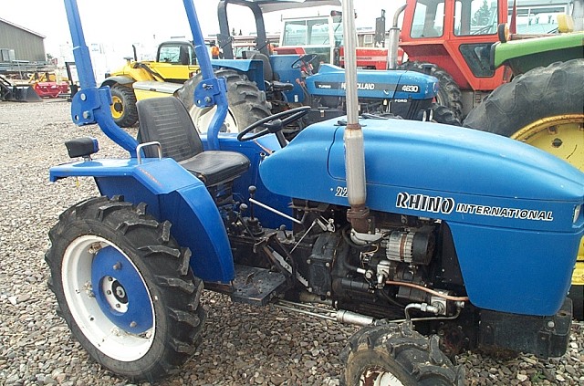

The engine is a two cylinder TY290. I have attached a picture of the only other tractor I have found with the same setup as mine. It is a 2004 Rhino. Notice the pumps are offset. This is because of a clearance issue with the alternator. If anyone knows where i can find a setup like this in a salvage yard let me know. Tom at farm boys is working on it as well. I have already stumped Phil at Circle G (which is HARD to do).
   / Un-findable Part Need your help #19
The fact that it is a two cylinder engine is irrelevant in this case. In this picture I see the main hydraulic pump is mounted offset to clear the starter. The other pump is mounted in front. Do you have the second pump mounted in front? I believe there might be another place on the left front of the engine where you can mount a pump.
Pretty sure that's already occupied by the injection pump
