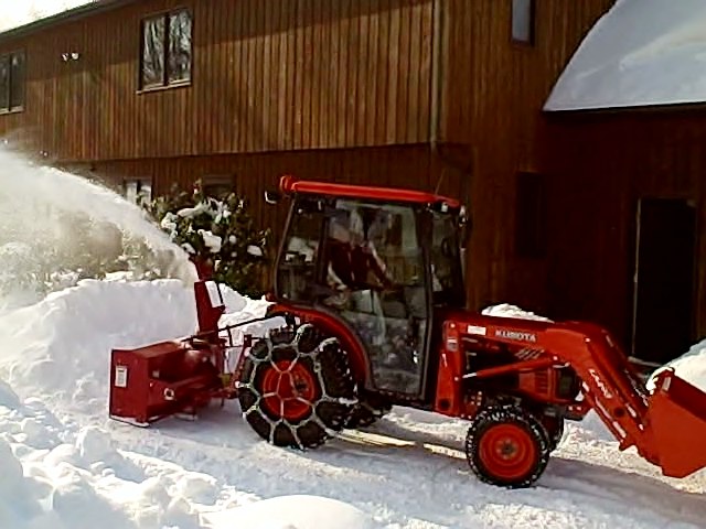

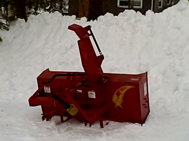

Wawajake,
Two winters ago, we got clobbered with snow here, so I decided to get a 3-pt rear mount snowblower. One dealer had two Meteor blowers in stock. One was used, and the other was new, but had sat on the lot for five (5) years! The paint was faded and it had a dent in the top. I decided to get it and repaint it black. I would say it was the best purchase I ever made. We had a 30" snow storm last winter. The Meteor handled it like a champ. Note the snow piled behind the blower in the middle pic. That's what prompted me to buy it.
