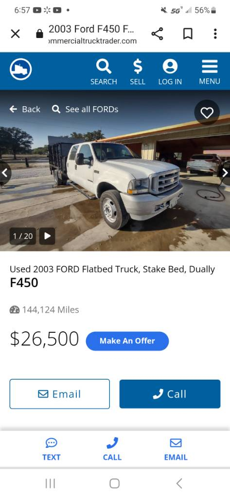

So; what I'm unclear on; a simple class 2 or class 3 truck; what's the max non CDL trailer? Could a 15999 truck pull a 20k trailer? What about a 9999 truck? Are we still work with the 36000 total combination? Or are we automatically talking about a CDL A for a 10,001 trailer with an SUV?
Dont know how to make it any clearer. Read the black and white....or follow the flow chart.
IF the trailer is 10k or less.......what matters is ONLY the tow vehicle needs to be under 26k.
If the trailer is OVER 10k.....then the whole combination needs to stay under 26k
So NO you cannot tow a 20k with a 16k truck without a CDL.
Basically......any trailer under 10k is like it dont exist in the eyes of this law.

So; what I'm unclear on; a simple class 2 or class 3 truck; what's the max non CDL trailer? Could a 15999 truck pull a 20k trailer? What about a 9999 truck? Are we still work with the 36000 total combination? Or are we automatically talking about a CDL A for a 10,001 trailer with an SUV?View attachment 792889
No 26,001 lbs. is the magic number. Yes the trailer has to be over 10,000 lbs. Actual or GVWR to be counted for licensing. So technically you can be 36,000 lbs. The truck 26,000lbs. and trailer 10,000 lbs. or less and not need a CDL
