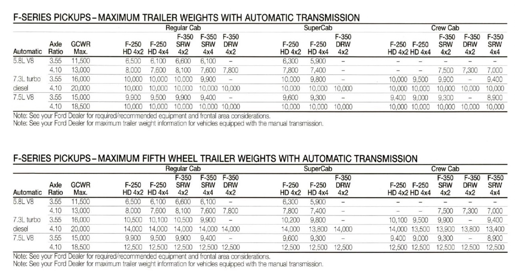

That's a great question, and one I do not know the answer to. The sticker in the door frame shows the GVWR and both axle ratings, but no GCWR. Ford's site only goes back to 2004 with the towing ratings, as far as I can find... and my truck is a 1997 F-250 HD Supercab.
From:
Bruce
   / Understanding Curb Weight, GVWR, Towing and CDL requirements #74
But considering it has a gas engine and 3.73 gears, it can't be rated anywhere near 17,000 lbs of trailer. Likely closer to 10,000.
In which case, I'm back to the drawing board re: the best way to move my machine without a CDL.

These old fords cant pull half of what a newer truck can by the stickers. I have a 94 f350 and 06 ram 3500, no where near the 30k the say today
