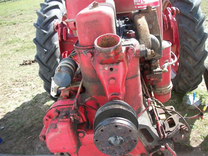

Yawn... i'm gonna go get greasy and put the timing cover, crank pulley, cranksahft seal and governor back on my farmall C..

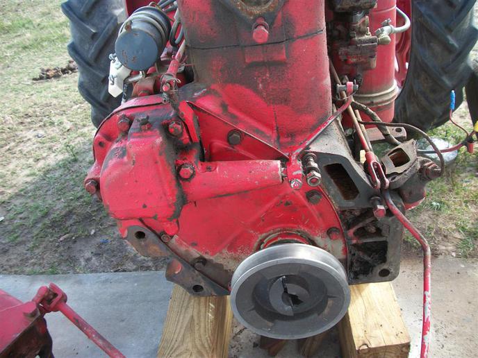

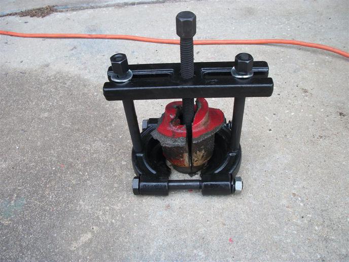

here's how 'bad' HF tools are:
this is the remnant of the cast iron ( good quality 50's cast iron.. american made ) pulley and hub on my farmall C
That is a harbor freight bearing splitter.. cost 7.99$ pitsburgh brand or something like that. ..
i used a 16 ton bottle jack, 1/2" bolts and a flat plate as a puller..
hub broke.. NOT thge hf puller.. which is in a-1 condition.

So, how did you get that piece loose?
   / Unhooking pto with engine off? #54

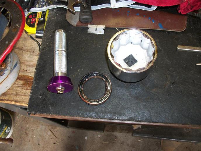

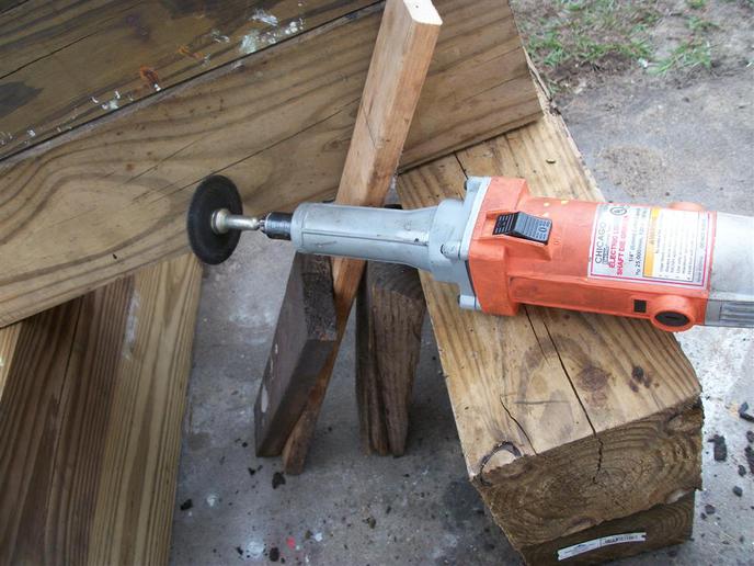

took a die grinder and split it on 2 sides, at least the 2 external sides I could get to. there was still 1.5" of it burried inthe timing cover I could not cut.. then used a cold chissle to split it wider a bit. which loosend the grip on the crnk snout, then a bearing splitter puller slid it off actually pretty easilly, and that actually split it in 2, when it pulled..

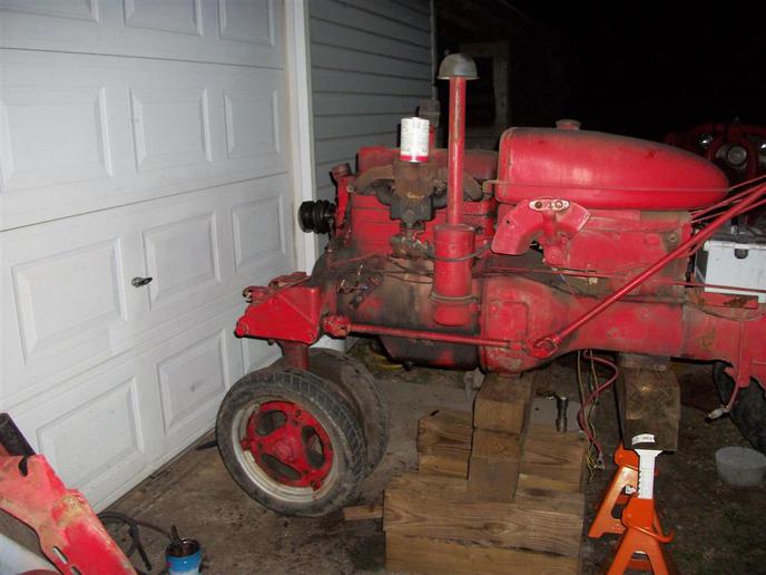

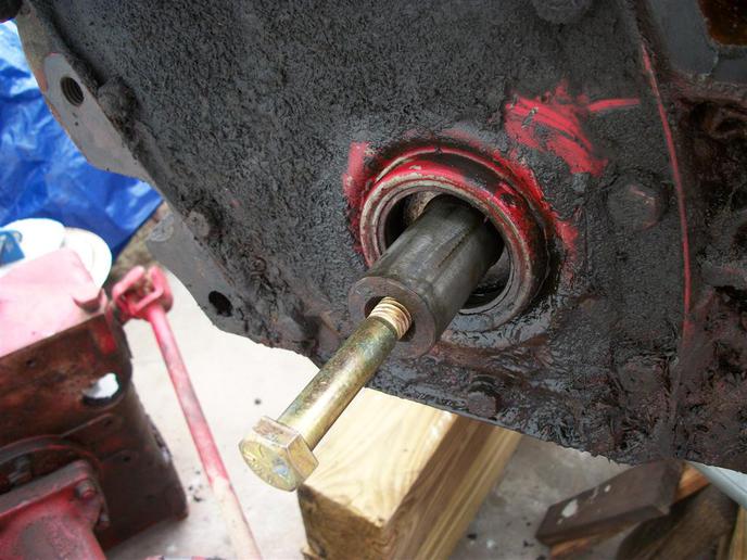

used a backing palte and gr8 bolt and a 3/4 gun to pull on the new crank pulley afer cleaning up the cover and governor inards.. got the gov and top and bottom water ports on, and fan hub, then seperated the front pedistal into 2 pieces so i could manhandle it a bit easier, get them both back on.. so tractor is setting on 4 patches of rubber as of about 7:15pm last night.
