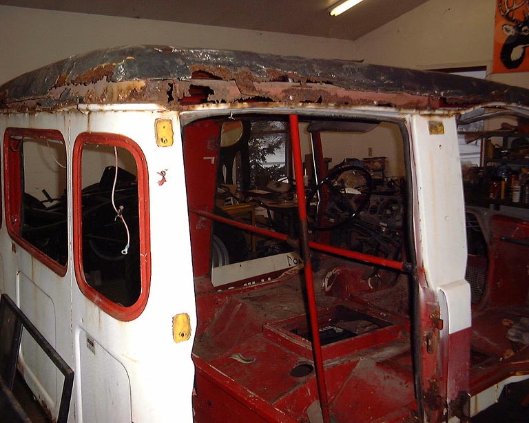

Here are a few more photos since last night when my son and I stripped out the cab.

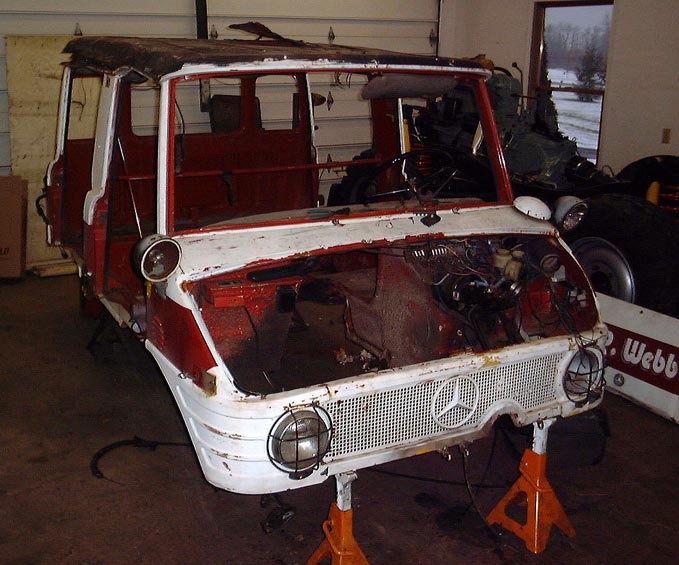

Here is one of the rust that we are up against. /forums/images/graemlins/crazy.gif

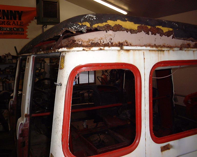

Here is another one of the rust that we are up against. /forums/images/graemlins/crazy.gif
