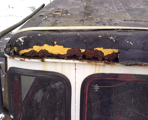

Well I finally got the DoKa crew cab yesterday! After all the screw ups with customs and shipping its here. Minus some parts /forums/images/graemlins/mad.gif that got lost when the crate fell apart so they tell me. /forums/images/graemlins/crazy.gif I am missing the front fenders and the fuel tank, but I talked to the seller who arranged the shipping, so he is seeing what he needs to do to replace the missing parts. Plus they cut the wiring harness in about 6 places and I told them I need a compete harness, so they are going to replace that as well. So here are some photos of the cab. I need to replace the whole roof due to rust! /forums/images/graemlins/frown.gif The floors are solid, but the roof is rusted! What kind of weather do they have in England anyway! I plan on using a older Dodge van roof as they have very close lines as the Unimog from the rain gutter on up. I wonder if any vans had a power sunroof? If I have to replace the roof, I might as well put a nice one on! /forums/images/graemlins/cool.gif

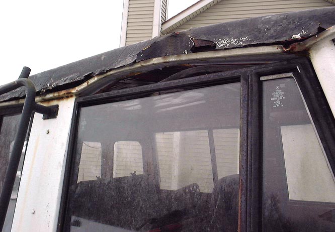

photo #2

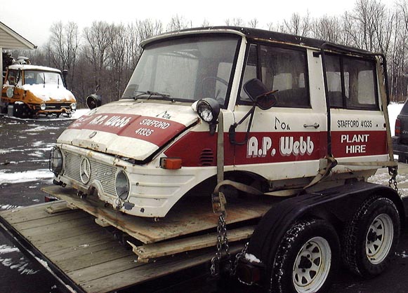

photo #3

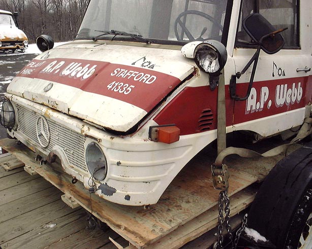

photo #4

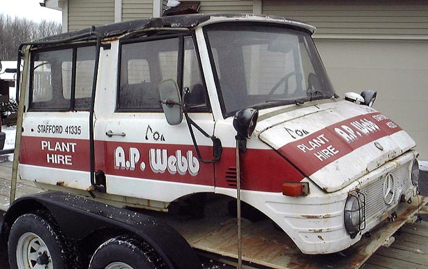

Last one for today. Since I took these photos yesterday I have taken all the doors off and removed all the rear glass + windshield.
