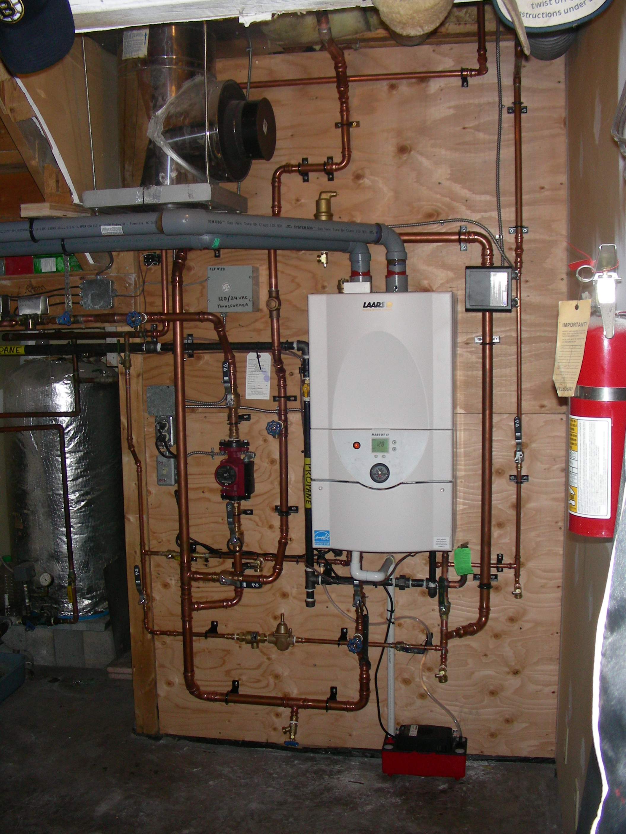

This is unit I had installed this summer. It is propane and does my potable hot water and all my radiant heat for house. It is a European brand called Larrs.... rated at 125 MBTU/h. and uses new kind of 2 inch PVC for exhaust and intake. The professionals had difficulty getting the settings right at first because it came from factory set for natural gas , and it is not set by orfice size it is set electronically to change to propane. Eventually they gave up and ordered another unit set by factory to propane, it arrived a week later. Has worked great since. We will see how the first winter goes, but it seems up to task so far. But they are expensive. I switched from a wood boiler (the chimeny is still seen in the pic.)
