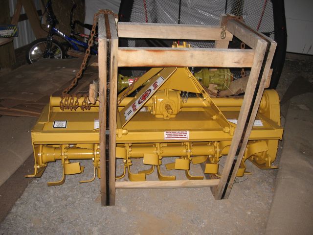

Even with pallet forks, a carry all is very useful, as you can carry a lot more weight on it than you can on the front loader. Search on Markham welding for pallet forks, nice product at a good price. Lots of people on here buy from them.
As far as the unloading part, lots of good advice already given. Before I had pallet forks I've used the bucket, and chains. Actually, sometimes I still just use a chain from the loader if it's something I can easily put a chain on. This pic is how I unloaded my tiller. Just wrapped a chain around it, and simply hooked on the back of the bucket. I didn't have a picture of the unload, but this picture still had the chain attached.

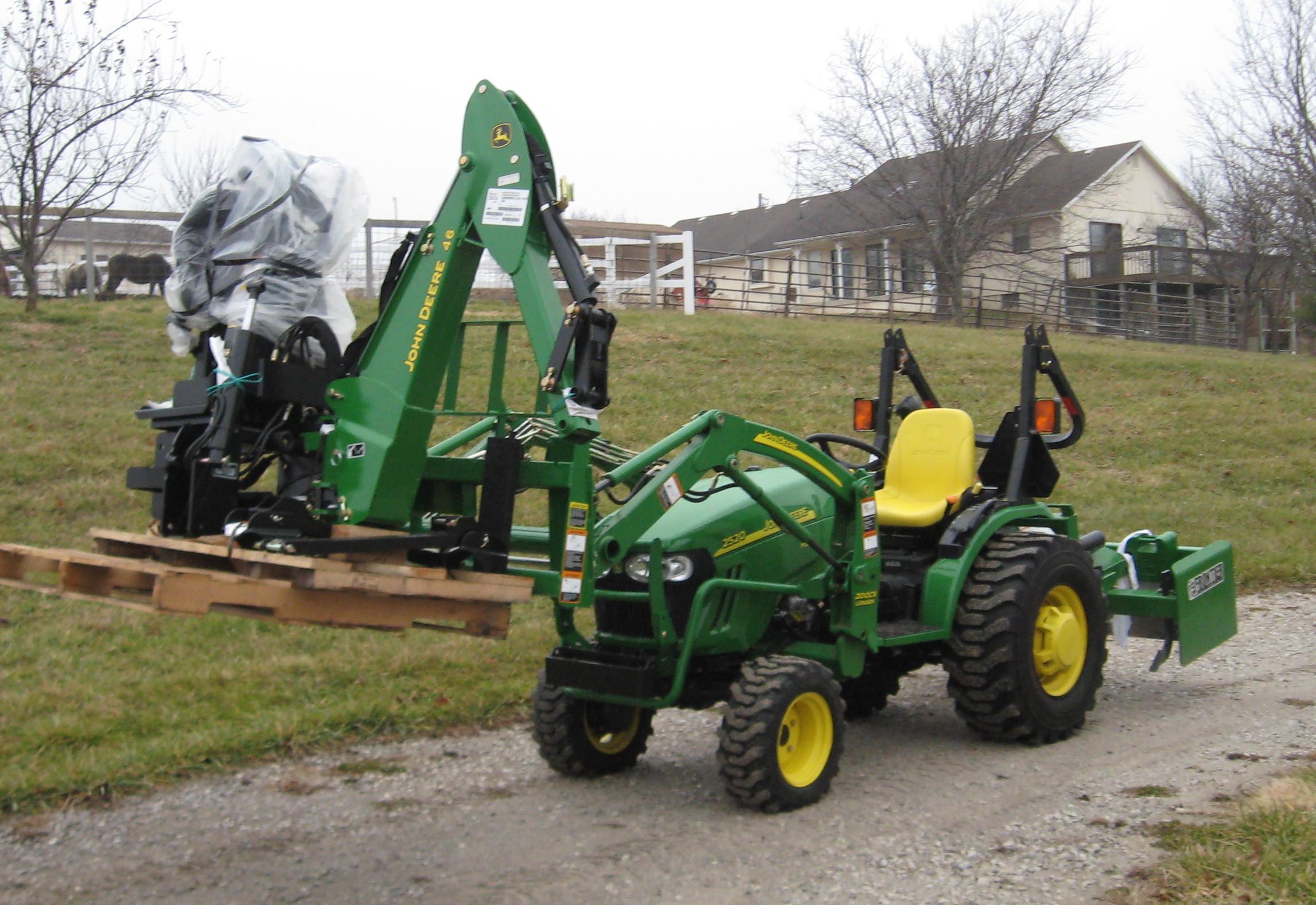

I was glad I bought my pallet forks with the tractor, they made unloading future attachment purchases much easier.

Runner.....
That's a fine looking new "To_".... oh I mean "Attachment"....:D:cool:
