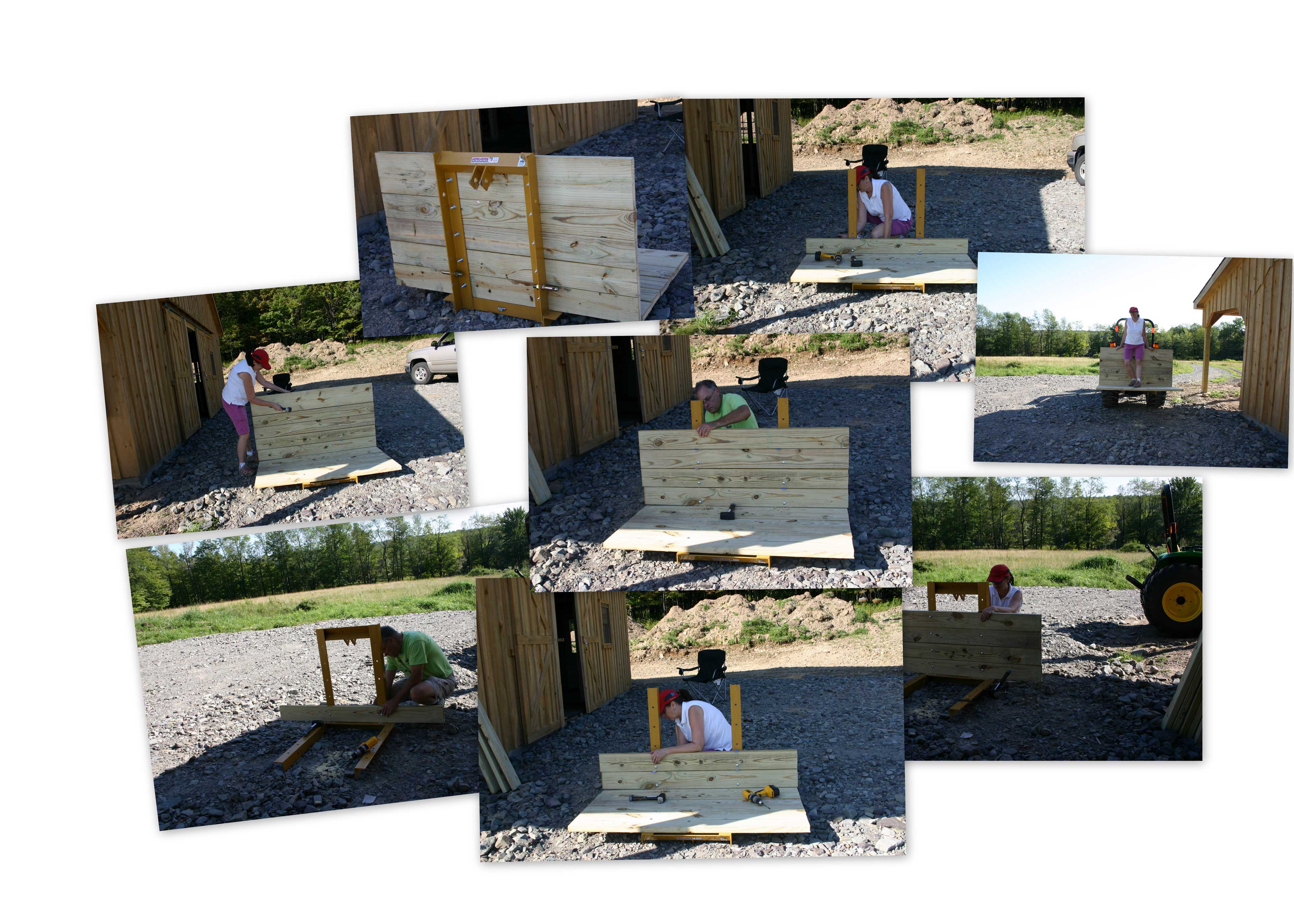

#42
Here we are building the carry-all on the TSC frame. I'm glad that we have this attachment!
   / Unloading The Delivery of Your Attachment #43
I have the same carry-all and it's probably my most used attachment. I have a similar wood bed and recently added sides to it for hauling firewood. It's amazing how many things you can use it for and how it compliments the FEL. I added a couple vertical 2" pvc pipes about 30" long to the front wall of mine next to the 3ph pins. I capped the bottoms of the pipes and they work great for rakes, shovels, etc.
   / Unloading The Delivery of Your Attachment #44
I built a similar TSC Carryall platform this summer. It is about 3x5ft with folding sides and channels in the sides to hold boards for a back gate. The top backgate board comes out and can be used as a seat, if I'm transporting assistants to the woods or wherever. I also have mounted some plastic pipe pieces to hold tool handles and also built a scabbard for the chainsaw. The lumber cost considerably more than the carryall frame did! I have it on the tractor most of the time.
