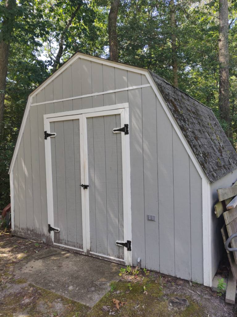

T111 will last a long time with a little attention to detail. The house we bought came with a 12x12' shed sided with painted T111. Judging by the trees that had grown up around it and Romex stamped 1998, about 20 years old. I had to replace the panels on one gable side and rebuild the doors 5 years ago when we moved in, they had rotted on the bottom where the water splashed up during the rain. No gutters or overhang, so worst of both worlds. The Z flashing is a good idea, the front of the shed is original and solid.
I'll second the suggestion to reinforce the joints with vertical 2x4s. Help to keep your panels from warping and pulling apart as they dry.
Another thing to consider, if your wedding venue idea really takes off you may want to build a bigger or more custom building down the track and repurpose this one as a shop or something. That would be one awesome shop! This a tractor forum after all :) IMG_20190812_115149.jpeg

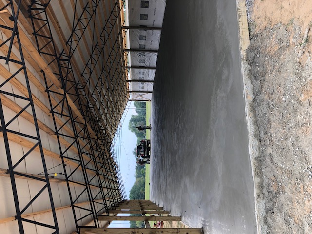

Here are a few more pics of my project. I installed cross-bracing (2X4) in the corners, and have done about half the T1-11 panels on the backside. On Monday, I had a crew pour concrete. 57 yards over the top of mesh and about 3 loads of gravel ($11k). Next up, I'm going to put up 2x4 studs on the ends to wall it in. I'm intending to tie to the 2x6 purlins on top and sink anchors into the concrete at the bottom. I'll then install T1-11 over the top of that. Any suggestions on the final walls are appreciated. BTW, the building contractor did a bang up job on getting everything straight and level.

Wanted to give another update on the project. 40X90X10 pole barn that will be used for a wedding venue. I've finished closing in the front side/end with T1-11. Yea, I know I did the ends wrong with vertical studs but I'm closing the gaps with 1X4 on the outside. I've installed 2 double doors and have a 3rd single door yet to install. Laid down some acid stain on one corner of the floor and installed string lighting. Oh yea, I have my first booking, Feb 1st, 2020. I've got $30k in the pole barn and concrete floor. Have put another $8k into it and will have another $15k into the bathrooms (perk test has been completed, about to order septic install and water tap). I'm going to end up somewhere around $50k for the entire project. Thanks for everyone's input.

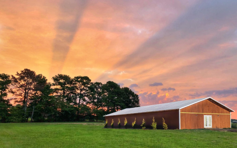

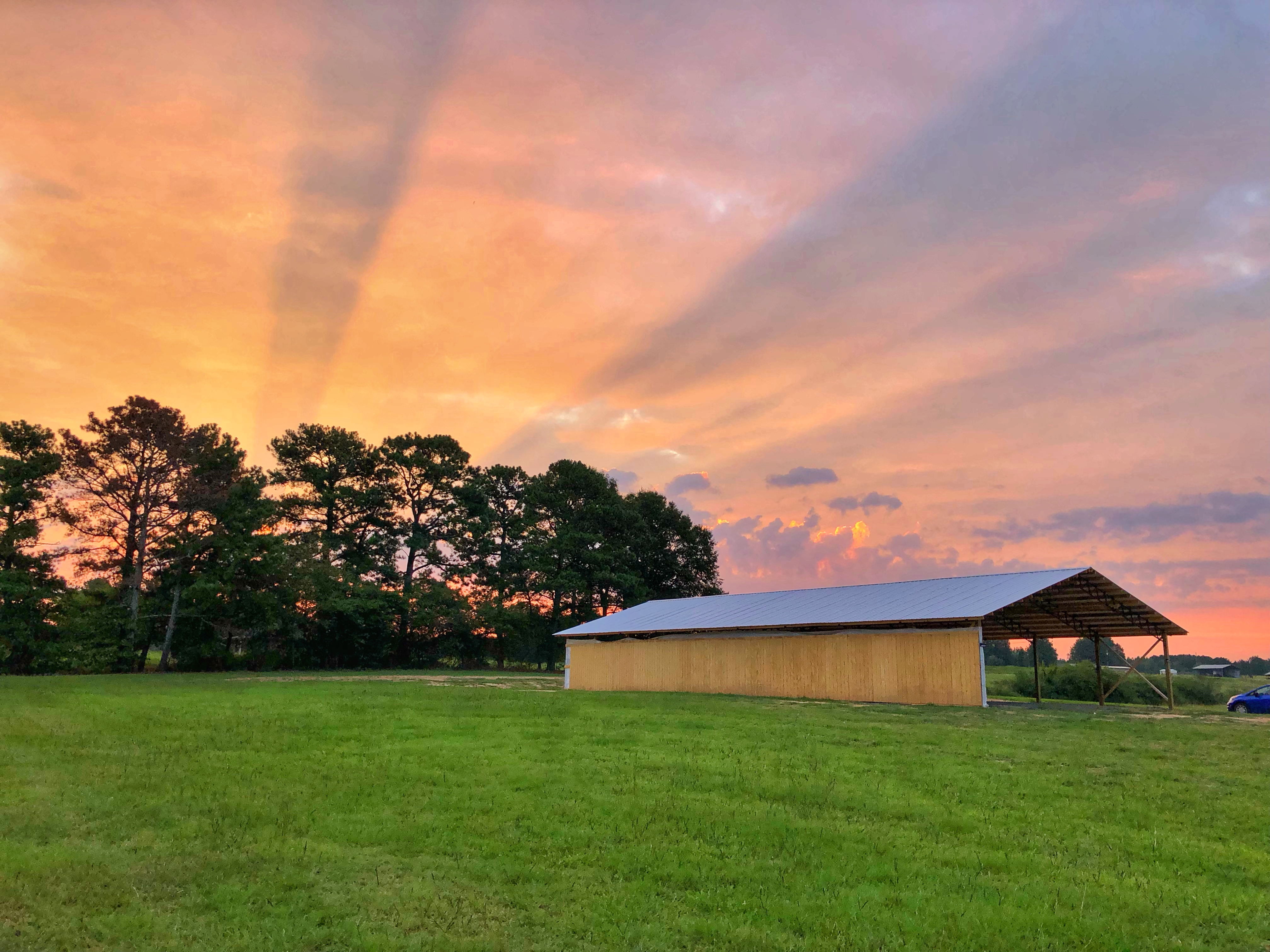

I wanted to give an update on my project, and (of course) ask for advice on how to attach a lean to. To recap, I'm building a wedding venue and had a company do a basic pole barn structure; 6X6 posts and galvalume roof, then put down concrete. This is a 90'X40'X10' structure. I then used T1-11 for the exterior, attached to 2X6s between each post. Had a painter to acid stain the floors and stain the exterior. We just finished insulating and I put sanded plywood on the interior walls and painted white, 1 coat (so the grain shows thru). The final part of this project is a 48'X14' lean to. This will house M/F bathrooms, along with bride/groom suites on either side of the bathrooms. First, let me post a couple of pics.

BTW, for whatever it's worth, I did install cross braces on every corner of the building. I believe that suggestion was mentioned in this thread. Thanks for whoever gave the advice.
