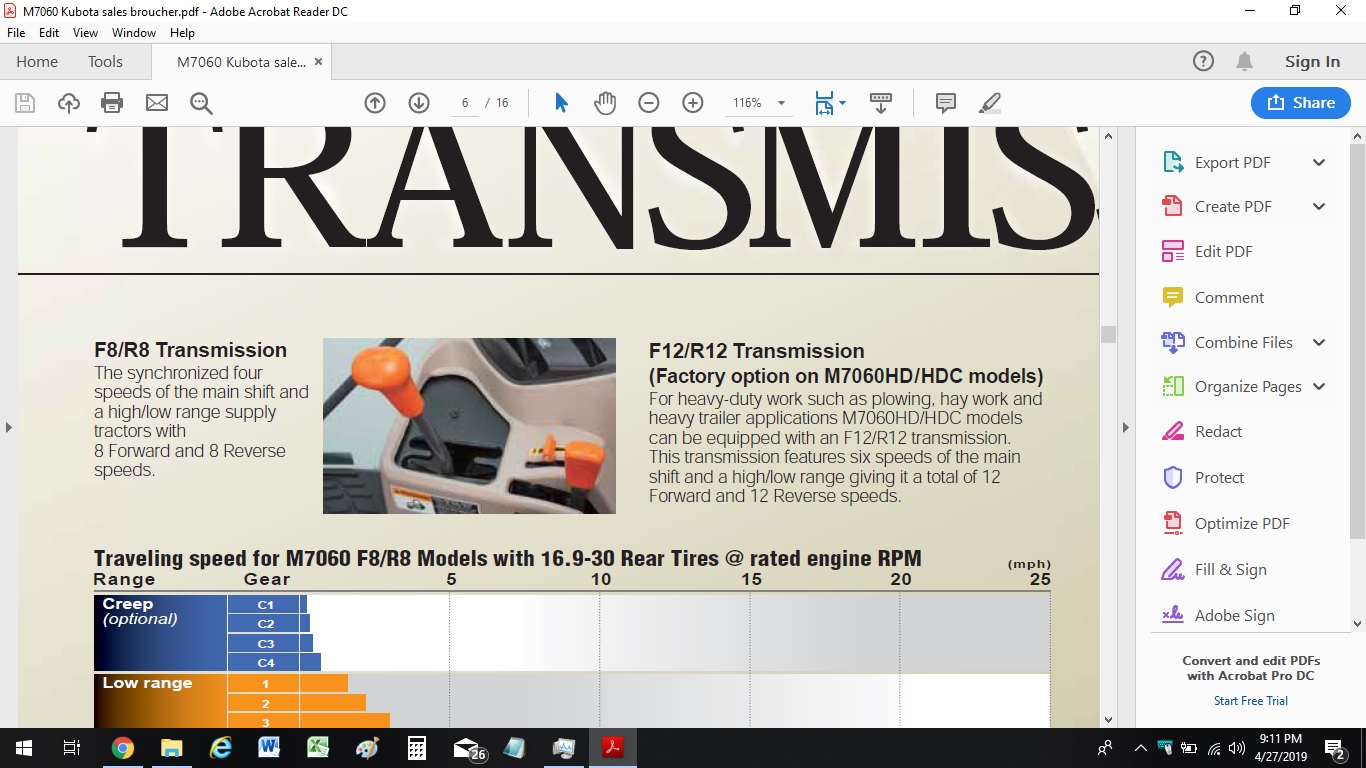

   / Update on Purchase: Kubota M7060 #49
Enlighten me, PLEASE !
The shop manual actually SHOWS a hand brake lever on the left side near the wheel arch, it is NOT PRESENT on US machines, which begs the question; Why is it omitted for the US configuration ?
What you are looking at is the 8 speed trans version. It doesn't have a park selection, but it does have a parking brake. M7060's with an 8 speed trans are indeed available in the US.
