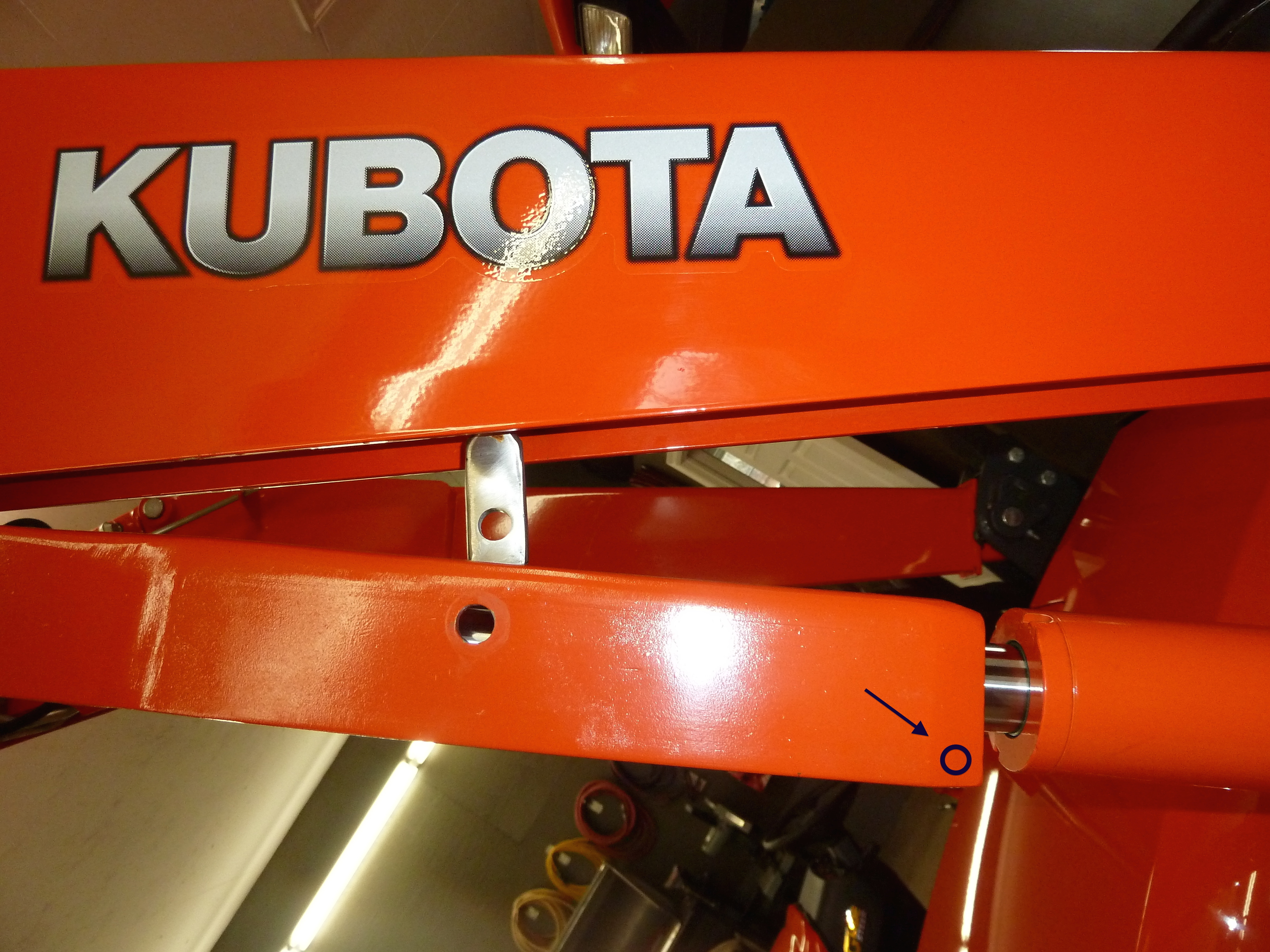

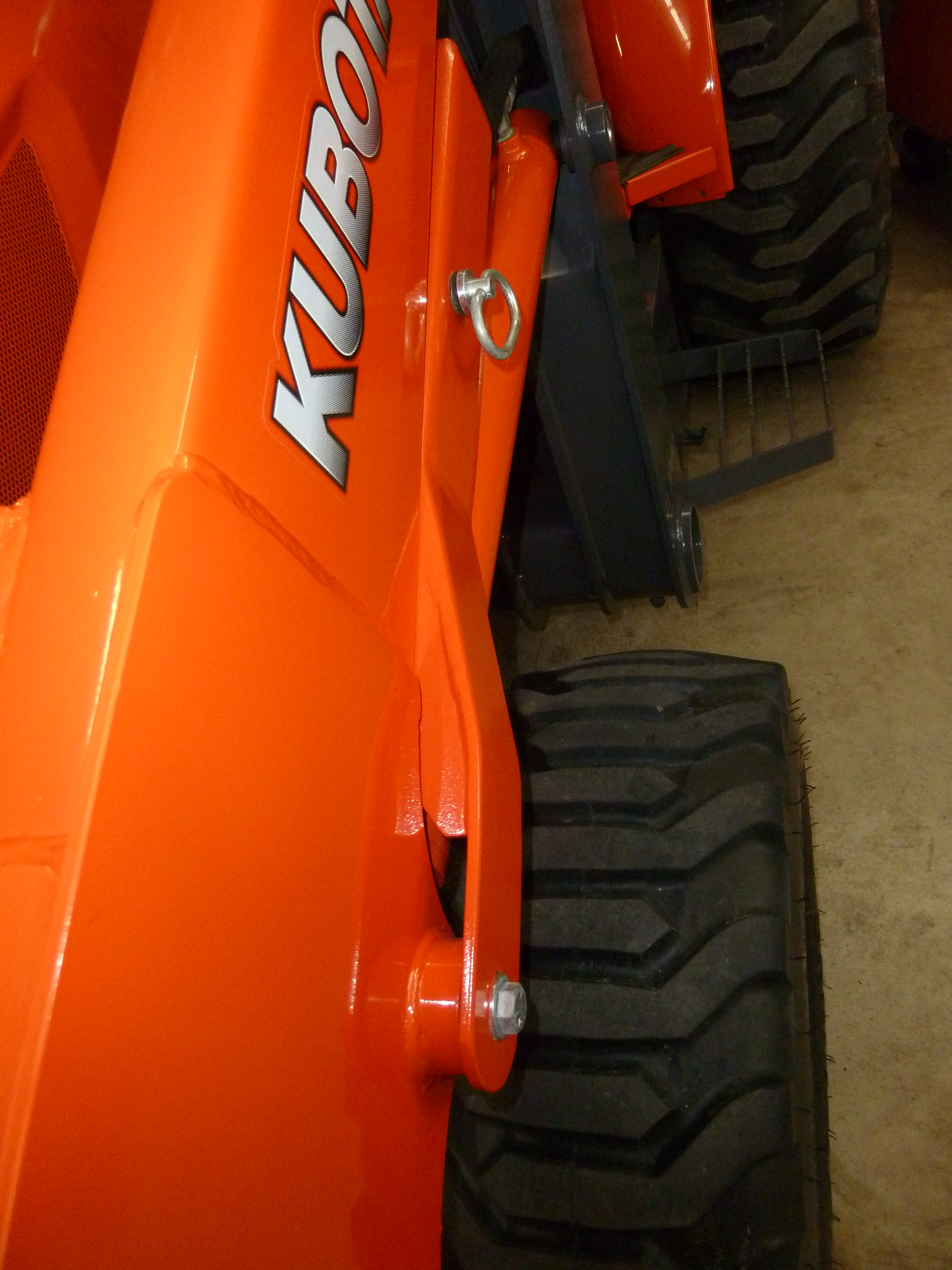

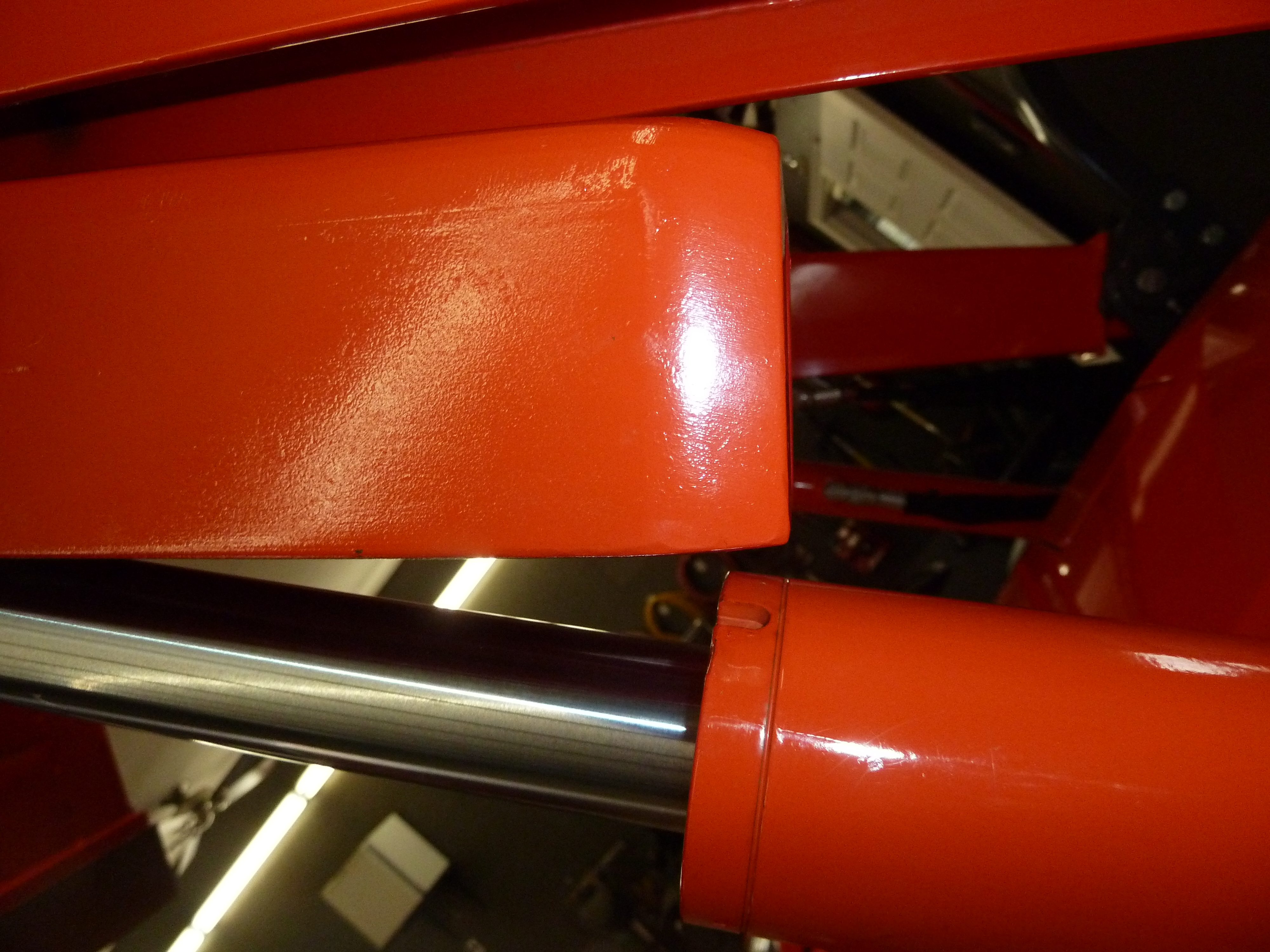

As a matter of interest I have noticed that the orientation of the lift cylinders on the L39 are opposite to the L45.I have noticed this difference on other machines but don't know if there is a specific reason why.One thing about the L45 orientation is it more easily allows for the installation of a safety lock for working on the tractor with the loader raised.I made one for my L45 as they don't come with one.The newer L47 comes with the safety lock.

Here are some photos of the boom lock.The main part is made of 2 1/2 by 1/4 flat bar.The tolerances for this are quite tight and it took more time to make it than I anticipated.There is not a lot of room for error so that it doesn't bind throughout the full range of motion.If you want more info just let me know.
Nice work, although I can't see from the photos how it pins into the "locked" position... Or is it held by compressive force?

It is held by compressive force.Although it will work with the bucket on I take it off first.It weighs about 600 pounds so it would add a lot of force to the lock.I thought about drilling it and using the retaining pin to act as a safety,when in the up position, but didn't feel it was necessary.
If you ever want a more positive lock, there might just barely be enough room to drill both sides of the latch as shown. It makes a handy place for storing the pin when in the safety-locked mode.
