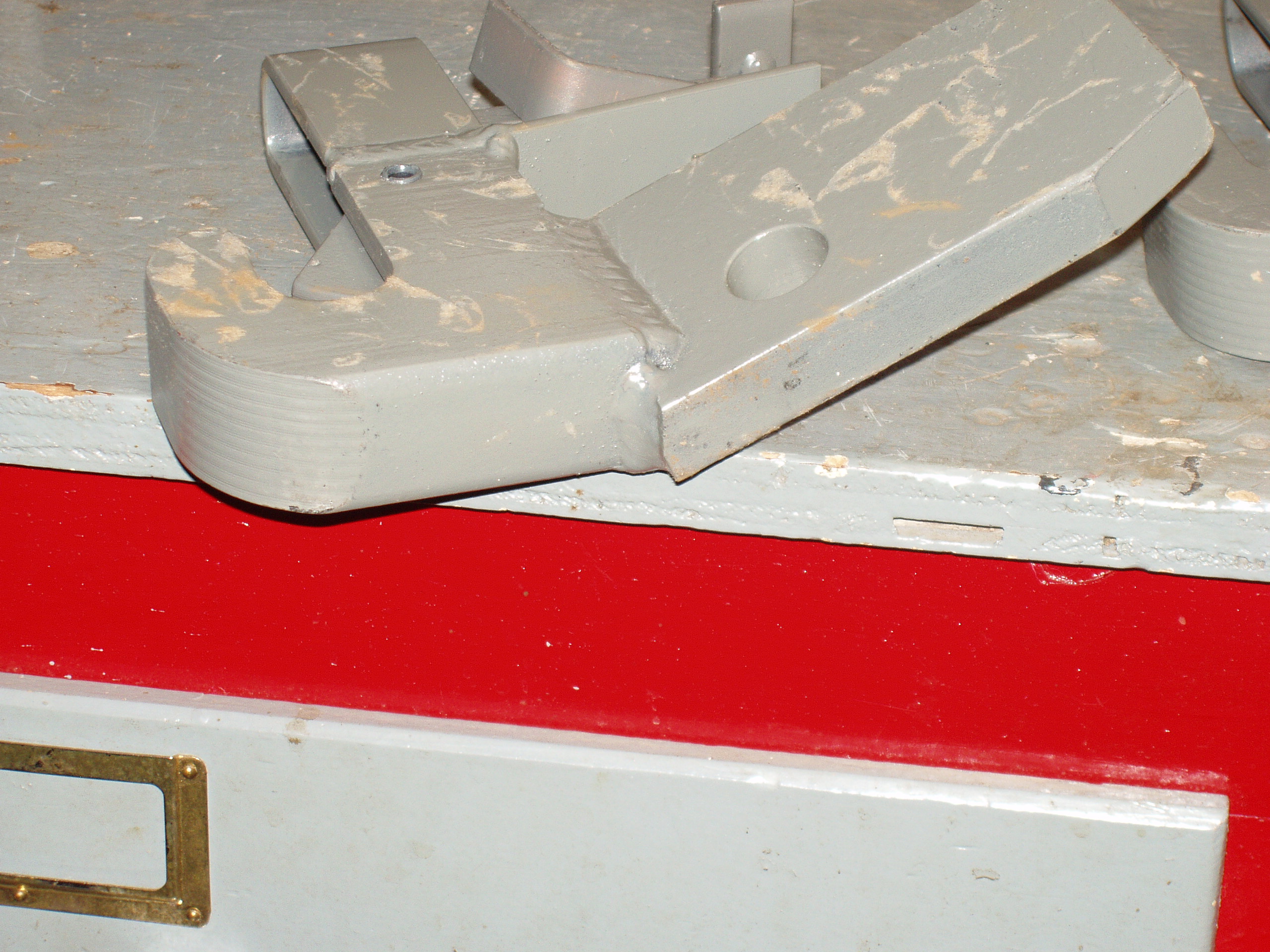

No I did not call Greenwell yet. I wanted to try the U-Bolts other way around first to make sure I wasn't able to use as-is.
I tried on Monday - no way they can be made to fit with any degree of confidence.
Since I bought them through TBN, I wrote for return instructions. Still waiting since Tuesday AM.

Here is a pic off the tractor

I bought a set of extension arms from local Dealer and have weld-on PATS that I will weld on the old extensions. The slide out require 2 in/out to hook up ( out to extend and connect, in to back up to lock, out to connect toplink. The PATS will connect to implement and lock, out once to connect toplink.
I have a big disk and a subsoiler that really give the bolt on PATS a beating. Rest of implements work well on the PATS.
When the subsoiler is 2 feet in the ground and spewing up chunks of soil gallon bucket size, the PATS will move around. Doesn't really matter till I am trying to level a implement and the slack in one side makes it impossible.
This is my choice to have 2 sets of extensions for different needs.
If I am understanding correctly, these completely replace the stock extension pieces. That would make sense - I was expecting that I would need to cut and weld the Pat's pieces onto my stock extensions.

If I am understanding correctly, the Pat's system does not have a tight tolerance as far as precision goes. Not sure that matters for what I use my 3 PT for, but if that's the case, for sure a consideration.
