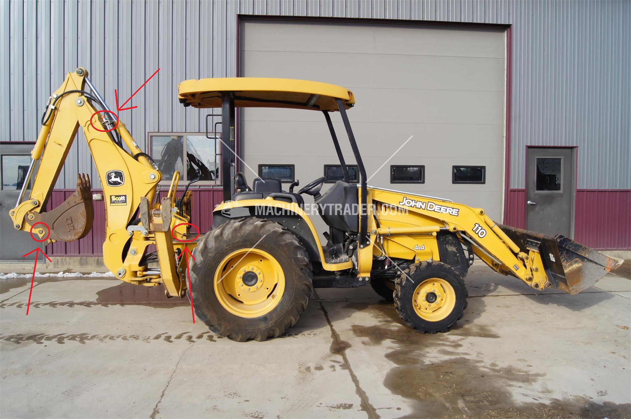

If you look at the 1st photo you can see this 110 is set up for a thumb, it has the quick attach bucket, the foot pedal control and the quick attach couplers.

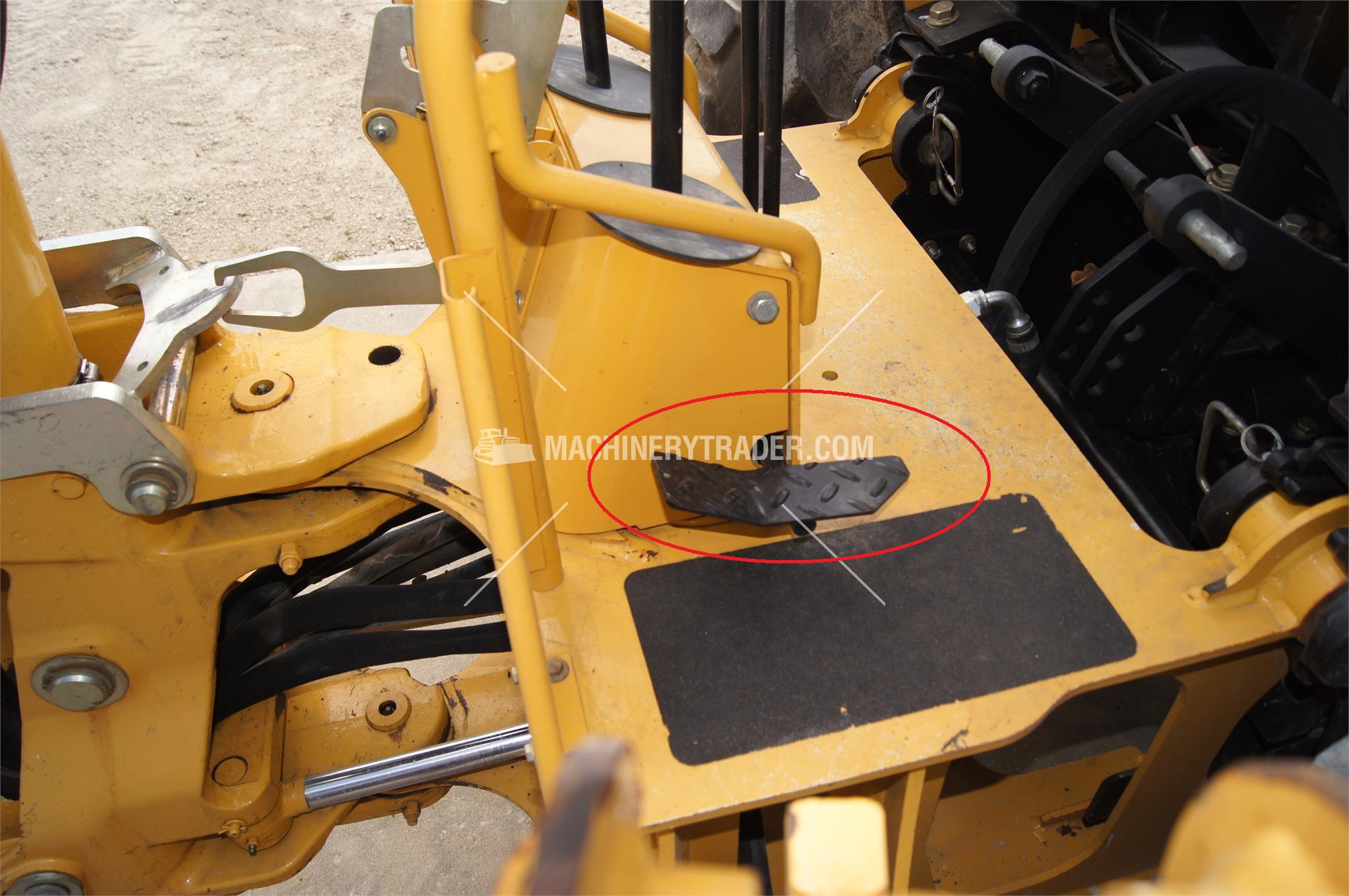

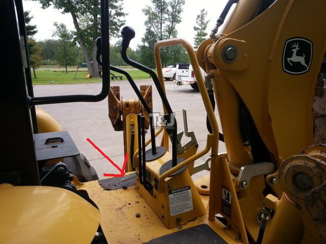

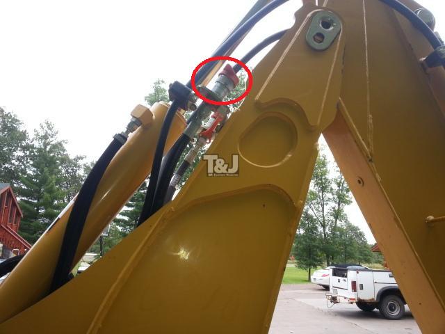

3.jpg the quick attach couplers on the top of the boom near the dipper stick

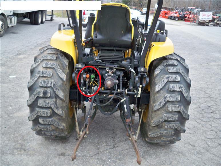

謬op & Tilt Cylinders on 3 point hitch.jpg aux hydraulics (for top n tilt)

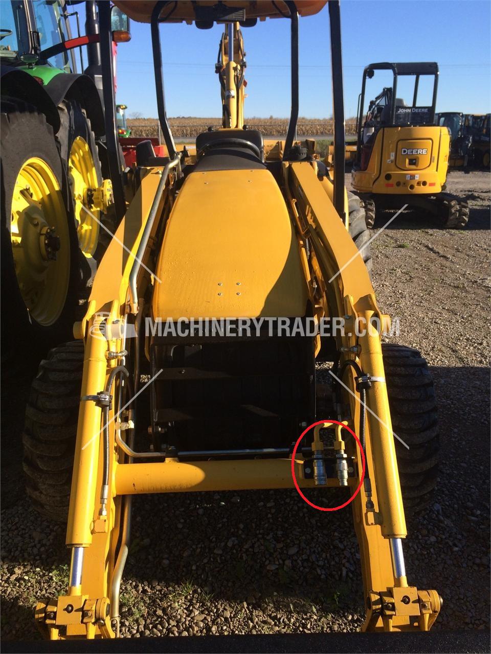

0.jpg front hydraulics
