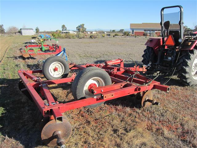

I bought a 13-ft wide tandem (X-style axles) transport disc from my tractor dealer for $600. I cut it down to about 8-ft wide so my Mahindra 5525 can handle it. The disc is a Minneapolis Moline KS-1300 that's actually made by Krause.
Check the disc pans and bearings for wear. It's nice to have scrapers to clean mud off the pans when working in damp soil.
Check the hydraulics (ram, hoses, fittings).
Check the tires for wear.
Check the hole where the hitch pin inserts--the hole eventually gets out of round and may have to be repaired (have your stick welder handy).
Check the mechanism (if any) for adjusting the angles of the disc axles.
For my disc, you pull the locking pin and then get your 5-ft long pry bar, insert it in the open end of the square tube that supports the axle assembly and then walk the axles into the new position. Some of the more modern (and expensive) transport discs have threaded screws or hydraulics do this repositioning.
Good luck
/ Used pull behind disc's #7
Flusher, I think you got a great price on your disc!!!
