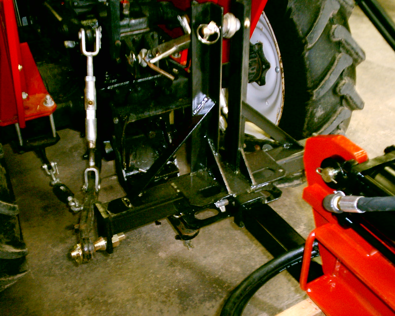

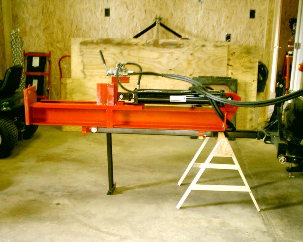

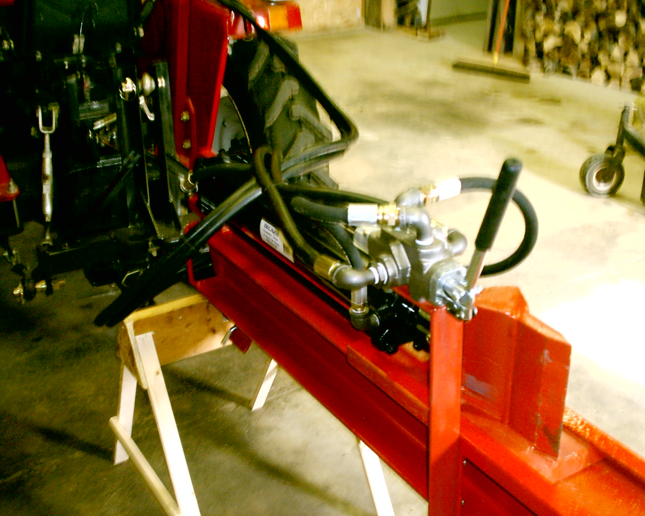

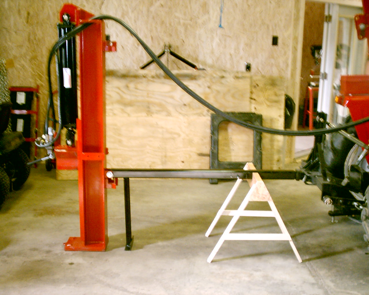

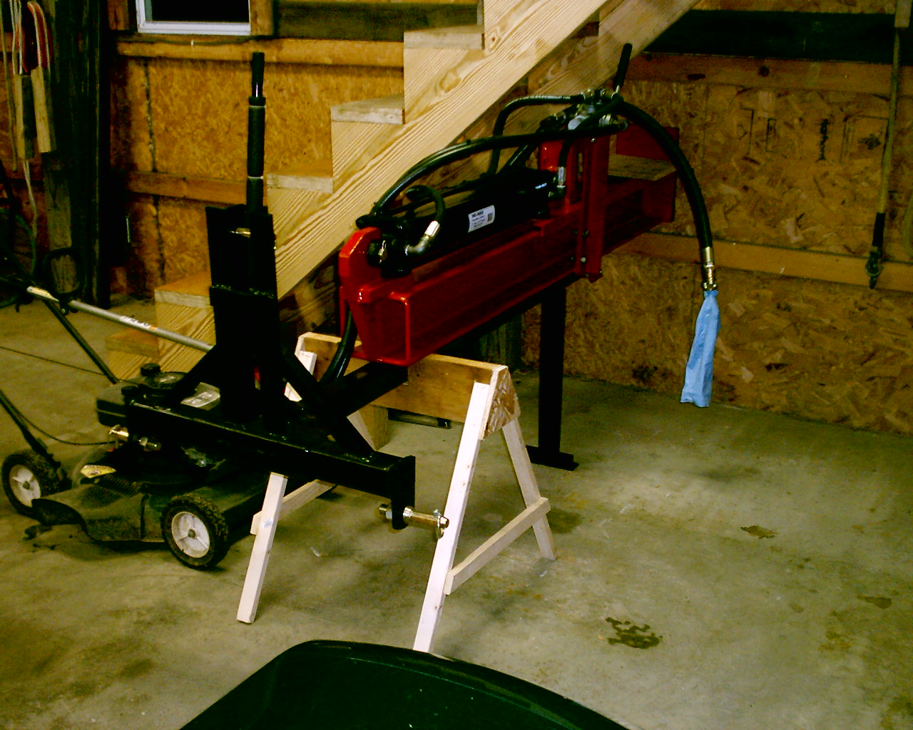

I was looking for a splitter 3 years ago to run off my tractor. I did not like any of the 3 point models I saw so I built my own. Here are my thoughts.
I did not like most 3 point units because they went right to left across the back. That only left one side of the splitter open to work from so I made mine to stick out the back. We usually split with 2 guys, one running it and one bringing over the logs.
I wanted the wedge to be on the ram and put the foot on the beam. I welded 3/8" steel cleats and have never had a log slip off. I also made a plate that can be inserted instead of the wedge so I can use it as a shop press. Real handy.
I wanted horizontal and vertical ability.
Here are some pics. I have about $425 in it and did all the fab work myself, tacked it up, ect. All the welding that if it broke I could get hurt I left to a professional welder. Cost me a case of Bud Light.
