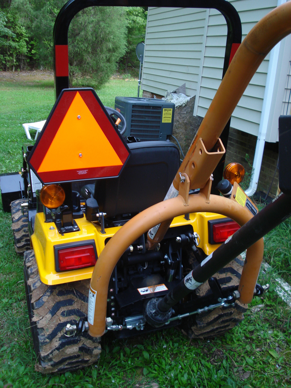

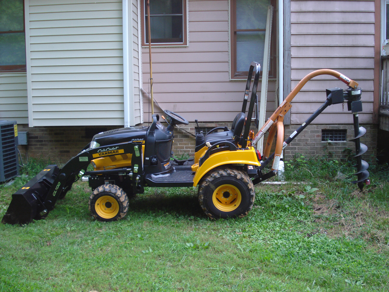

Using a Posthole Digger on a CCYanmar Sc2450 ?
Has anyone used one of the 7200 JR Posthole diggers on there SCUT ?
I own a CCYanmar-Sc2450 and thinking about getting one... but also thinking (smoke) if the tractor will lift the Attachment high enough for travel and removal from the hole.
I watched the video from EA.com about the fitment but they do not show a SCUT using it just a larger framed tractor.
Anyone have an opinion on this ?
Thanks for reading and for any opinions.
/ Using a PHD on a CCYanmar Sc2450 ? #2
I haven't used that one, but I have a woods phd 35 on my Sc2400 with a 42" L x 9" diameter auger, I think it is.
I want to say that there's about 6" or so from the point on the auger to the ground with the 3pt at it's highest settings. When I have it on and I'm driving around with it, I tend to keep an eye on it though as the point will drag the ground depending on the level of the ground. I've used it a couple of times and the Sc2400 seems to handle it just fine.
It looks like the 7200 JR will fit on the JD2305 so I don't see why you would have any problems on the Sc2450.
http://www.tractorbynet.com/forums/attachments/119427-leinbach-7200jr-phd-power-take.html
The pics look like it will work, I will check out the size difference.
Yes I looked at that vid but I didn’t know how the two SCUTs matched up.
Thanks
/ Using a PHD on a CCYanmar Sc2450 ? #5
i have a yanmar 2000 and have used my neighbors PHD that is from tractor supply company. I can clear the hole and road when lifted up to move around as well as lower it to as deep as the auger will go.
