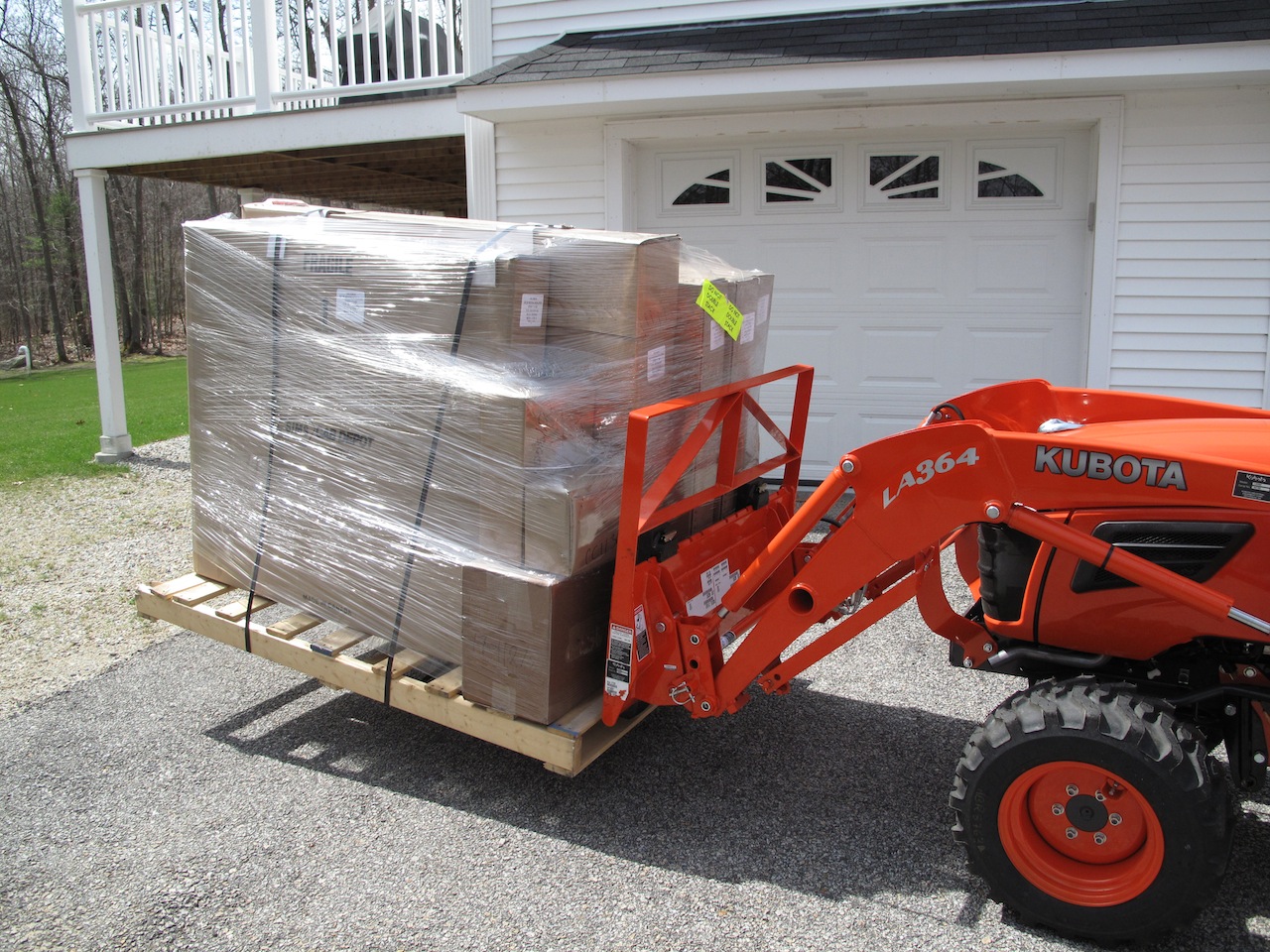

Here's a picture of the QA I have installed on my B2620 along with the Kubota pallet forks. No modifications are needed to install it - it's purely bolt on.

The QA from the 504 works on the loader for the B2320, B2620, & B2920. From my research, the loader frames for the 304 & 364 are identical. It's in the hydraulics where the 364 gets a bit more capacity. I'm not sure about the 504.
