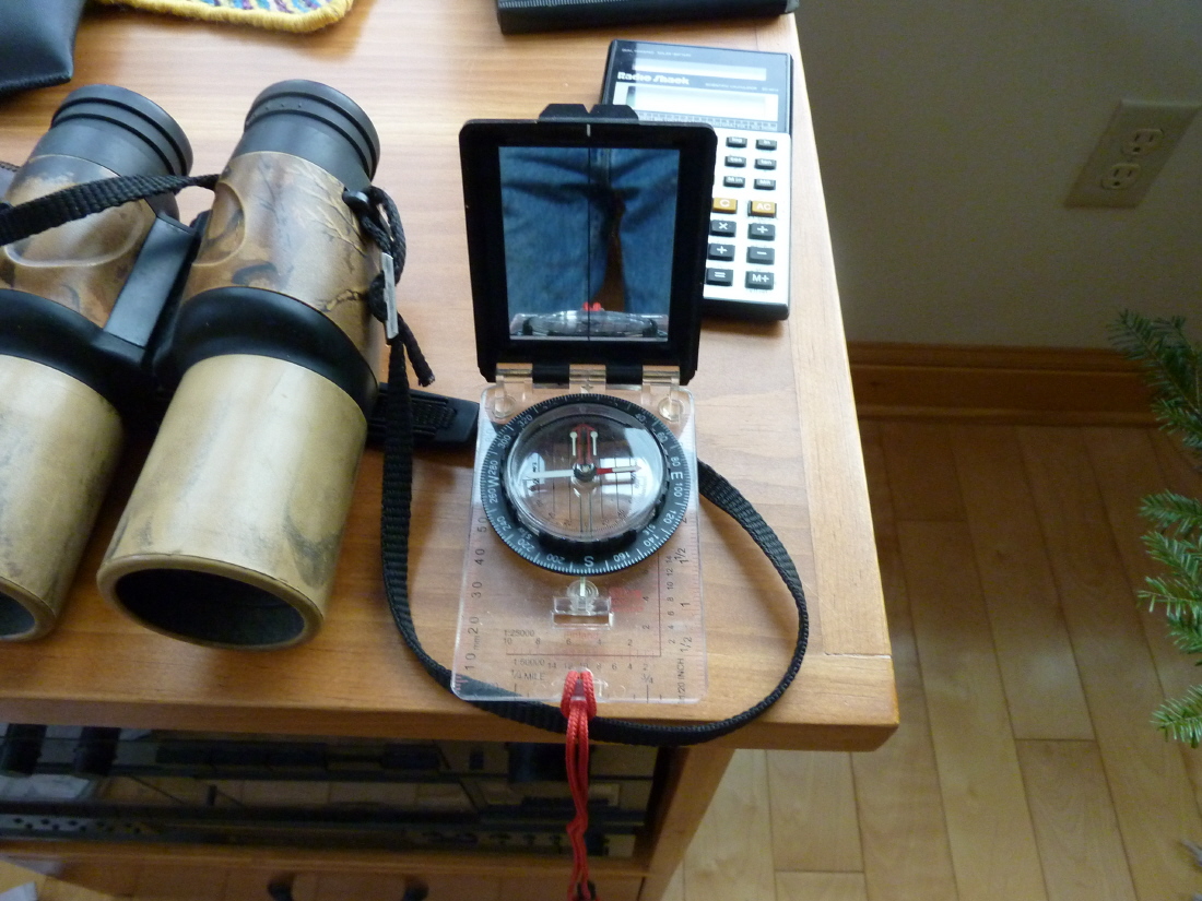

What dmccarty and Eastinlet say is good advise. Around here boundries are flagged all the time for logging operations by the land owner or forester with a compass. This is a Silva Ranger with a sight, not expensive, but with a little practice you can flag a straight line. Your surveyor who found the pins may be able to give you a magnetic heading from his field notes.
