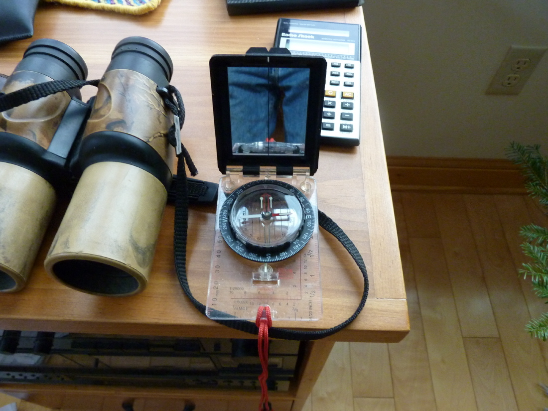

Boundary surveys -- or more properly boundary line location -- are part of my forest management business, but I am not a licensed surveyor and stay away from anything beyond my abilities and expertise.
First, as others have suggested, a homeowner grade GPS is of no value here. If you have known reference points, pins, corners, etc. and a deed description that includes bearings and distances then you should have little problem establishing a line. Provided the corner pins are located where they belong... I have often seen landowners move them around to suit their wishes.
You need a good compass such as Silva, Suunto, or Brunton adjustable for magnetic declination. They will have a mirror for sighting, and properly used will be accurate to 2 degrees or better. Dial in your bearing -- be sure to note whether the bearing is true or magnetic north -- and sight as far away as you can. Hang flagging as precisely as possible to centerline. Move up to the flag and repeat. When you get to the corner turn around and run the line back to starting point, adjust flagging to reflect the average line center. Look carefully along the way for supporting evidence, i.e. old fence, pipes, blazes or paint on trees.
This is not precise, but you will be surprised how close to true a line is when done carefully. I run lines in the thousands of feet to miles range and make them work out. I appreciate the problem with the neighbor, it is not uncommon. It can be helpful to ask him to meet with you on the line, walk it together and show him the evidence and flagged line and pins. Be cordial, he may agree with you. If not, you can still have it surveyed.

What dmccarty and Eastinlet say is good advise. Around here boundries are flagged all the time for logging operations by the land owner or forester with a compass. This is a Silva Ranger with a sight, not expensive, but with a little practice you can flag a straight line. Your surveyor who found the pins may be able to give you a magnetic heading from his field notes.
