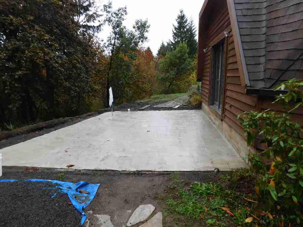

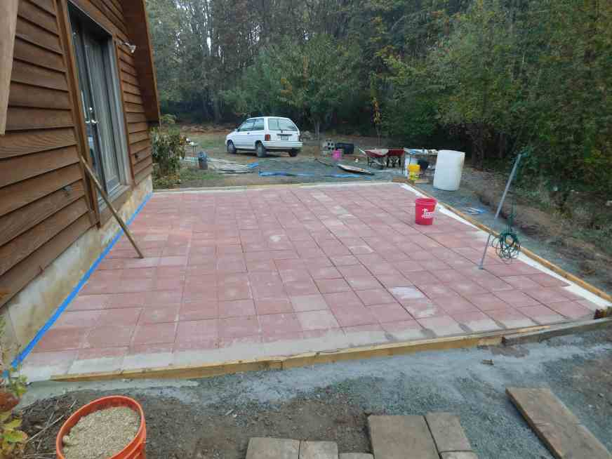

We are also attempting to create a space that looks like it is ancient. So, artistically, perfection isn't the goal. The below pic looks like I've made a valley,.... this is a lens effect. :)View attachment 768604
Patio looks like a nice spot to relax, that will hold up just fine. But I mainly just wanted to say, that Festiva is amazing. Not even rusty?
One of my best friends in high school drove a clapped out festiva for years that he got for $50. Then sold it for the same $50 a few years later. Yours looks like she's worth at least double that, heheee.

This is the finished base that I'll be buttering the pavers to. On post #9 you can see how I used the older cement-all, as retention backfill. The clumps didn't matter with that use. :)
Good eye Deezler on spotting the Festiva. Most people think its a Metro. Its one of the best cars I've ever owned. Cars don't rust out in the PNW, cause we rarely salt the roads in the winter. I get offers all the time, cause they were so light, and good shells are highly sought after by racers.
