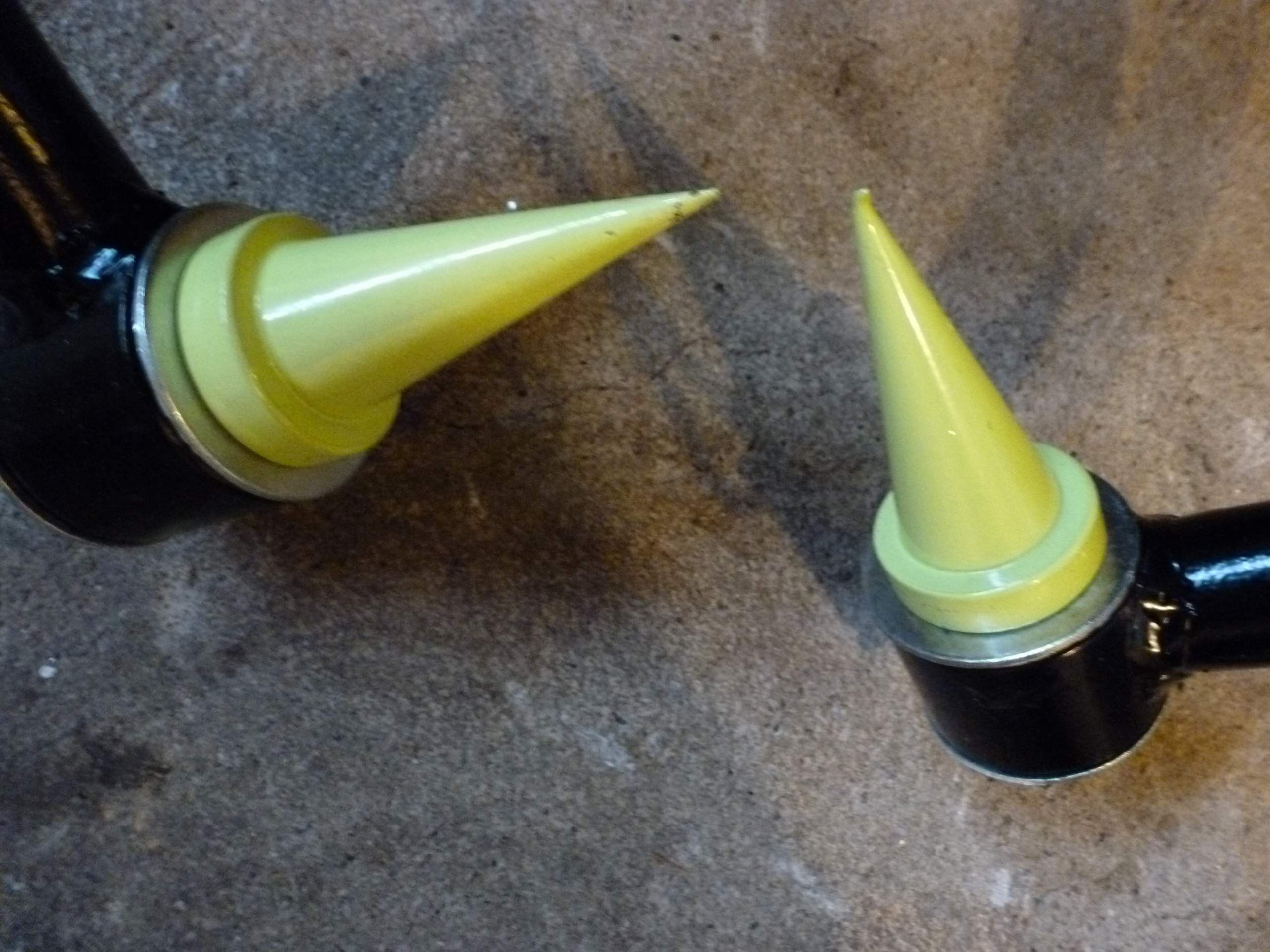

I've always used a chain to wrap around a downed tree but sometimes it's hard to get under the tree.
So I invested in this pretty heavy duty tong, which has fairly sharp points on it.
Never used one before. If the wood is a little soft, will this bury itself in so it's hard to get it off the log?
Does one need to carry a mallet or hand sledge?
Just wondering what downsides there are to this gadget, if any.

I use an old set of tongs all the time.....never had a problem getting them out of the log. The points on your tongs look a bit sharper but shouldn't be a problem. If they do stick....a light tap should solve it.:thumbsup:

Yes, carry a small sledge or "engineer's" hammer with you. A quick rap below the chain hook will quickly drop the points out of any log.

They do work well if used gently. Don't need a hammer as the points are fairly sharp.
