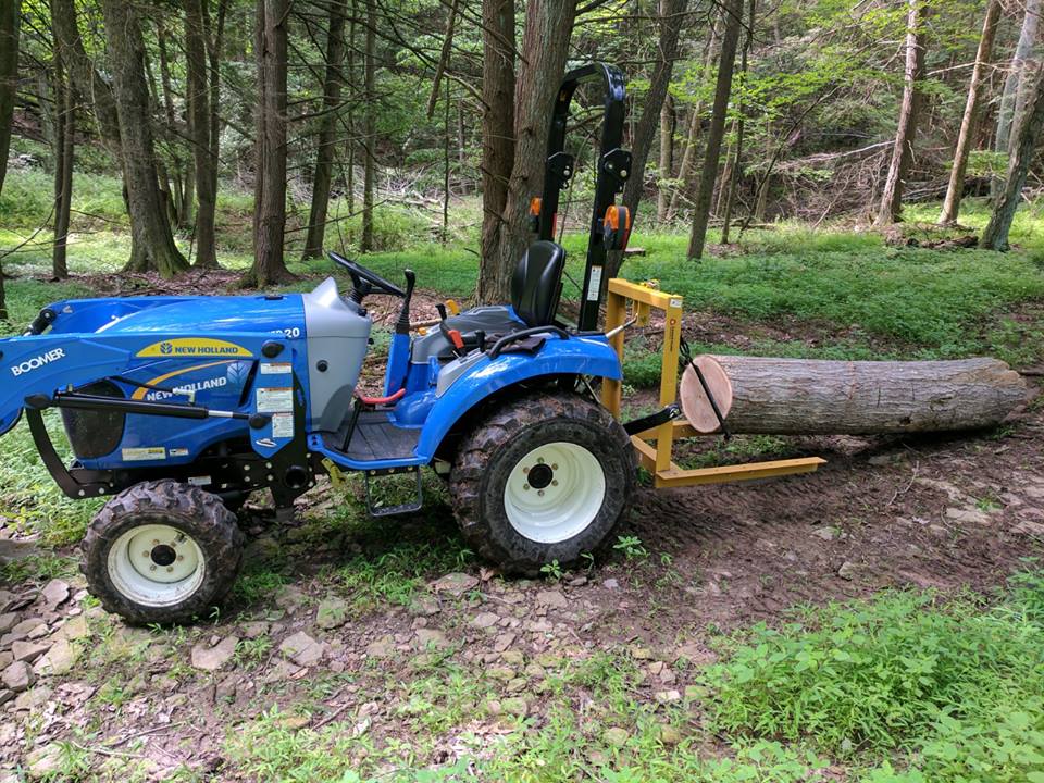

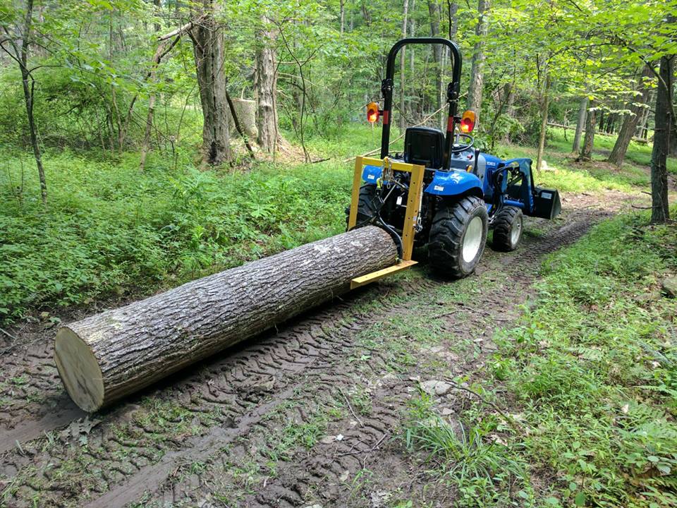

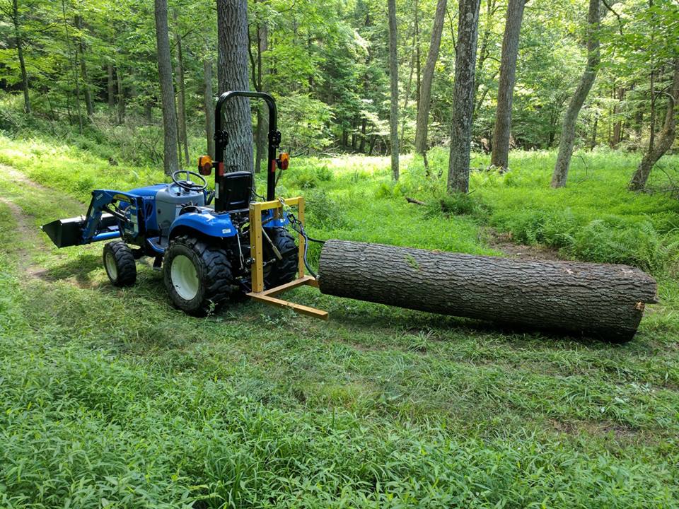

I use my carry-all in a similar way. I welded a hook on the upper part of the carry-all frame and use log tongs with a short piece of chain to adjust the height. These are some red oak logs I recently skidded, the biggest was 21" at the butt. That was about all that tractor wanted to handle.View attachment 535310View attachment 535309View attachment 535308
Thanks for the post and sharing your pics of your Boomer at work -- very nice!! My 2540 Mahindra is a bit larger than your NH, and 90% of my logs will be in the 6-12" range, so if you're able to safely haul much larger ones with yours, I think I'll be OK. I only need to haul them up to 50ft and I can go slow, so I should be OK. I just need to figure out if the receiver on the ballast box will be high enough to skid with the grapple tongs. I haven't bought the ballast box yet, so maybe doing what you did with the carry all makes more sense.
