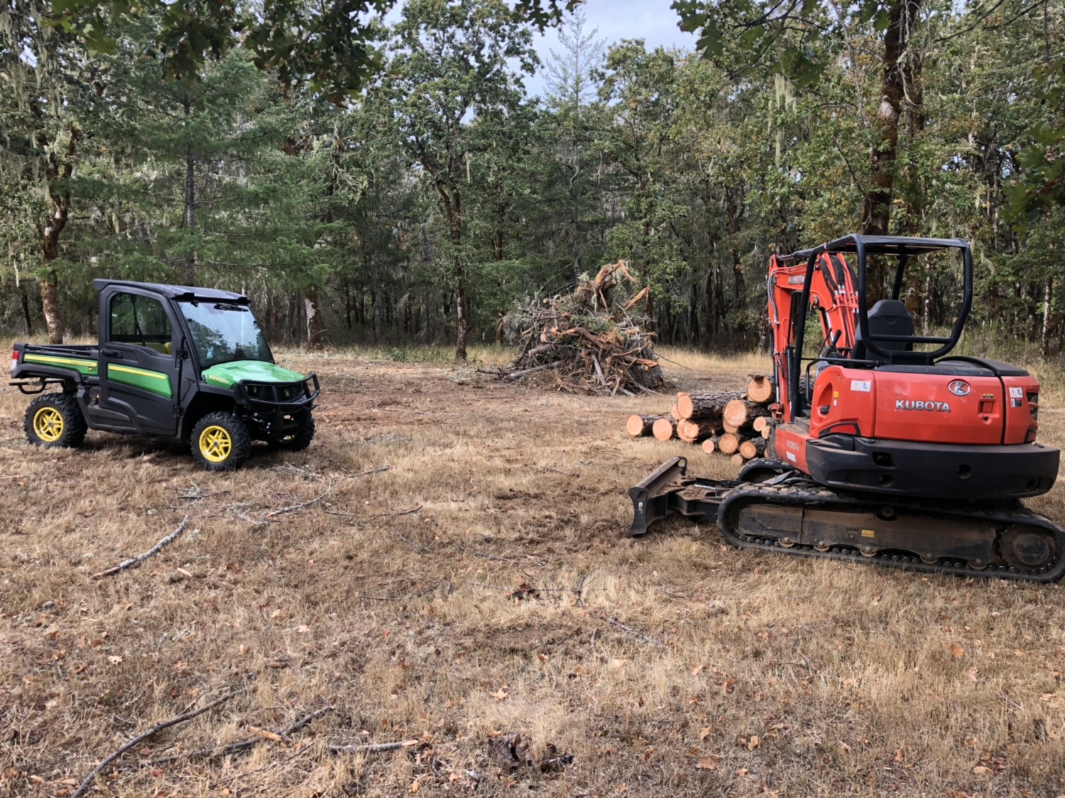

Just received a message from my dealer, arriving today at my home a new JD Gator XUV835m with hvac. Will compare my current kubota x900 and the 835 after a few weeks.

Do you think comparing the 835 to the 900 is fair comparisons, maybe a 1100 would be better , but hey no 1100 close by to compare

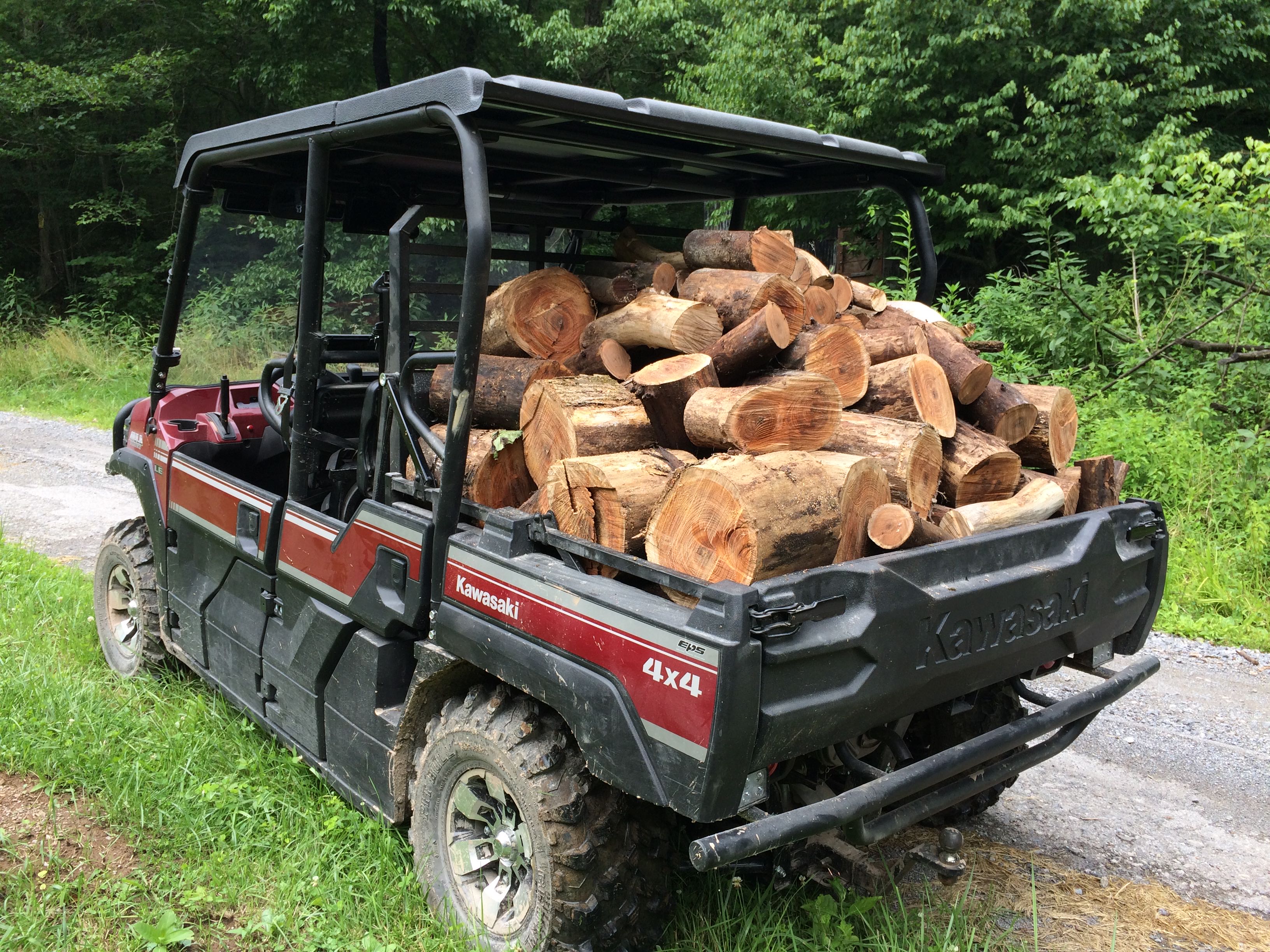

Honda makes gas, "non CVT" sidexside.That being said I have owned belt driven ATV's and Side x Sides since 1998 and never replaced a belt.I didn't care for the Honda's myself.We have two Yamaha Vikings,a 825 JD and a Kawasaki Terx in the family and they all have been good machines.
