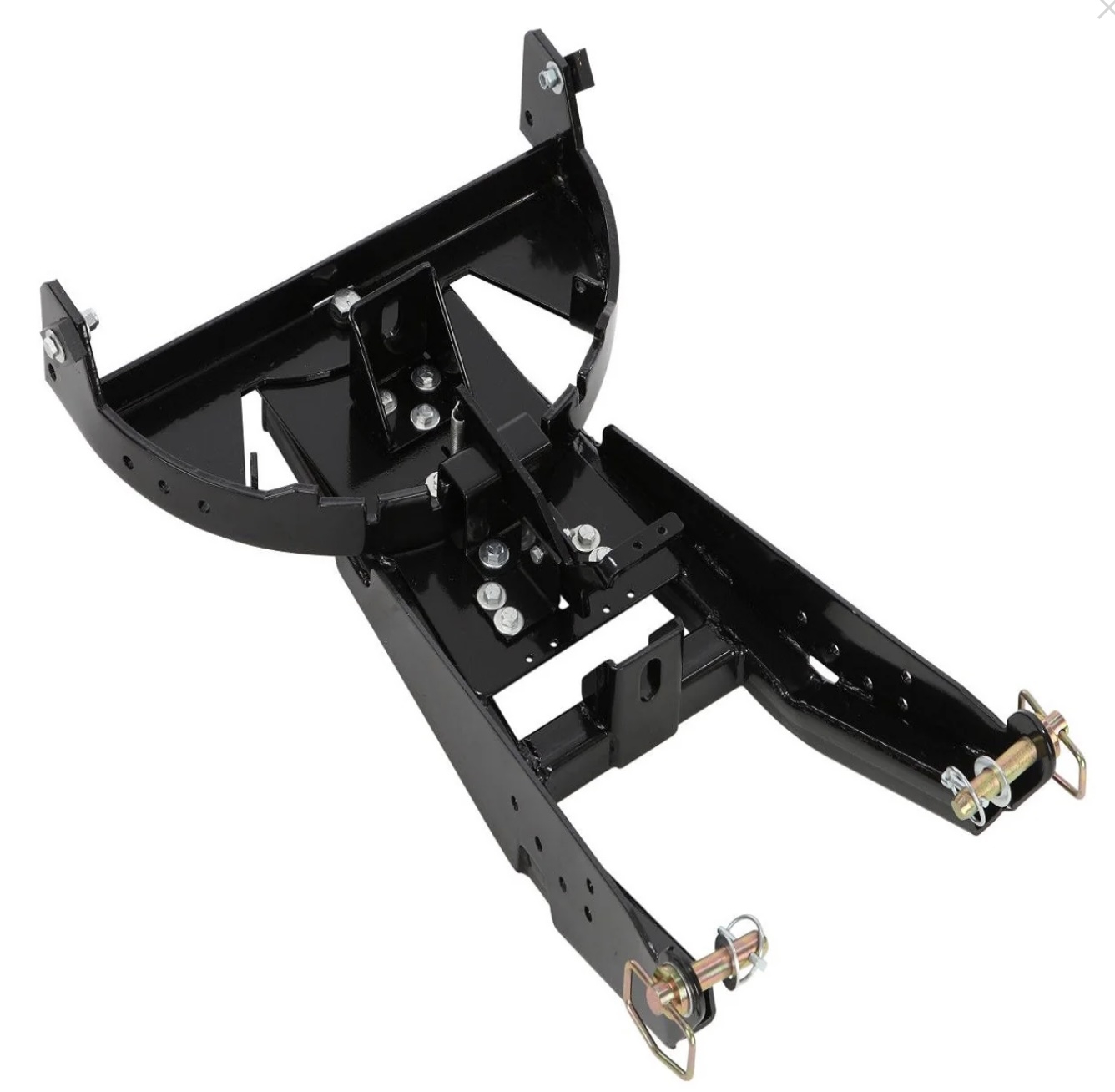

Ours looks like this (as far as I can tell anyway)
That looks more the like current model KFI (because of the square tubes along the corners).

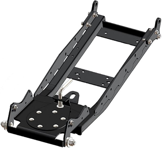

The Denali mechanism looks like this:
