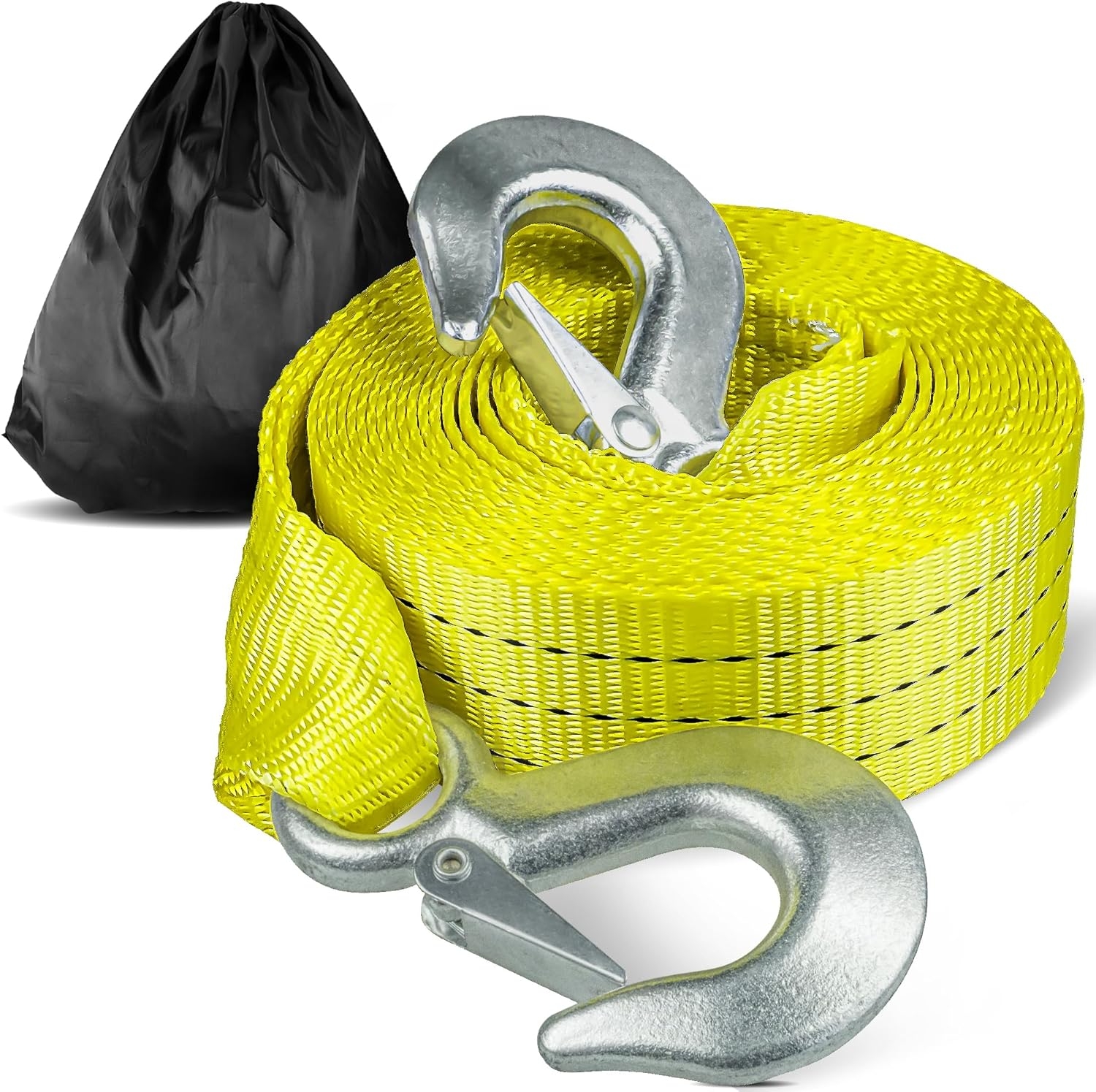

I don't know how your Ranger is setup for that plow, but with my Sportsman and the Glacier Razor plow, it used the winch to lift and it has a roller fairlead. After a winter it broke the steel cable. I then switched to synthetic rope and it didn't last any longer than the steel.
So I just use a cable clamp now to re-tie the hook every time it snaps.
So every winter I have a bit less than 50 feet of cable, LOL
Switching to a strap instead of the cable will take care of that, but you do need to switch back when you want to use your winch for actual winching. The strap is only about 5 or 6 feet long.
   / UTV Snowplow choice? #32
I switched to a 10ft strap and never going back to cable ever, even in the summer. I get about 2 years of snowplowing before it breaks. No big deal. I believe they are 20ft, 8000lb towing straps and I cut in the middle. Like this.
   / UTV Snowplow choice? #33
I looked at doing that, but did not have a good option for attaching the strap to the drum on my winch. (Not sure I wanted to trust the duct tape method). How did you attach yours?
I also need to switch back to cable in the off season, since I need more than a few feet of each on the winch. (The bigger jobs get the 3 point hitch logging winch on my tractor, but it’s convenient to handle the smaller jobs with the UT, if that’s what I’m on when I happen to run into them.)
   / UTV Snowplow choice? #34

I looked at doing that, but did not have a good option for attaching the strap to the drum on my winch. (Not sure I was to get it it’s my wife’s trust the duct tape method). How did you attach yours?
Ha! I cleaned the drum and used exactly that. Been holding for like 6 years :LOL: (do replace the strap every 2 or when it breaks) Duck tape does fine.

Is your winch cable synthetic or steel?
I ended up going with one of their Plow Straps, rather than using the cable on my winch. A neighbor who has been plowing with his ATV for years mentioned that he does wear the end of the cable more quickly: it's a lot of in and out motion over just that last short length of cable, and depending on how your angles work out, it can be a sharp bend. Replacing the cable with the strap is supposed to hold up a lot longer. The downside is that you have to change from cable to strap at the start of snow season, and back again at the end of the season. The strap is also only 64" long, so you lose the ability to do longer winching while it is in place.
I also added the optional plow strap roller. It mounts down on the push tube. The strap runs down from the winch, around the roller, then hooks on back up on the bumper frame. This cuts the line speed in half on the winch (as well as reducing the load by half, not that the plow is a heavy load for the winch). The diagram at the link probably describes it better than I am. If you like that slower action on the lift, but don't want to go to a strap, you can do the same thing with one of their plow fairlead pulleys (These can mount on your fairlead, so the cable does not bend as tightly, or down on the push tube, where it works like the strap roller.)

We push snow with our atv type machine every winter 3 to 5 days a week. Today I'd take the original cable off first thing and replace with with a 2" flat tow strap.
