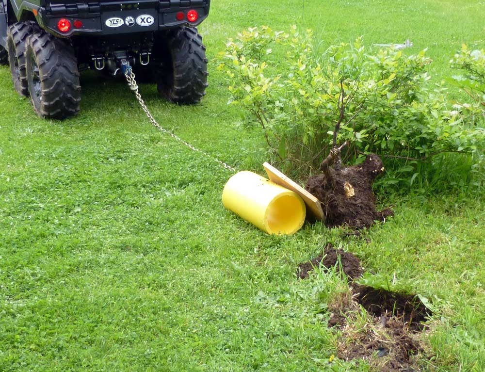

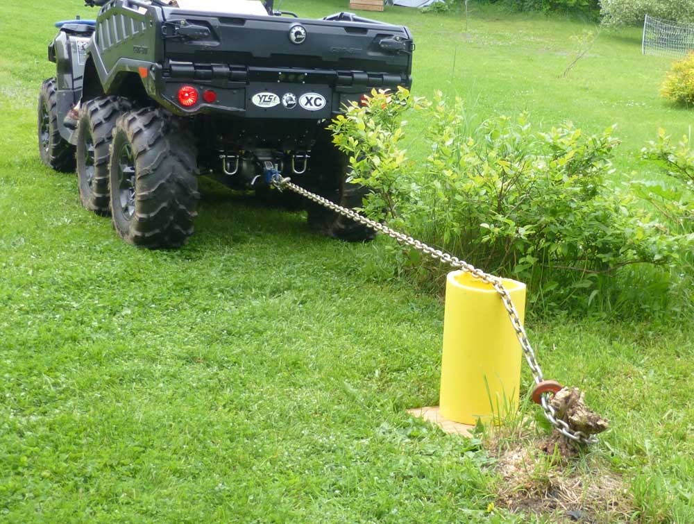

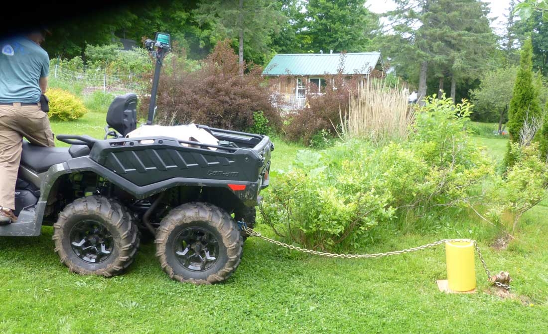

No grunt, no spin stump pulling today. Kinda did think it would fell like towing.

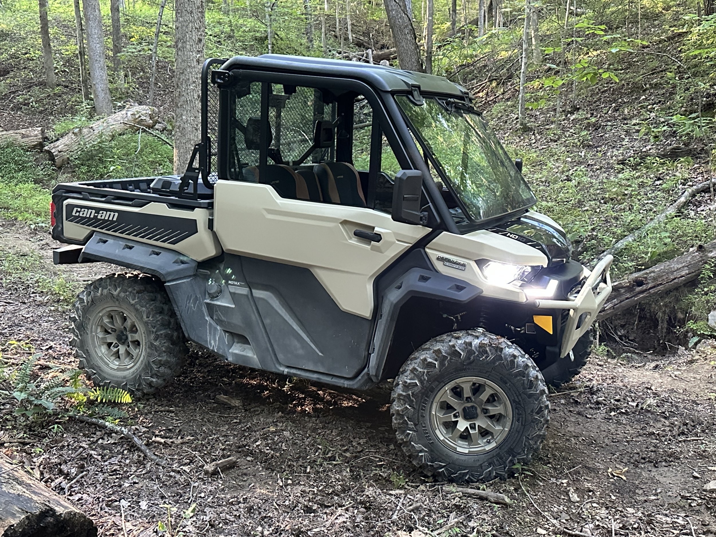

I needed to check where I have to install some drain pipes to make it easier to get the tractor through the woods. Figured it was much easier to jump in the SxS and make a loop around.

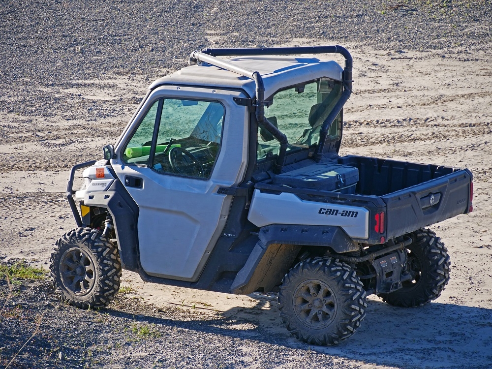

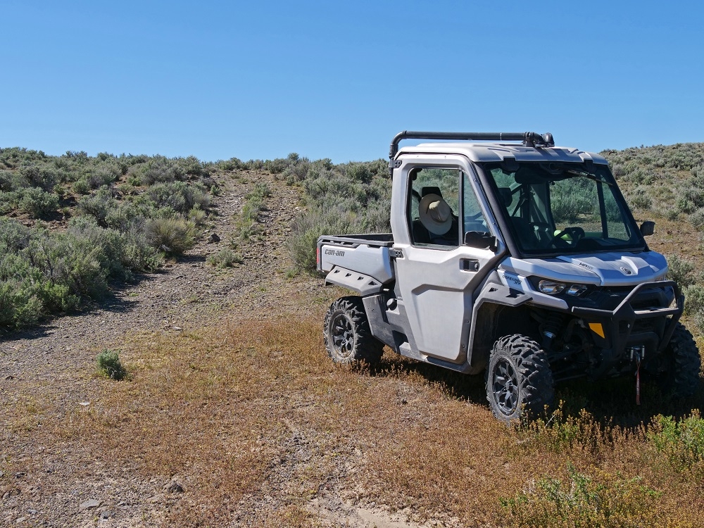

Been using my Can-am pretty much daily around my place. Putting a lot of miles on it. Can't believe how handy it is, hauling stuff around, spraying Mormon crickets, spraying weeds. Love this thing!

Nice! I think I just rolled 100 miles tonight, only had it for about two weeks. It is a nice machine, with a great ride.
What is the pipe on the roof, I never saw anything similar.

Mine had nearly 4000 miles on it now.
There's actually 2 pipes up there. One of the things Can-am could have done better(at least on this particular year/model) is the location of the OEM air intakes. Both intakes (belt and engine air) are under the bed of the unit. Here in the desert, this time of year a lot of the roads and trails develop silt beds - very deep, very fine dust. All that dust kicked up by the tires gets sucked into the belt chamber and the air filter housing - it can completely plug up an air filter in 20 miles of driving. Can-am sells "snorkel" kits that move the air intakes up high - but they are super expensive and obstruct the view through the rear view mirror. So I made my own "snorkel" kit using 2" ABS pipe. Only cost a few bucks and now both air intakes breathe from the top of the windshield. Since I made this mod I've not had to clean out either the belt chamber or the air filter. It may look weird...but I don't care!

I could get used to the appearance, especially knowing what it does.
