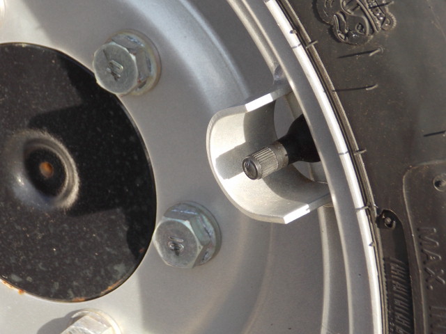

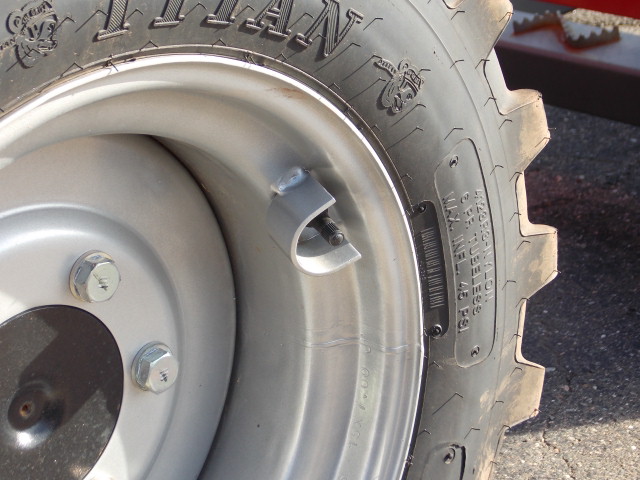

I drove by a red tractor dealership today and noticed valve stem protectors on some of their wheels. I was told that the protectors are being offered on their big tractors only. Hating flat tires, I think this is a wonderful idea.

on my compact Kubota B2620 has the exact same design.

Most of the ones I see are homemade. People just use steel pipe and weld it to the rim. They leave the end threaded and screw a cap to keep dirt and mud from packing in. I figure once my wheels fade I'll probably do it to my wheels. If you have your tires loaded it makes it more complicated.

My first Kubota, B2910 had them. My second Kubota, L4400 had them. My latest and biggest, M9540 does not....... Go figure.....
/ Valve Stem Protectors #5
Like ovrszd, our medium size Kubotas have them but not the big one.
/ Valve Stem Protectors #6
My DK35 has them. They quite possibly saved me a lot of grief when I bogged it down in a creek bed last spring. The rims were full of heavy mud which may have otherwise ripped out the stem.

If you do decide to weld your own on, DONT do it with the the tire under pressure. Deflate it, pull the valve stem, and probabally wouldnt hurt to un-seat a bead. They can blow up if you do not.

My Grand L 3540 has them, and even my B3200TLB had them too.

I purchased my L4400 new 1 1/2 years ago. I don't have them. Are they attached to the rim at the factory? I have never seen them before. Thanks for posting.
/ Valve Stem Protectors #11
They put them on the industrial tires but not the ag tires.
/ Valve Stem Protectors #12
My Bobcat CT235 had them on all 4 tires the L4240 just has the on the front but the rear valve stem does not stick out that bad.
