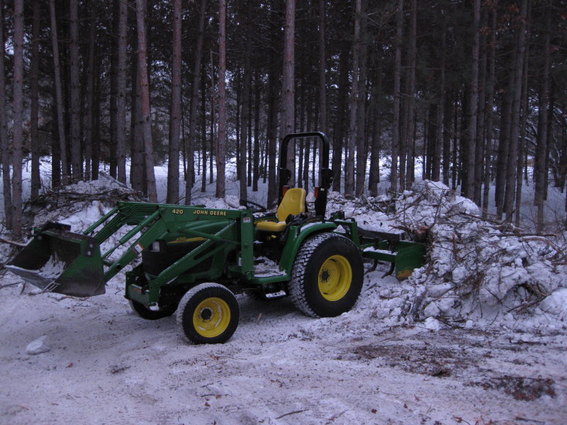

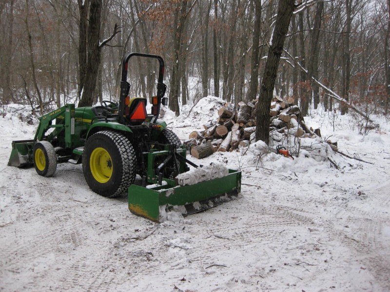

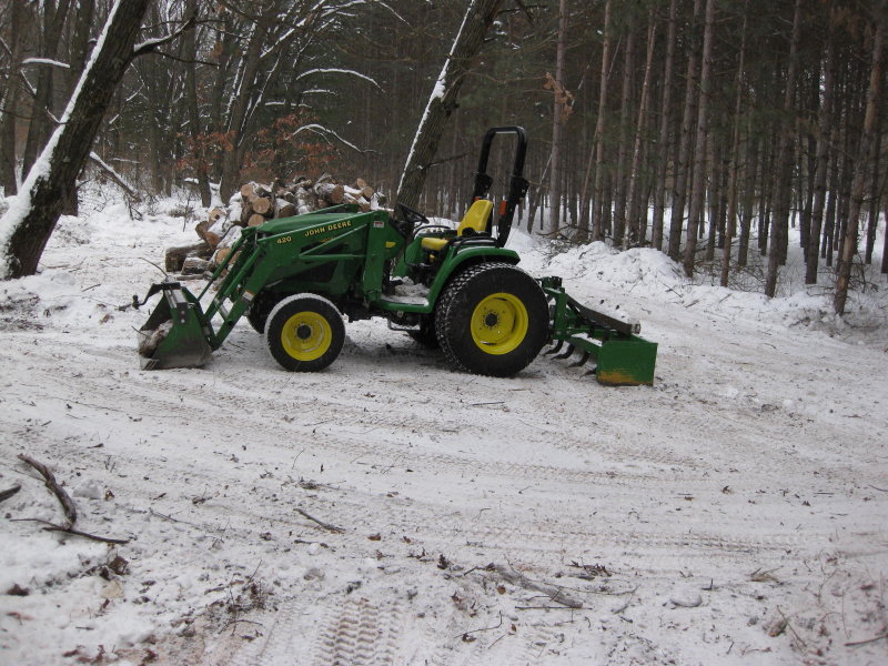

I started using mine for cutting wood. I should say clearing a spot to drop a tree. No more cutting wood in snow up to my knees :D Next option T n t, I had much better luck at moving snow with the BB and adjusting the cut so I wasn't cutting into the ground like I was with the loader. The ground under 16-18 '' of snow wasn't frozen. :eek:

Hey there 3RRL .... a quick question on your box blade setup... Do you have tnt and have hydraulic cylinders on both vertical arms on your 3 point? I can't quite tell from your pictures.. but I can't figure out how you get that box blade in all those positions unless you have hydraulic cylinders on top and both sides? Thanks

Hi, thanks for your interest.
Yes I have hydraulic side link cylinders on both sides plus a hydraulic top link. I have double pilot operated check valves on all 3 cylinders. I added them myself a while ago and they are beefy. I put the 2 side link cylinders together myself and bought the top link from CCM. I used the OEM valve that used to work the 2 rear remotes to control the side links. Then I installed another valve for my 3 rear remotes.
Here's the link to that thread: Installing Side Links and Rear Remotes
Here are some photos of that set up and also a video of working them all...
Here's a video of my boxblade working.
Watch how I put the rippers down and rip. Then after ripping a few feet I raise them up and start to smooth the pad I'm building. That only rips up where I want and I can move that dirt to a different place without tearing up the whole pad. There is a link on the first couple posts to my hydraulic box blade modification.
