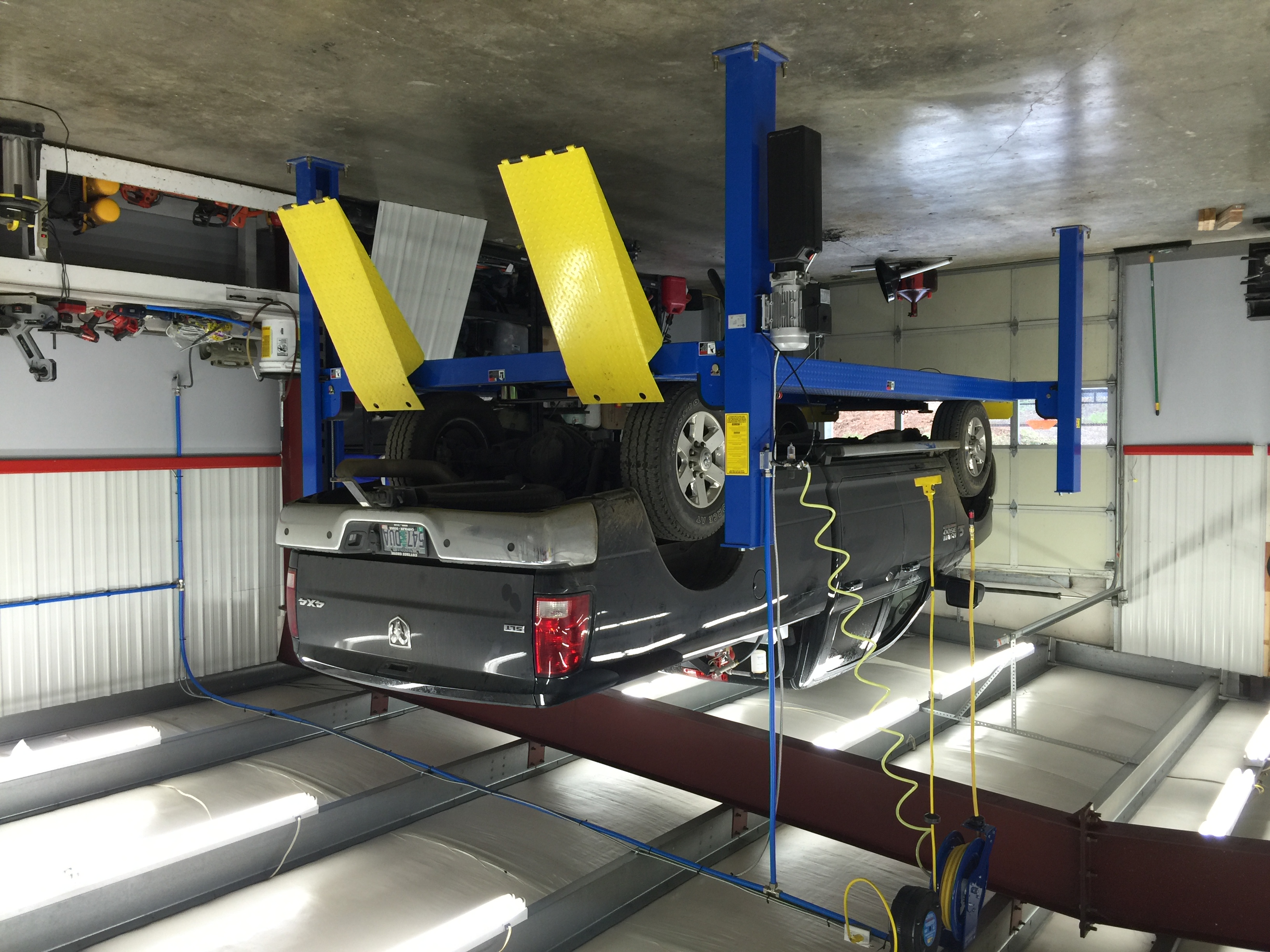

I put a Greg Smith 4 post lift in my home shop a while back. It's rated to hold 14,000lbs. It's been great and I use it on a regular basis. There are times that a 2 post would be nice and I went back and forth when deciding which style to buy. In the end I think this was the correct choice. I've put my tractors on it as well as my small dozer. These would not fit on a 2 post very well. No matter what you get you'll enjoy getting off of the floor!
what is that blue pipe/tubing that appears to be a air line ? I need to run some air line myself
Yep, that is 3/4 Rapidair. Super easy to install and so far I haven’t had any issues.
