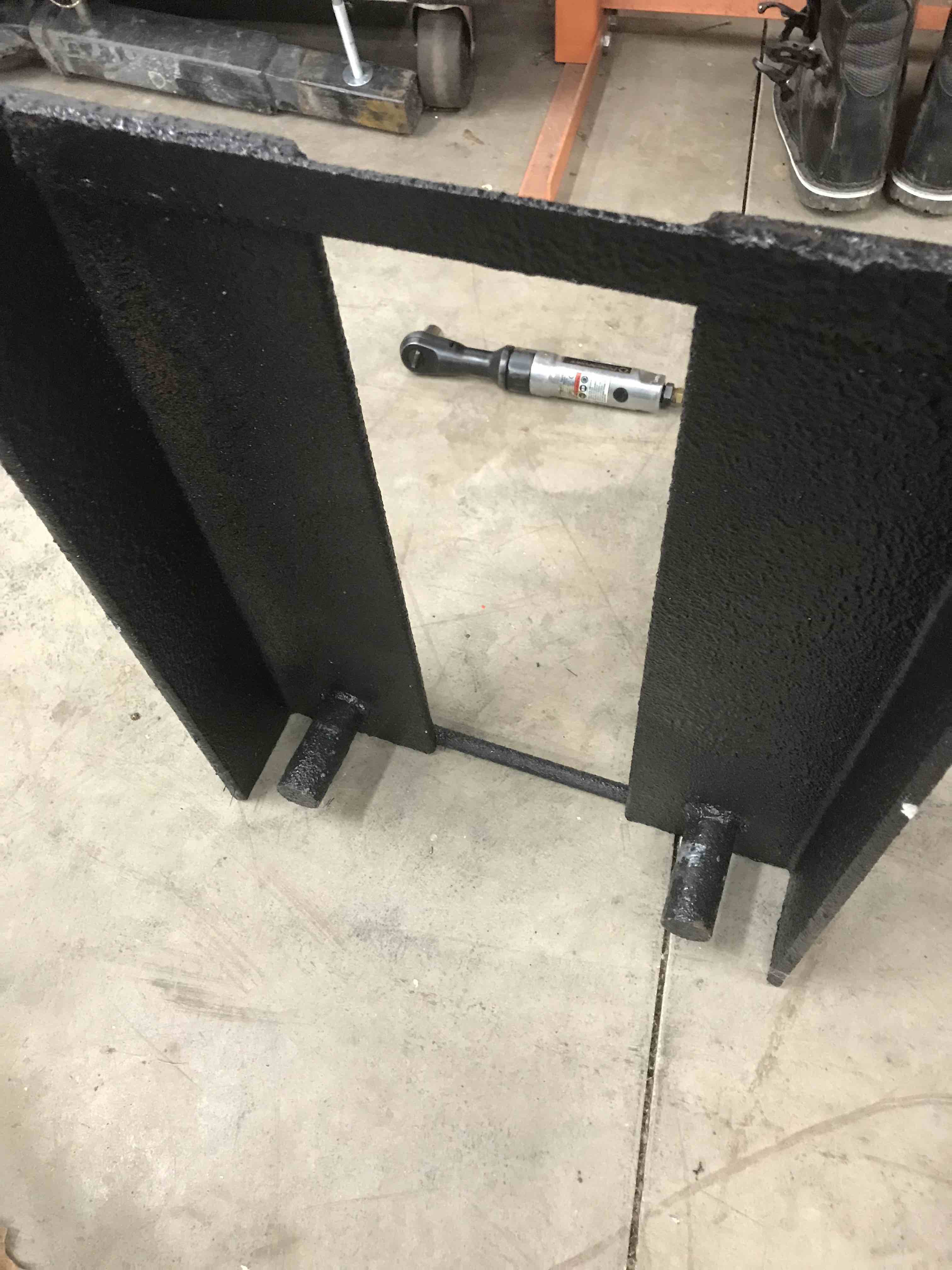

I find I use my lift for all kinds of odd things. I built a sort of table that pins to the lift arms and it works great for my motorcycle and small eqpt. The manufacture says it safe for up to 1500lbs on one post so that is plenty for smaller engines and small attachments. Makes it nice to have things at the perfect height when working.
Got any pictures of that motorcycle lift table? Been wanting to do something like that for a while.

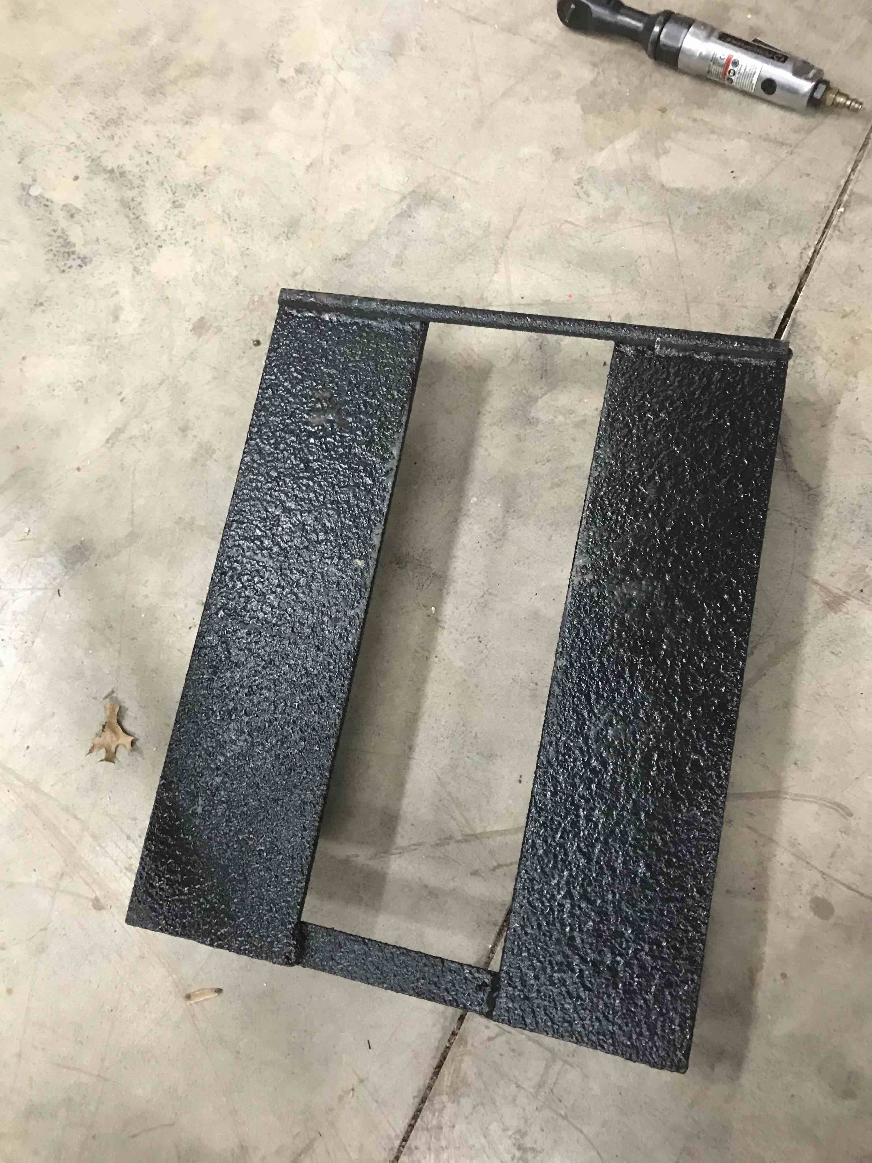

The table is a piece of ¼ steel with 4 round posts welded to the bottom that locks into the lift arms (VERY simple but also heavy to move and such)
The motor cycle lift attachment is home built and I don't have a photo but will get one for you this weekend.

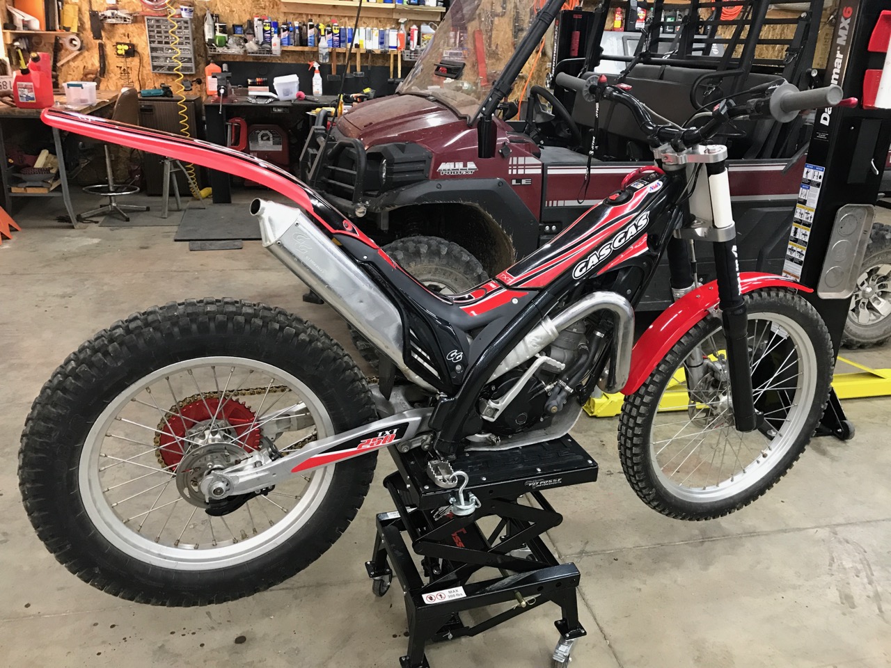

I also use this type motorcycle stand for my bike a lot. It is only rated to something like 300lbs but for mine that is fine. Handy in that it has wheels, goes up something like 30 inch and has mounts that I use a hook and lock the motorcycle to it so it can't move.

I also have a 1.0 K lb. portable bike lift similar to what you are have. I ride a Valkyrie Power Cruiser and it's a bit heavier than the bike you're showing. I had a motorcycle lift table (air over hydraulic) and it was a wonderful tool except for one thing. If not in use for the bike, it was simply taking up valuable floor space. When I finally realized it had become a storage table, I sold it. I don't have room for things that aren't multi-functional or, easily stored.

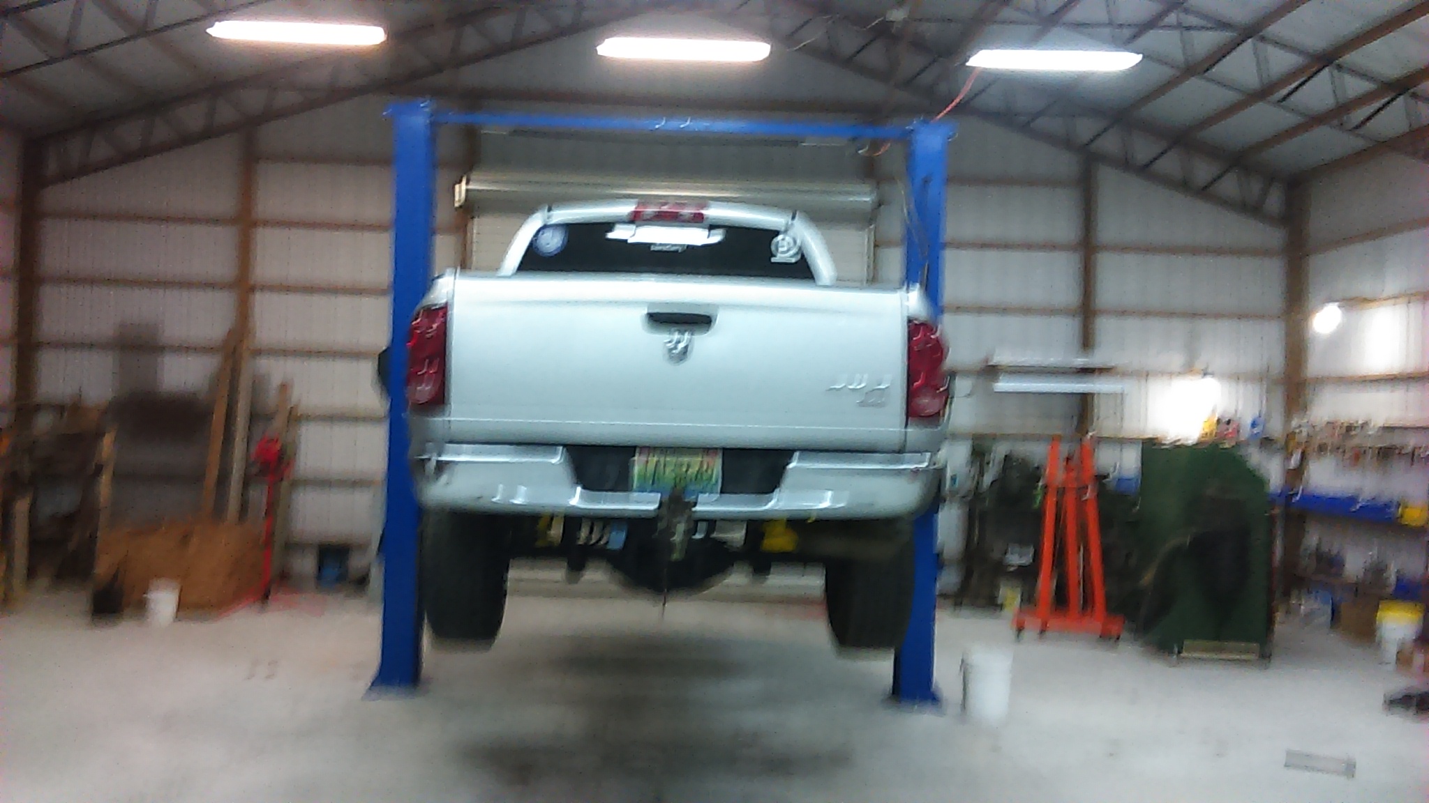

lift installed today.. This is going to be nice !

Congrats - looks good!

Sorry it took a bit - forgot to post the photos yesterday....
Very simple but works well. Shot it with bed liner so the bike does not slid around on it and is easily to clean up.
