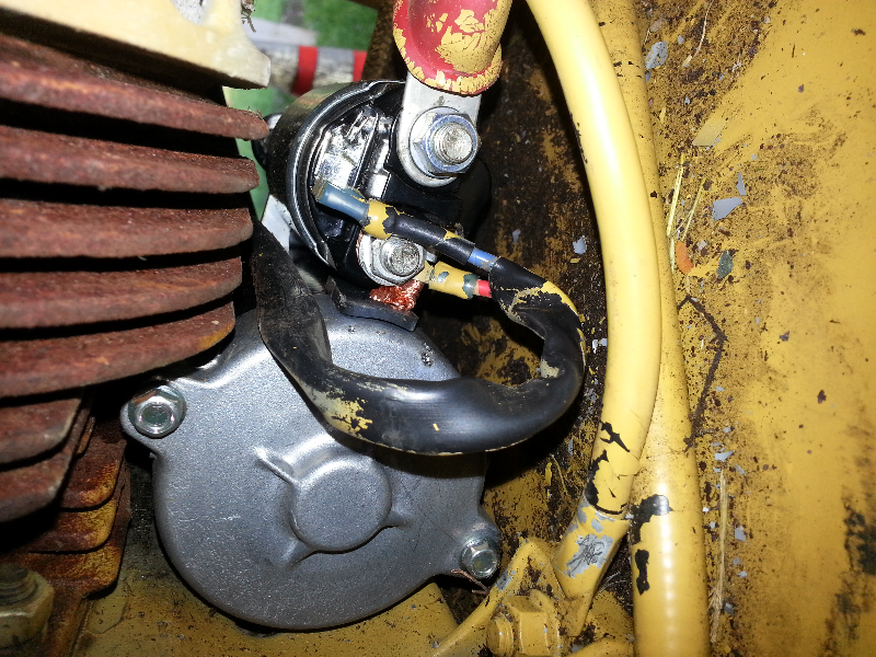

Here is what I am tslking about. The left red wire runs up to the key switch.
I blame the forumrunner software if the is sideways.there are no options to rotate. :(
There should be a wire from the battery under the red wire terminal.
The red wire supplies 12v to the switch, maybe through a fuse. Check and see if there is 12v at the B+ terminal, this is a must. When you turn the switch to the spring loaded start position, you provide 12 volts to the blue terminal.
The blue wire is the start wire and caused the solenoid to energize.
I don't believe you have told us that you have 12v on the red wire to the switch plug or switch terminal.

I did not have 12v to the red wire at the switch but that was corrected when I moved it from the starter side post on the solenoid to the battery side post. all is well now. thanks for your responses!

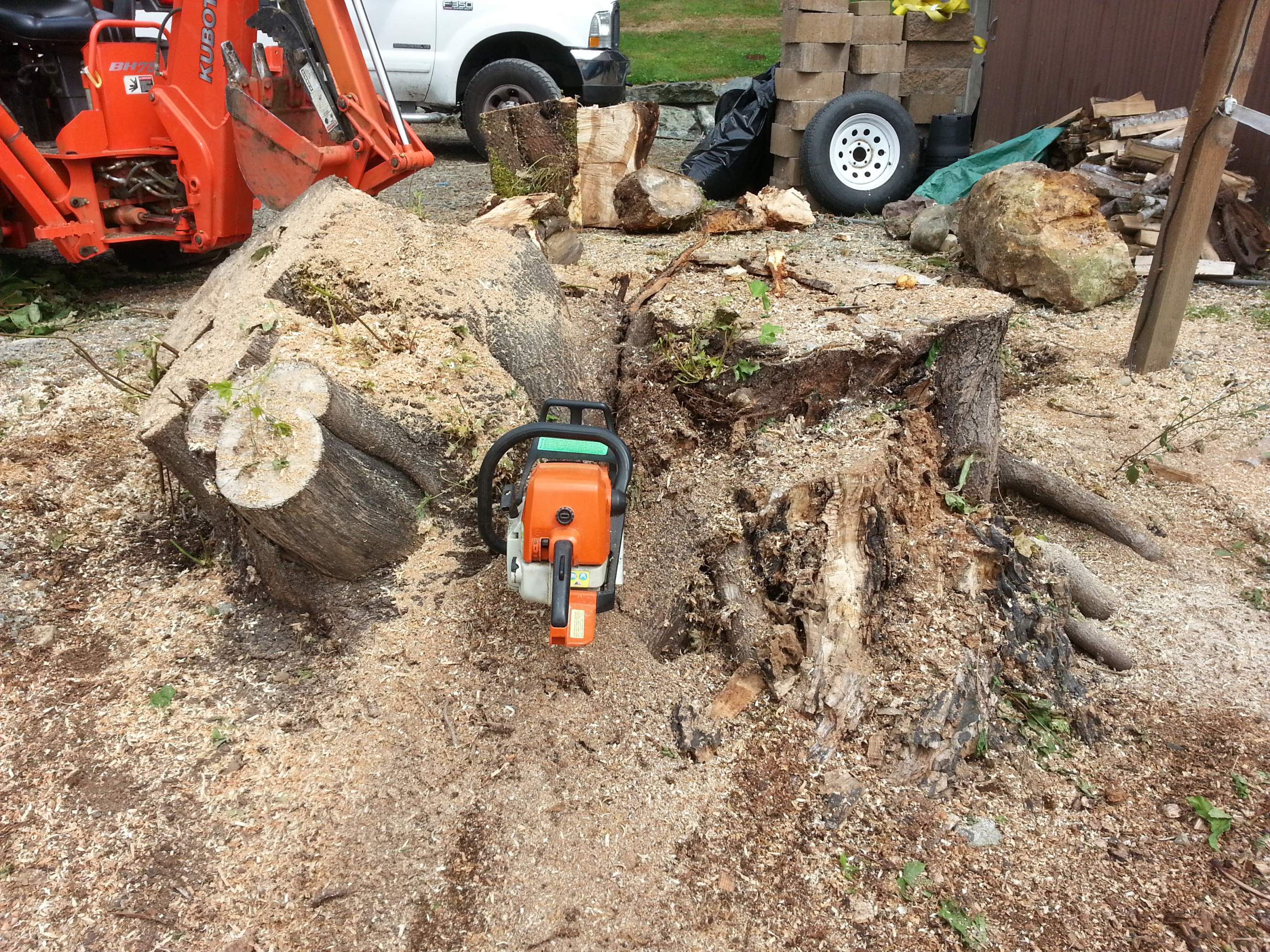

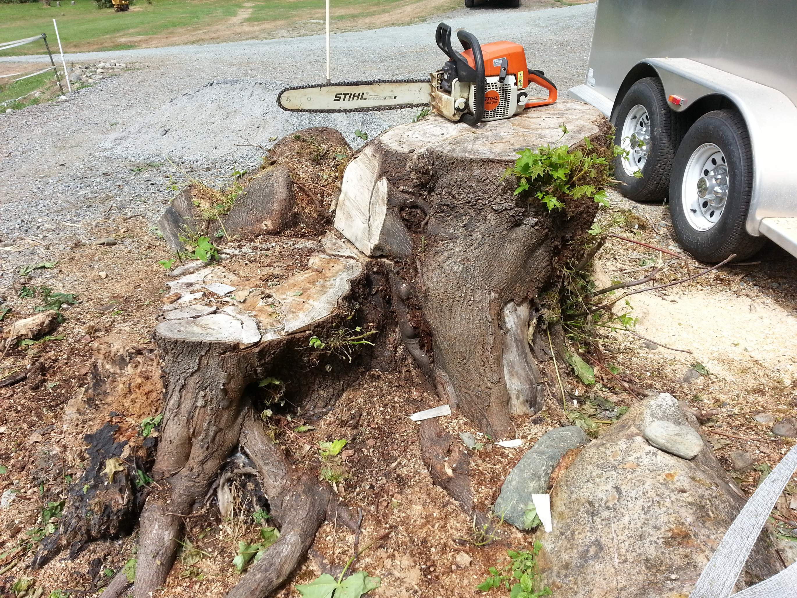

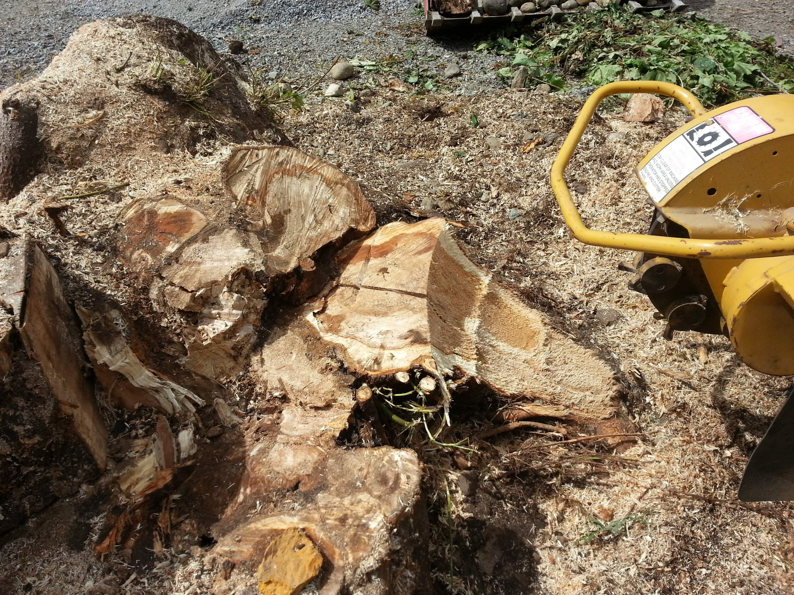

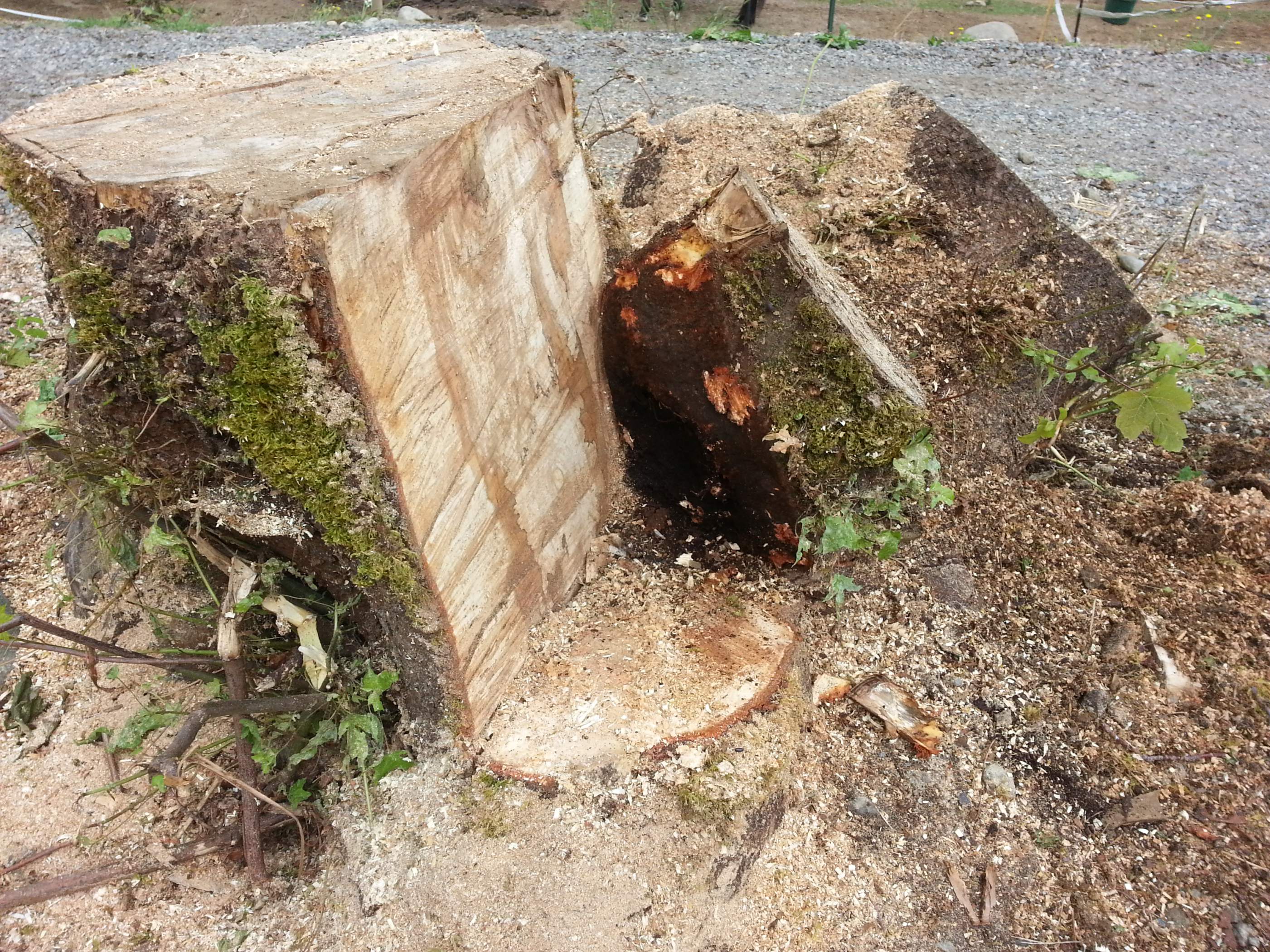

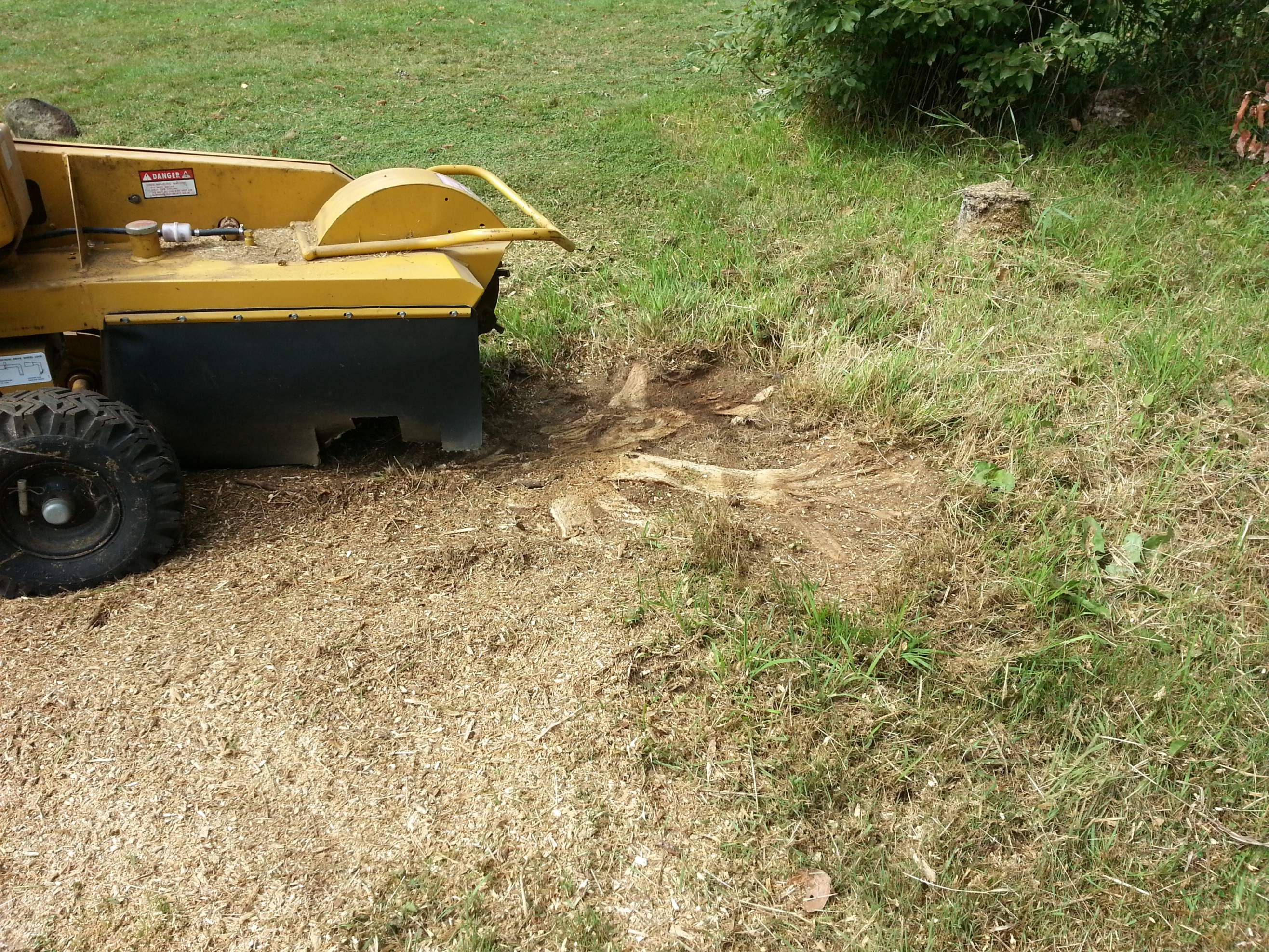

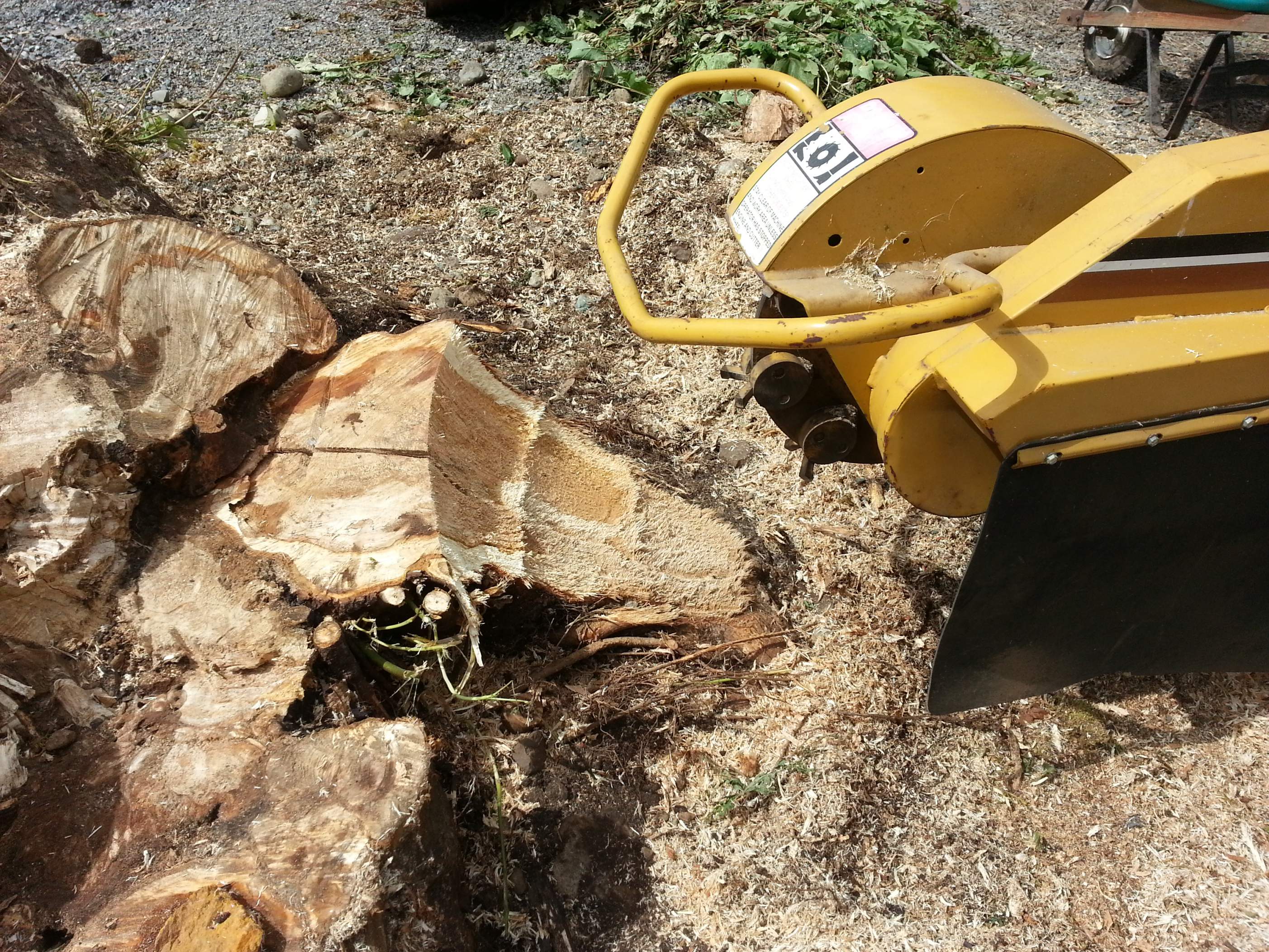

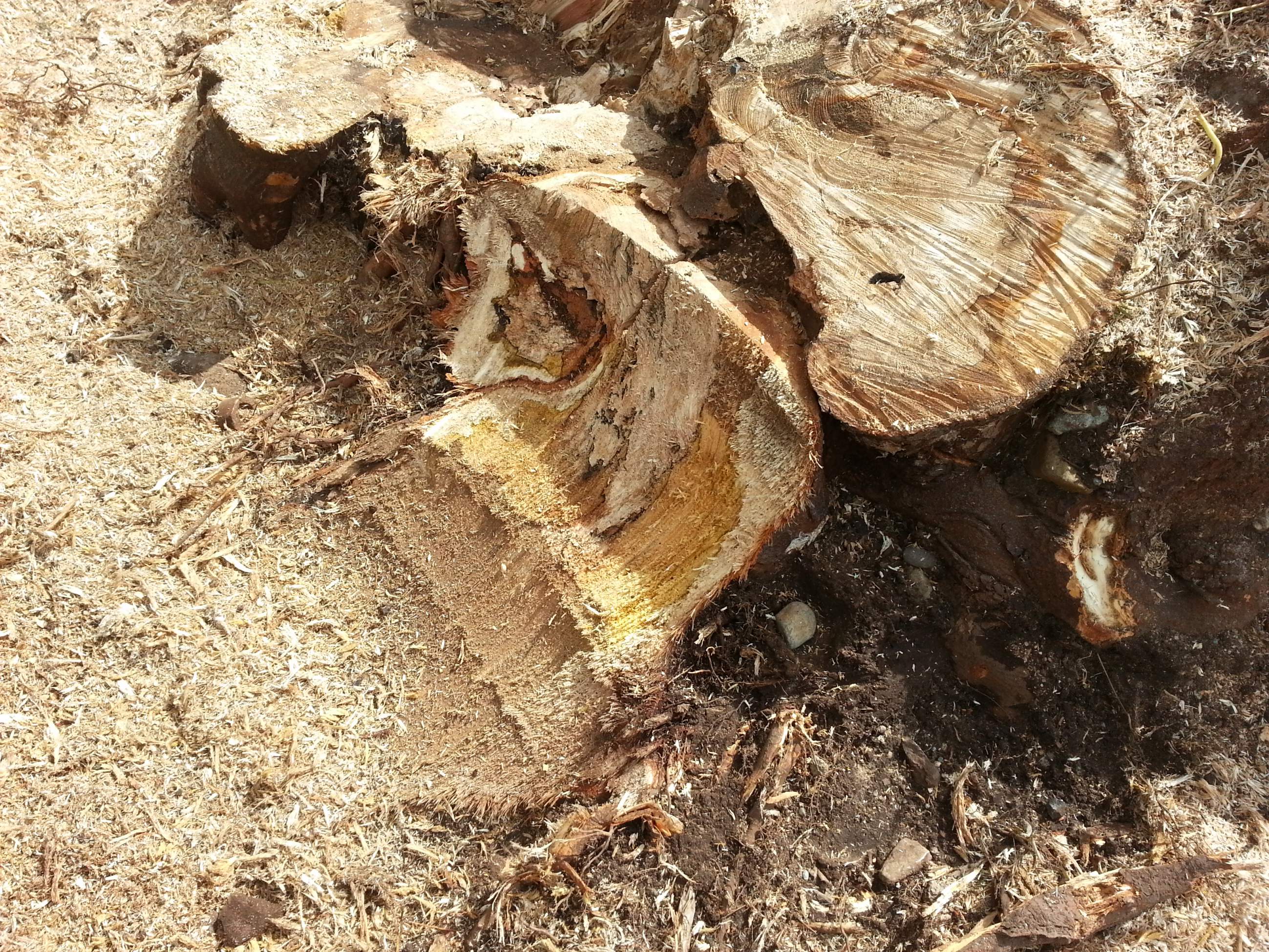

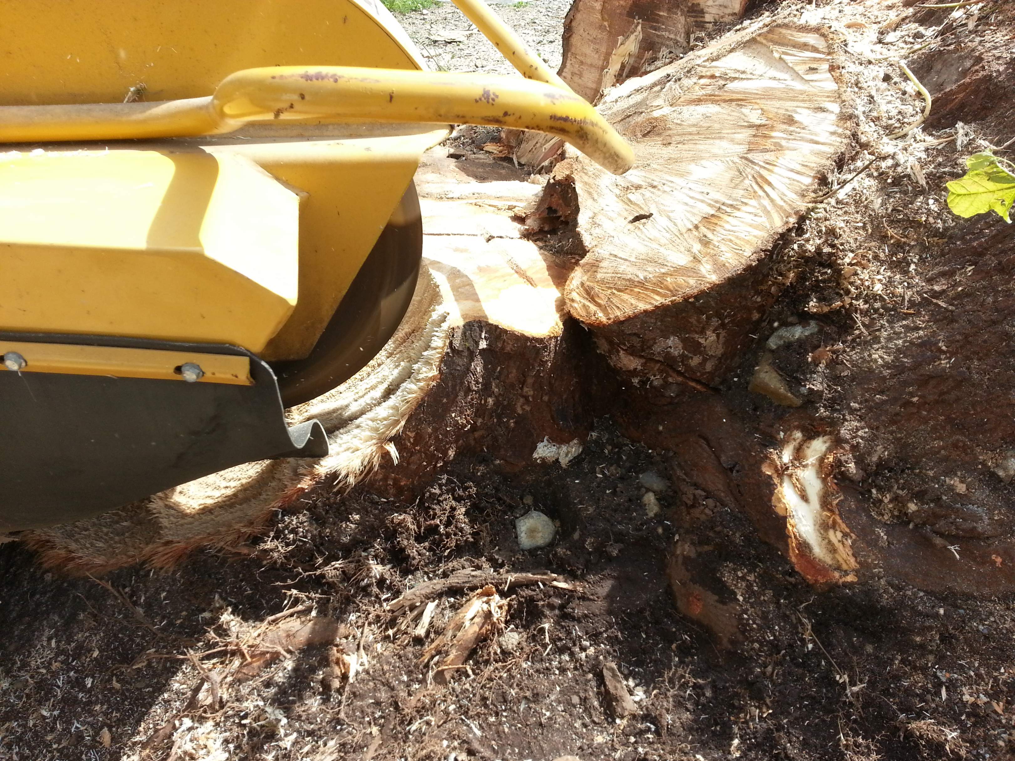

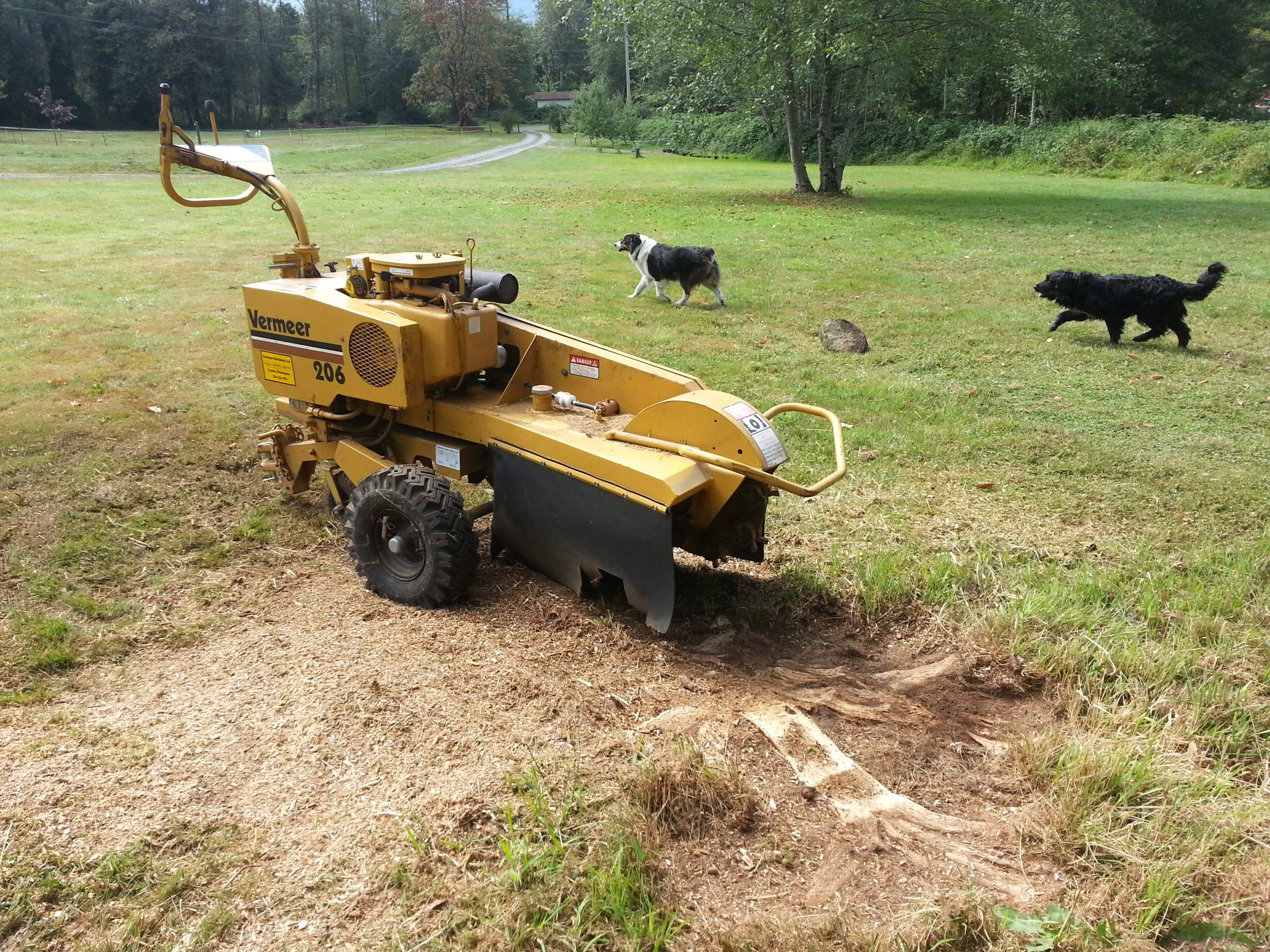

ok we're up and running and I started in on the big maple after getting used to it on a smaller alder stump.. so far it's going well it's amazing how much shaving result from the grinding. I decided to cut the maple down shorter to save some time on grinding here are some pictures, at this rate it might take a couple days to get this down where I want it.. :)

Good pics! From what I remember, dirt is NOT your friend and will dull the teeth in short order. I suggest cutting close to grade and then doing some hand work, (digging) to keep the grass/dirt small or large stones from dulling the expensive to maintain teeth. Use a broom, air compressor, or back-pack blower to try to clear wood chips, and expose & clear away hidden dirt between stalks of multipart stumps, etc.
That is one kick-&%$ machine! Way to go....
