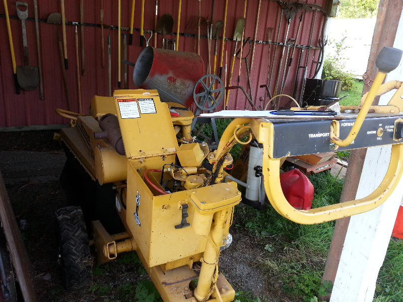

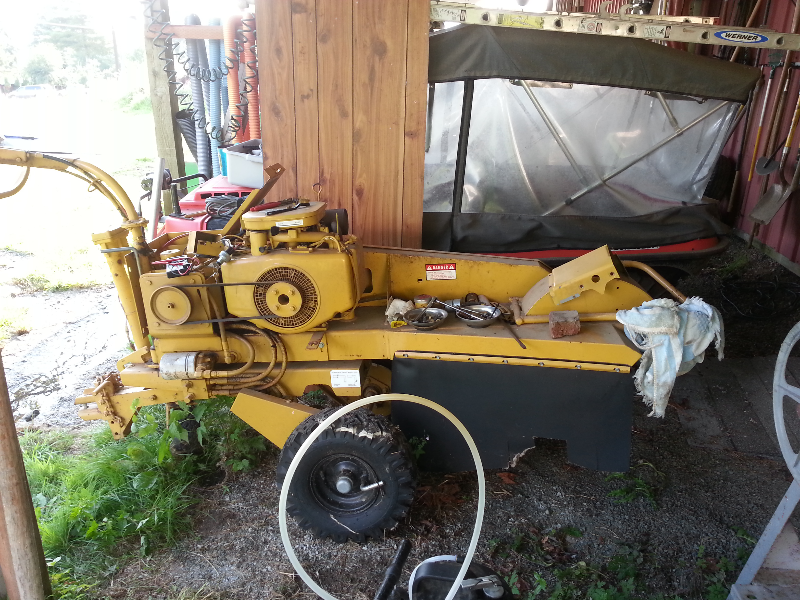

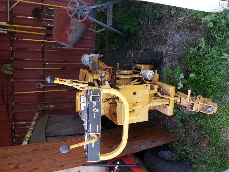

I will try this, guessing the correct spade on the ign switch is the one marked B and is a fused red lead which terminates on the solenoid.
Btw I drew out all the wiring schematic in much more detail working on getting it scanned so I can post it. And it seems like I might have the wrong "new" ign switch. Ordered one directly from kohler and will arrive tomorrow.
Here is a pic.
   / vermeer 206 stump grinder #58
Here is a pic.
Hey BB, nice pics, but maybe go back and flip the first to right side up?
And here's a thought- is it possible the machine forward/reverse/transport lever is in some position other than neutral? If so it could be locking out the ignition from working to start the machine?! Move that lever around while trying to start it....:confused3:
If not, possibly your new ig switch will do the trick!

I am not sure how to flip it, it was correct orientation on my camera, maybe a bug. you can right click and choose save as then open and rotate it..
