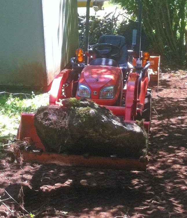

This one wouldn't lift any higher.
Bruce
