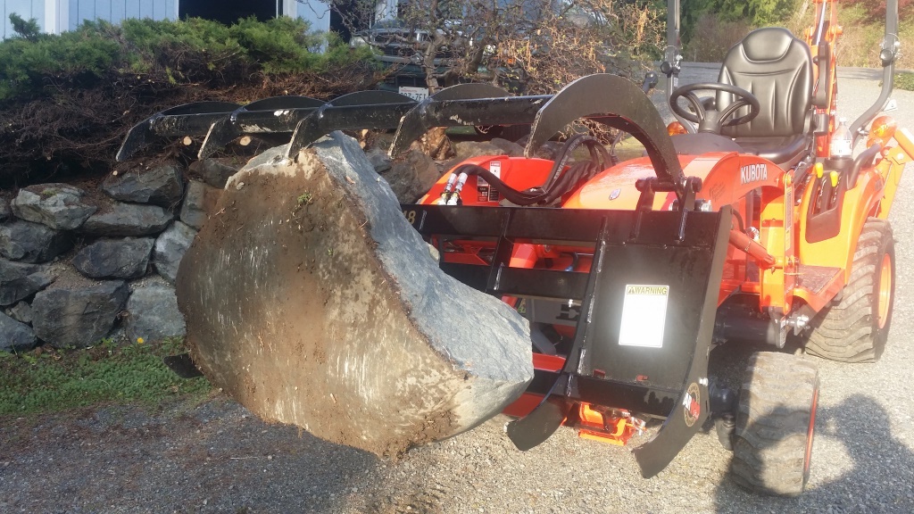

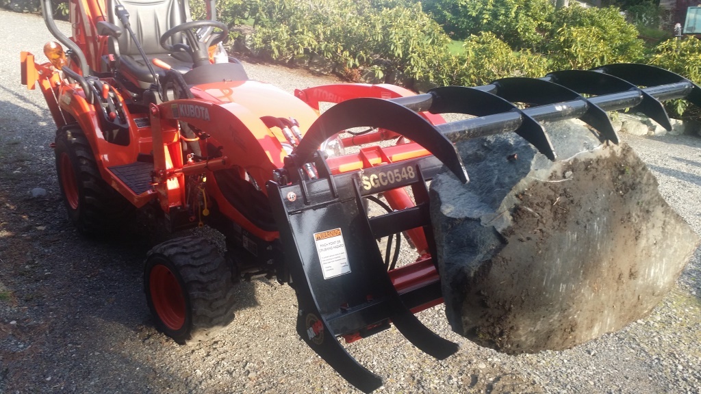

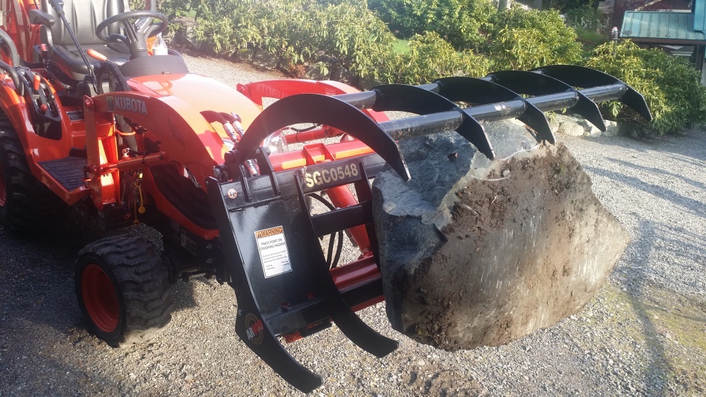

As others have said, it will have its limitations but you will find ways to work around it. I doubt you'll have any trouble lifting the rocks in your pics, but there's no way you'll grab one of those slabs of concrete with a grapple and tote it off. But you could lift it enough to wrap a chain around it and drag it somewhere that it can be broken into BX-sized chunks.
