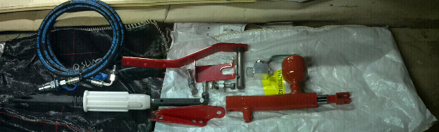

Yes, change from manual to hydraulic. As to why, my vicon is cart mounted and is hard to reach from an open station and even harder from a cab.
   / vicon pendulum spreader parts help.
#15
My parts guys talked to the Vicon salesman and made sure they had the proper part I needed. The cylinder will cost around $950 plus the cost of the hoses. Still seems high for what your getting but much better then $4k+ and my back will be a lot happier at the end of the day.
This cylinder is going on my big Vicon (has a 1 ton capacity) and I will be spreading almost 5 ton of potash through it this spring in the vineyard. There are around 250 rows and I am banding under the rows so I would have to turn around and manually start and stop this thing 250 times.

Here is everything that comes with the kit.
   / vicon pendulum spreader parts help. #18
Appears to be an accumulator on the cylinder. Guessing that's for the return stroke so it only has to use one hydraulic hose. Perhaps charged so it doesn't damage the linkage also. Or could just be used as a bladder/cushion. Can't see the top to tell if it's chargeable with nitrogen.
With the picture I can see some of the cost now. Only picture I've seen was one on the spreader and couldn't see much. Now you can work in some comfort. It'll be a nice setup.

I still haven't mounted this to the spreader yet. It didn't come with any directions as far as how it was suppose to go together so I managed to get a parts diagram from my dealer and have started putting the valve and hose together and hooked to the cylinder. Now I still need to drill a hole on the spreader for a second bolt but it should go together fast after that. If anyone is interested I will take some pics of it as I am putting it together for anyone else who may be thinking of adding this option to their Vicon.

Well its mounted finally. I had to drill one hole in the plastic shroud over the actual spreader parts and I also had to reuse the angled pivot bar as the new one had the shaft welded on the wrong side and won't work. Not a big deal since the current bar was in good shape. All thats left is to get it hooked to a tractor and make sure it actually works now. I may try that tomorrow just because I want to know before I need to use it.
I am going to post some pics since I can't find any decent pics of this option anywhere online and in my search to find some I did run across quite a few TBN threads including pictures I had posted on here before so hopefully it will help someone out.
